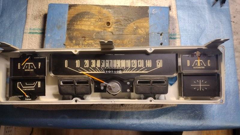

I'm looking for some help, I have this cluster in my shop for repair/ restoration it needs a front bearing which is a plastic bushing that the stem of the speedo needle goes through and keeps it centered. And yes I want this post here in this forum.
I'm told this is a common issue that the bearing breaks.
1. Is there a replacement out there anywhere that anyone knows about?
2. Does anyone make them or know someone that can or will?
3. When I'm ready to buy one I'll than post it in the parts wanted thread. At this point I'm only looking for info. Todd
I have a quick question. When this cluster is put back into the bezel, does the metal grounding strip go between the bezel and the cluster housing or on top?
Not sure of the right answer . I have that cluster on a shelf in my garage . If you can't fix this one ,let me know .
