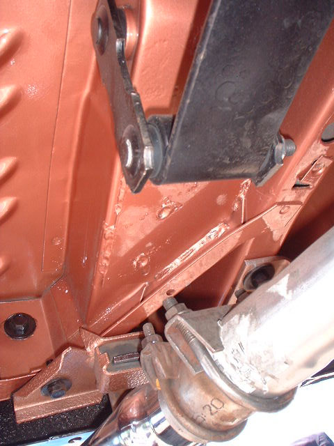

Many Mopar people are not aware that the torque boxes are not always present on the earlier Hemi cars BUT that ALL Hemi cars will have a somewhat triangular shaped brace between the unibody and the back of the rear spring bracket AND a second pinion snubber floor reinforcement plate welded over the 1st snubber plate on the floor of the car.
If they are not there someone has made some changes to this car.

Here is a piture of the spring gussett plate on Hemi cars. It is right in front of the leaf spring bracket
Thanks for the pic. I found lots of pics of those reinforcement plates and have concluded that this car is a very early rebody. Don't know the history so can't say if it was done legally thru a DMV of not.
