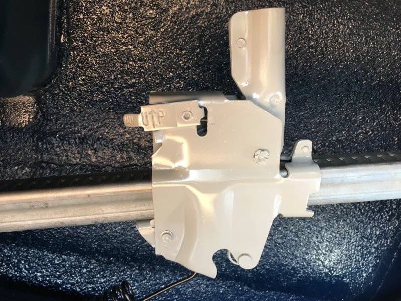

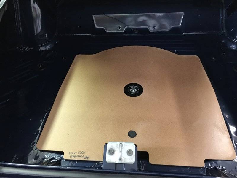

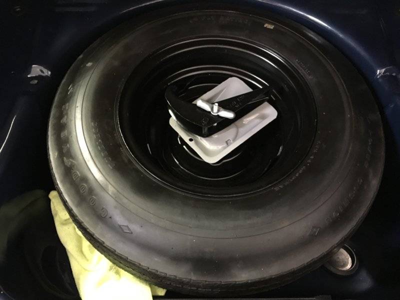

Car is still coming together. Trunk is detailed and done. Jack and all parts are correct to the car, even have a tire that's the right one, 7.75x14 WSW Goodyear Power Cushion.
Original big wing nut and bolt were cleaned up and re-zinc plated. The mast for the jack was soaked in EvapoRust and then cleaned up with steel wool.
Only issue is Legendary or their supplier wrote the part number on the hard board cover for the spare in Sharpie. Thx Legendary:wtf:

Hello, is that jack original to your car, i have one similar to with a j mark on stamped into a rivet head but hook translate to 66 baracuda valiant.
Awesome job on the restoration, love that body style!
It's supposed to be. Jacks are rather difficult to figure out in 67, no date code like later jacks.
. Yes it is thanks for help

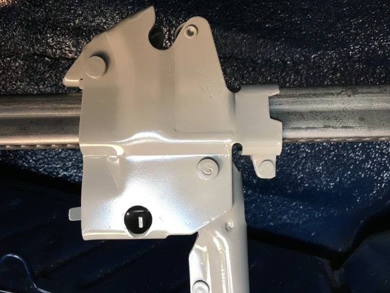

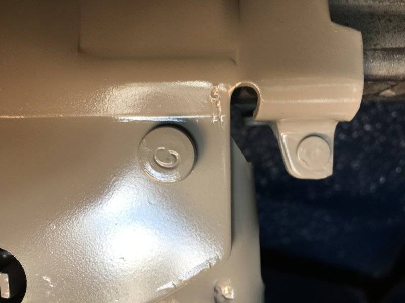

Here are some better pics of the jack. Rivet has a 'G' on it.
View attachment 670601 View attachment 670602 View attachment 670603

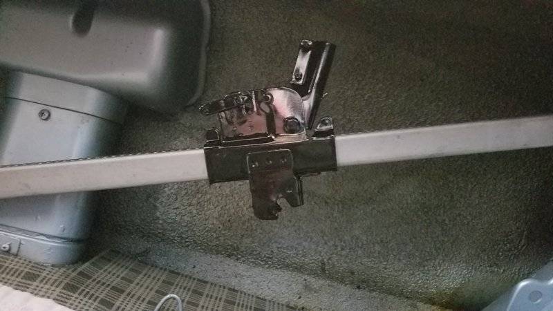

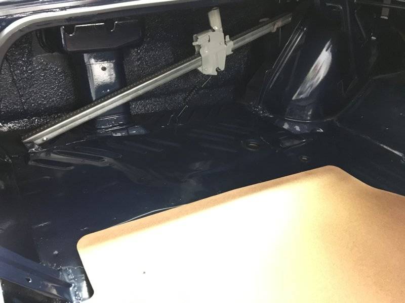

I noticed today that the jack i have when placed in the mounting slots in the trunk that you can slide it side to side almost like the jack is to narrow. My rivet marking is a j. Just another Sherlock Holmes investigation into 67 b body. I have another jack coming that is supposed to be the correct 67coronet jack assembly if interested i will let you know how that jack fits side to side in the mounting
Location in trunk.
Location in trunk.
Yeah, let me know. Its definetly not snug in the holder. The upper U channel is supposed to have a felt in the channel. Thx!
The jack i have, base and body are black in color, i also have jack that is grey in color like yours, the jacking instructions decal in the trunk matches the black in color body and base. There are two jacking instructions decal one for early and latter cars that both show image resembling the black body jack. I have seen both, i suspect mopar used both for 66 67 model year cars. Additionally i never put jack in so i never even looked closely, but today i put jack in a low and behold the original piece of felt was still up there. Both jacks have plenty of side to side movement even with the felt. Seems to me like there should have been small felt square on the bottom channel also. Hey Thanks for your help theses cars tend to be difficult to find correct information on, virtually everything is 68 up. Thanks Danny

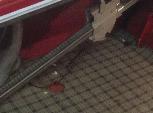

That loop on floor a spring hook to that then to jack.
