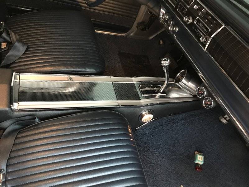

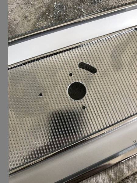

Console parts are in. Overall these are good parts, I just think they should look like jewelry for the cost. But, they are available and not like a lot of parts for this car.
I have the console tach so I had to do a little drilling. If this isn't something your comfortable with I would check with your local machine shop, they would make quick work of it.
Everything fits like the originals did. I haven't figured out how to make the rear console lid match up with the end piece. I looked at picture after picture of console cars and they all have some degree of misalignment. Good as it gets right now, if I tweak it to match the rear then the front gets all jacked up.

View attachment 717744 View attachment 717746
Looks very nice!
All the consoles fit together poorly....they were like that from day 1......When you fix one area it throws off another......
Yours actually fits very well based on the pics...
Thx. I can't figure out what part would be off. To adku
Looks very nice!
Thx. I messed around with the original one for a long time, they looked about the same. I guess the rear console mold was just tweaked a bit or something.

A lot of times it is the hinge that needs to be tweaked, bent etc.....The other two pieces are fixed with limited adjustment....than the underlying culprit is the moulded frame and it is what it is at that point...
Mine also was tight. The door would pinch in the lower corners. I ended up shaving some black plastic off the inside corner to the back metal piece so that it gave me some wiggle room to let the door open / close much better.
I thought is just mine. I spent a lot of time tweaking mine. I thought that it was because it had been roughly treated through its life. I ended up heating up the plastic console parts and clamping them to adjust them. That worked well but yours looks as straight as mine now. I think that you did a good job.

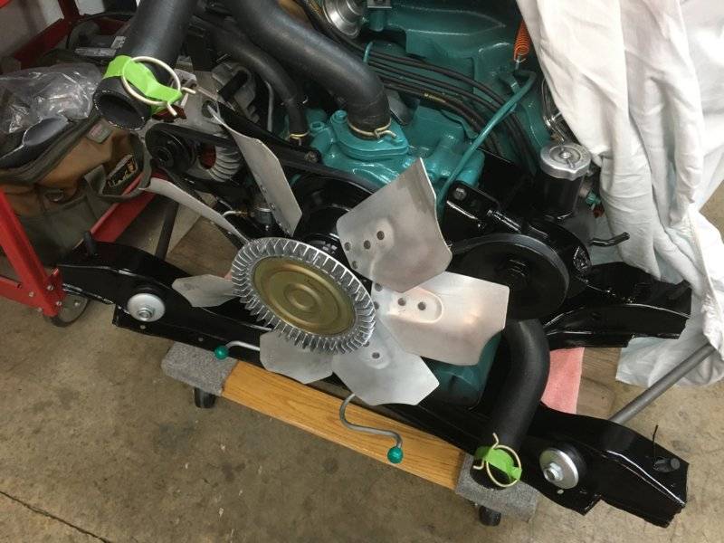

I had a couple minutes in the garage today. Over the last couple of weeks I restored the fan. This one is a steel center area painted black with natural aluminum fan blades. This is also a fan clutch setup. I had a hard time deciding what to do about the fan clutch. 1 - repaint and detail the original, 2 - find a service replacement that 'looks' close, 3 - pay $200+ for the almost correct repop. Well, I found number two after a lot of searching. This is a Carquest part from Advance a Auto for <$30 after discounts and free shipping. It looks the part, obviously not enough fins but it's aluminum in color and gold cad plated up front. For a fraction of the cost of a repop we're back in business. Belts are fresh from Rock Auto. I did the Quanta repop belts on the GTX and they were junk. They spun off at higher RPMs and I was constantly fighting with them. Late model, reliable, replacements are the route for me. Detailing on the engine is down to a PVC hose and a coil.
Would you have the part number by any chance that you used for the clutch fan?
I’m not positive but it was either from Mancini or Rock Auto.
MREBU211049 Or Hayden 2706
