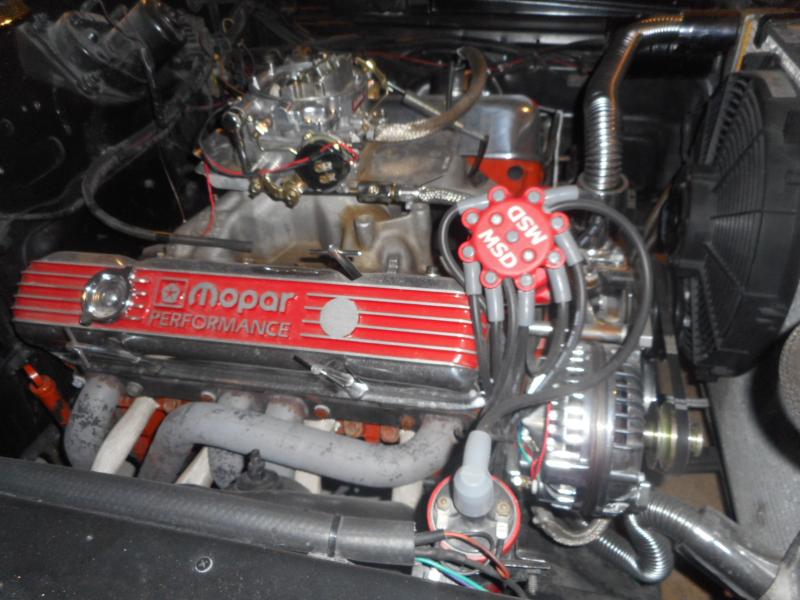

here is the mess the previous owner created
I tried installing a holley carb in case that was the problem .....but it hits the hood!!???
Aren't previous owners great?
check your fuel line Routing..
it looks fairly close to the intake,you have headers,theres a ton of underhood heat.
you could be just having Vapors....try putting a couple of wooden clothespins on the line...
i see you have it wrapped already and its on a plate but....
also,did this motor run hot before?
i see some stains but cant tell if they are gas or water..
edit,just for kicks,was this a factory r/t and if not did you upgrade the fuel lines to a bigger size??

ok...here's an update.... it was running ok....went to cruise night , and ran fine , on way home a small rattle started on passenger side. When I got home it was a little louder and had sprayed oil all over the top of engine!!
I am thinking maybe distributor seal ?? maybe engine has no pcv working??
any thoughts??
I see the passenger side valve cover is capped off. What is on the driver's side cover? Have a picture?
pcv valve but hose comes out front of carb....I am going to pull it and check
