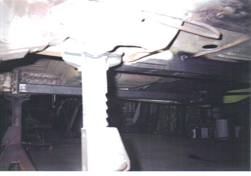

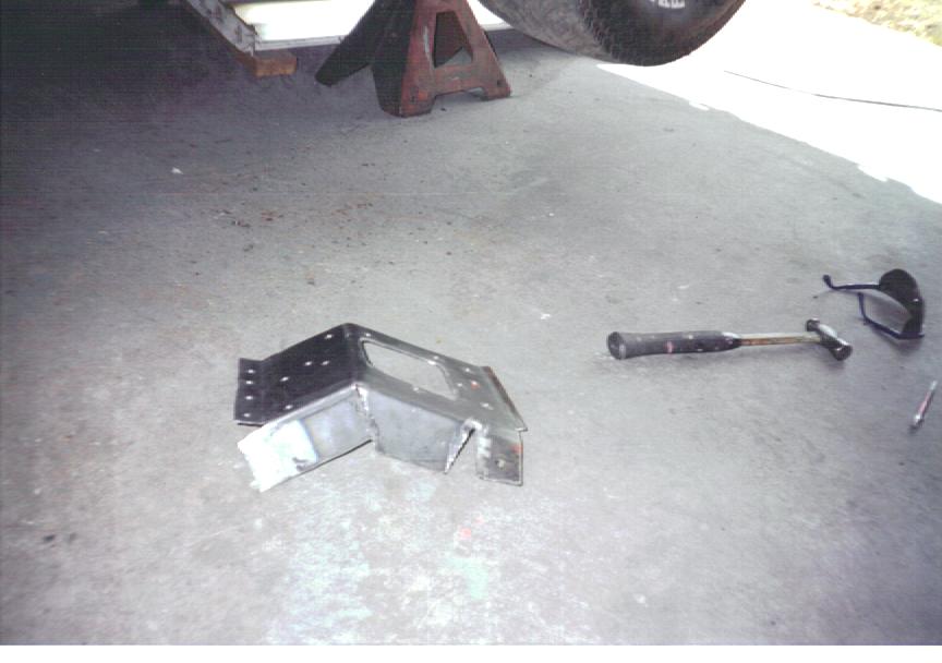

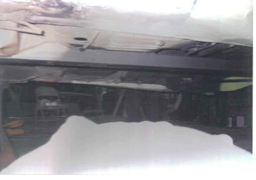

you dont have to put the torq boxes or frame connector in but I would suggest you do .
that hemi will twist the car and the factor put those torq boxes in for a reason , and everyone with big motors now put the frame connectors in .
convertibles came with torq boxes also mine where beat, so i replaced mine and put in square tube frame connectors also . now it is a solid almost full frmed car .
