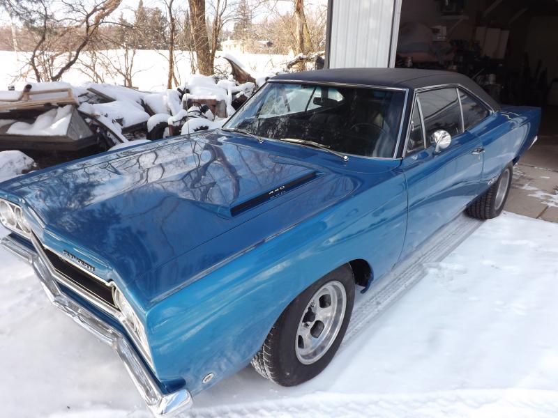

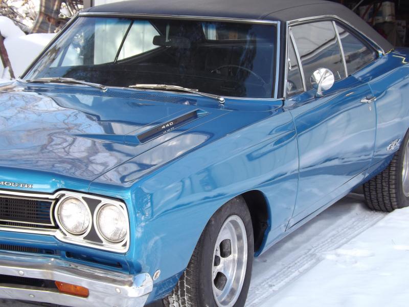

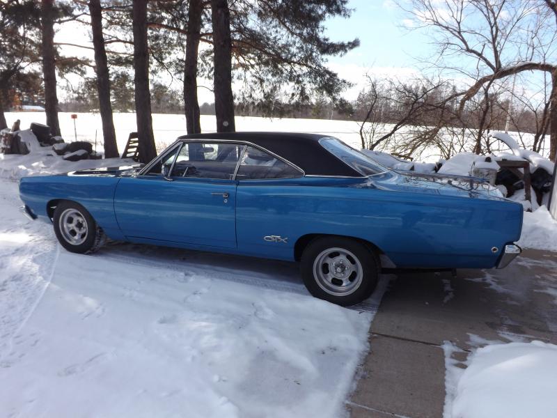

68 gtx
Since you're selling it you won't get to enjoy it much. Nice job on the car.
The car turned out great Jay. Did I see it is for sale on moparts?
Everything i own is always for sale for the right price.Always thinking about the next project.I like driving them but the thrill for me is the build and the elusive parts chasing.
Looking good. I'm working on a 69 X right now. Same color & top! I can't wait to lay some rubber and annoy the neighbors.:icon_super:
Another day of cruising it around and another big grin,think i'll be hangin on to it for a while.
Thanks guys,everytime i walk in the shop i cant just walk by i usually stop for a look.The color is sorta strange like it totally changes outside for the good.
