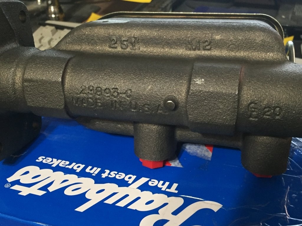

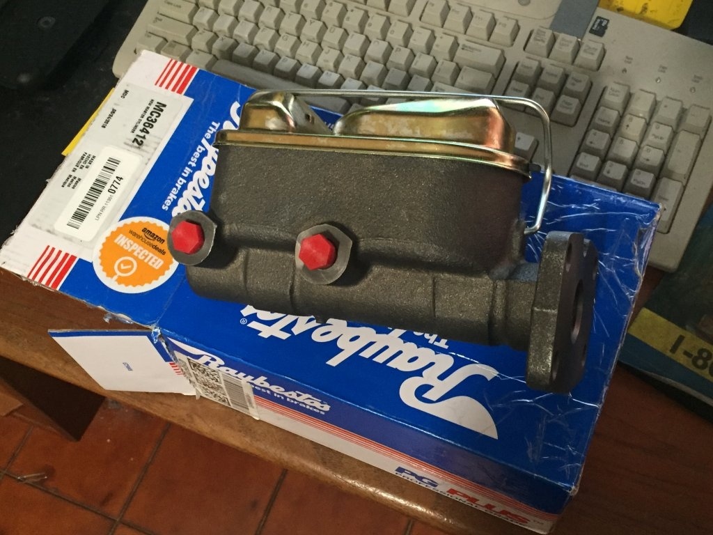

  • One Raybestos MC36412 master cylinder. This is a 1-1/32" master made for 1973-1976 A-Bodies and used one year (1977) on F-bodies. If it is what it claims to be, it does not have a residual pressure valve.
  • One pair of Brakeware 33605 (a.k.a. WAGNER F106006, DORMAN W37236 {#2620734, 3549835, 3838014}) rear brake cylinders. These are 7/8" bore rear brake cylinders, and the list in my previous post notes the eclectic collection of vehicles it was available on. And with any luck, these have expanders in them.
Everything is on its way already, though I'm taking a gamble buying a used MC36412 off Amazon for $9 and change. It's said to be new but with a few cosmetic flaws. If it's nice enough to be used - great. If it's ugly, but still functional, hopefully it'll at least get me to the point where I'll know whether this whole combination works.

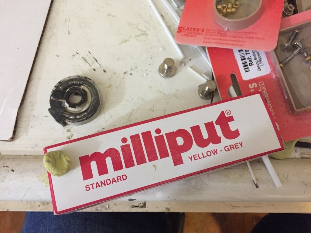

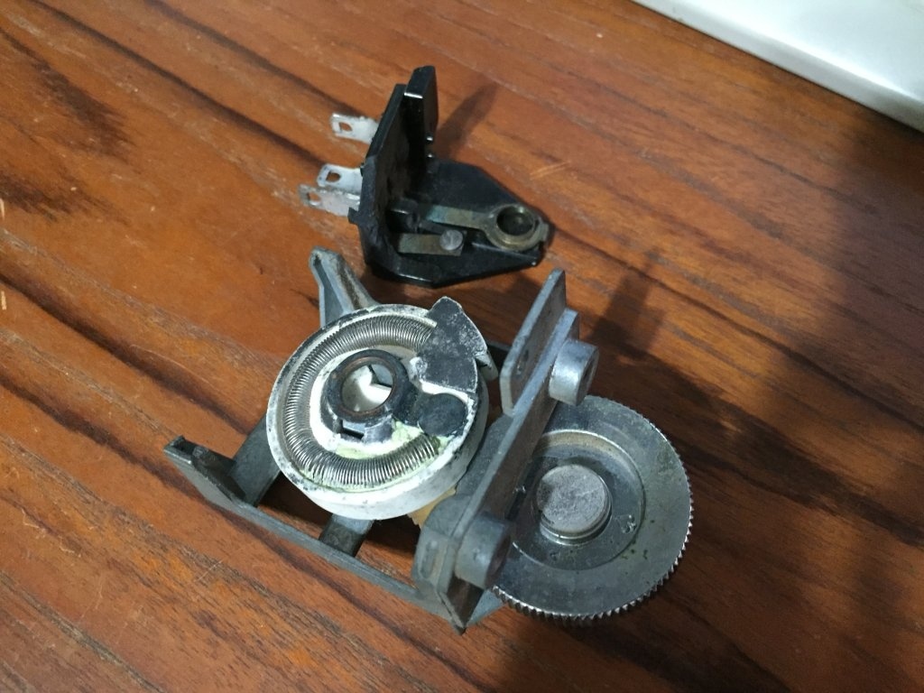

Moving on to the cracked dimmer switch. Found the putty holding the dimmer resistance rheostat crumbling up, so I stuffed Milliput in the channel to set it back where it belongs:

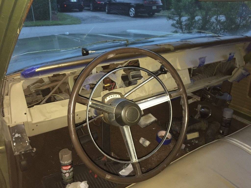

Haven't had time to futz with the dimmer switch over the week, but since the whole dash is blown apart, I took the opportunity to do the fleet wiring fix (the Mad Electrical version) and kick the amp gauge out the window (still haven't ordered the little Sunpro replacement from Amazon yet).
I made use of the rather crude hole the PO had put in the firewall for the siren wires to bypass the bulkhead. Threw in a nicer grommet and ran the wires through.
Wound up taking half the day to do it, as I soldered every connection with a non-insulated sleeve, cleaned it, wrapped it, then put heat shrink tubing around it:
Anyone who sprays clearcoat under the hood of a completely assembled car should be flogged for an hour. Still debating how I should get the clear off the bulkhead without making a disaster.
Not pretty, but functional. Purple wire got replaced too.
