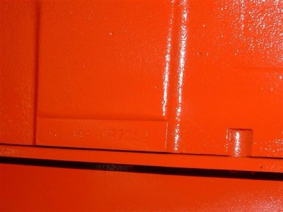

He is sending me pictures of all the numbers.
Posted via Topify using iPhone/iPad

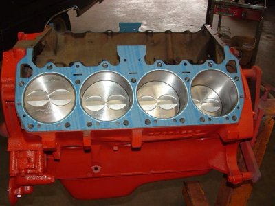

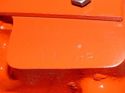

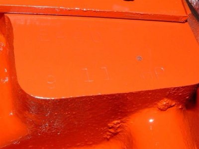

Here are some pics

I can't tell the whole VIN but a 177*** VIN and 9 11 assembly date is way too early for an A12 6bbl car.
Is that a "B" I see in the VIN? Again, wrong plant and for 6bbl car. Wrong VIN range for a B body.
Vin# WM23M9B177254
Bogus restamped VIN. WM (Super Bees) were not made at Hamtramck (B plant). 9B177**** is an A body VIN at 69 Hamtramck. It's not even for an XS29L9B Charger. M code on a block six months before they were released.
