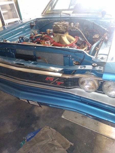

Here’s my old .030 440 with 906 heads .284 purple cam Holley 750 3.91s Hedmans headers, ran good but not much performance i think it turned a 13.2 at 10x mph could’ve benefited with a better intake and smaller carb I think.

knowing what I know now and from years of goofing up (LOL), this is what i'd do. run the ch4b and the 750 carb is ok but really won't make more power than a stock big AVS. stealth heads are probably at the bottom of the bucket when it comes to alum heads. they don't flow anywhere near advertised. i'd have somebody check them out and make sure all the parts are up to snuff, (IQ52 is a member here and could do this and he's not too far away from you). i'd use a fel-pro 8519 head gasket and compression will be around 9.2:1. the cam you listed in my opinion is a no-go. i'd take a couple of steps back. you might be surprised at the cheapo summit 6401 with the crane rockers (the true ratio will be higher than advertised) and it will work fine with cast exhaust. you'll have to carefully check rocker geometry and will probably need custom length push rods with those heads. I doubt your chevy guy has done this on a mopar; chevies are set up different. don't know what your doing for ignition but the FBO (4sec flat, owner is a member here, Don Gould) rev-limiter box package and advance control plate with a mopar distributor is a good economical package. keep in mind that stock 375hp 440's had a peak power rating at 4600rpm and peak power with this combo is probably around 5000rpm. 5000-5300rpm should be safe with this combo but I wouldn't push it!
Thanks for your wealth of info, I appreciate and respect your knowledge. I can probably return the cam set, I bought it from Summit and it's never been out of the box. The ignition I'm running is the Pertronix Igniter II with the Flame Thrower coil. Static timing is 13, total is 37 and with vacuum advance around 50.

They still sell those pistons. P/N is 350NP 30 (.030 over) cast flat tops with 1.990 compression distance. Let me clarify please....this engine is not being done. It was rebuilt by the previous owner of my car back in 2000. It's not driven much, but I got the bug to do stealthy hot rod stuff while keeping it stock looking. Thanks for all your technical advice. My skills and work space is limited, therefore I have lots to learn even though I've been into Mopar muscle since 1977. Having a hot rod and apartment living is kind of a rough combo.
