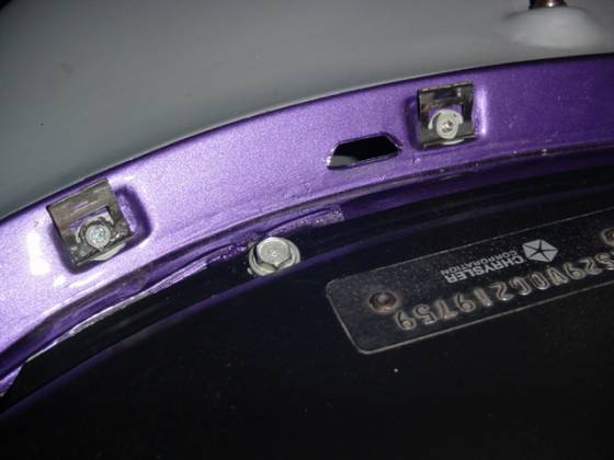

From the factory, and most important, there was a bead of non hardening sealer ,just across the bottom & about 3 inches up the posts. This was done because the rubber gasket didn`t fold over a pinch weld like the sides & top. This was put on the very inner edge ,so as not to block the "drain holes" in the cowl vent panel & and the gasket would sit in this sealer & form a water seal. Pictured is the cowl vent "drain hole" on the drivers side of my 70 Charger ,before the gasket was installed. Another big point ,anything other then original factory glass, was thinner! The lock in ,on the gasket, would be easier but that meant more of a gap, between the glass & gasket, for water to get in. I used an excellent original in mine, with an NOS gasket, so I had no issues but you could try a small bead of good quality silicone ,on the glass, under the gasket locking lip, before you lock it in. Make sure not to block those rectangular ish, cowl holes. Hope this was some help.
