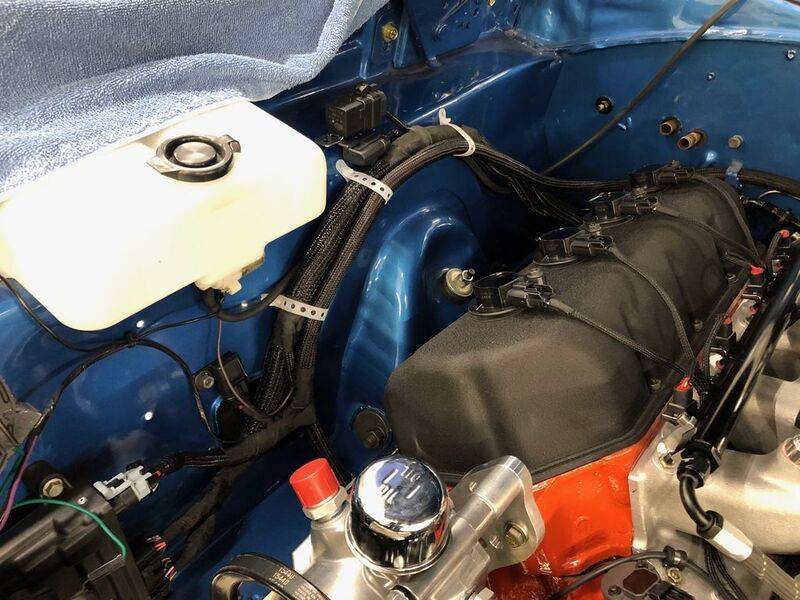

I modified the valve covers by welding the passenger breather shut and putting a stand off/oil fill on the drivers for the vacuum pump fitting.
Also drilled for bolts/threaded spacers for mounting of the ford coyote coils.

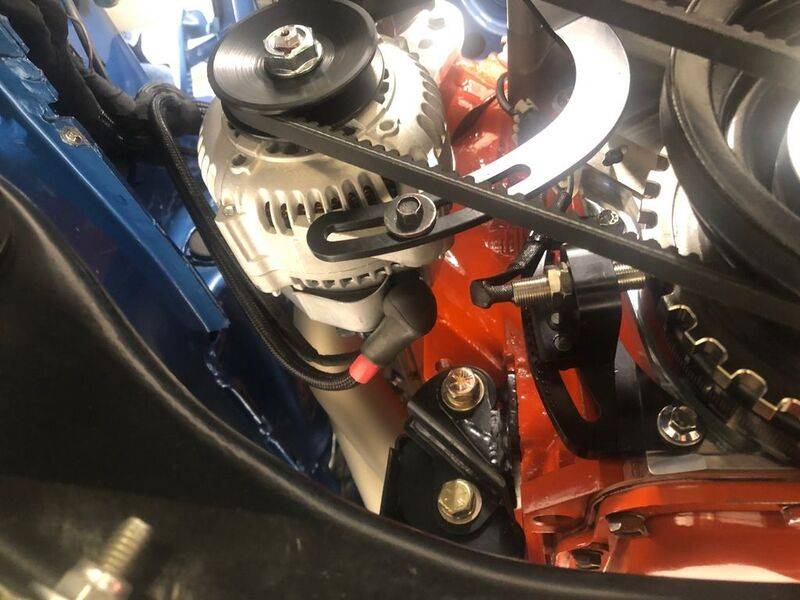

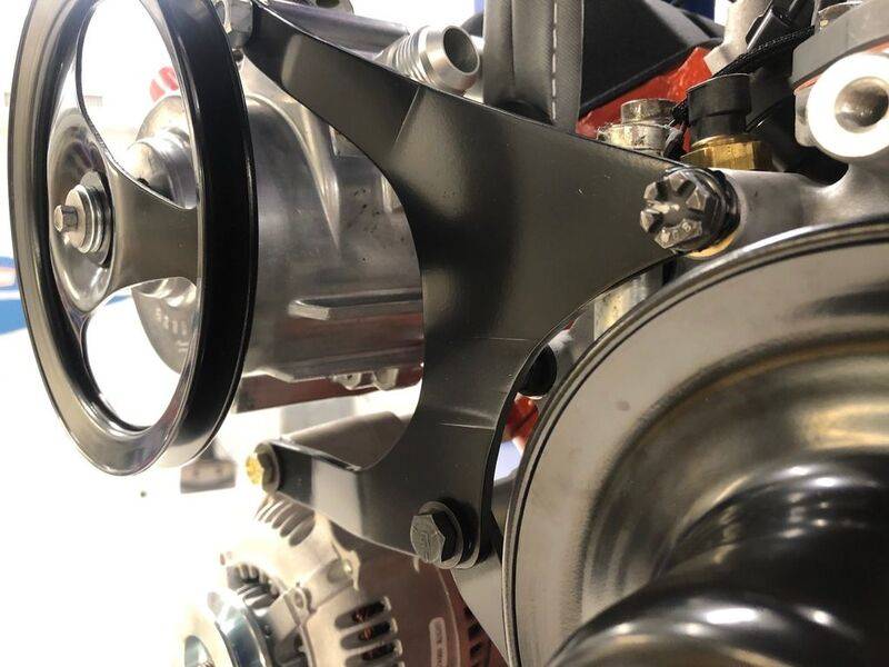

Made a support bracket for the vacuum pump and alternator.

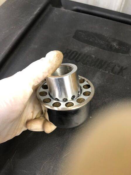

Didn't like the aluminum look of vacuum pump relief valve so now has one of the old breathers over it.

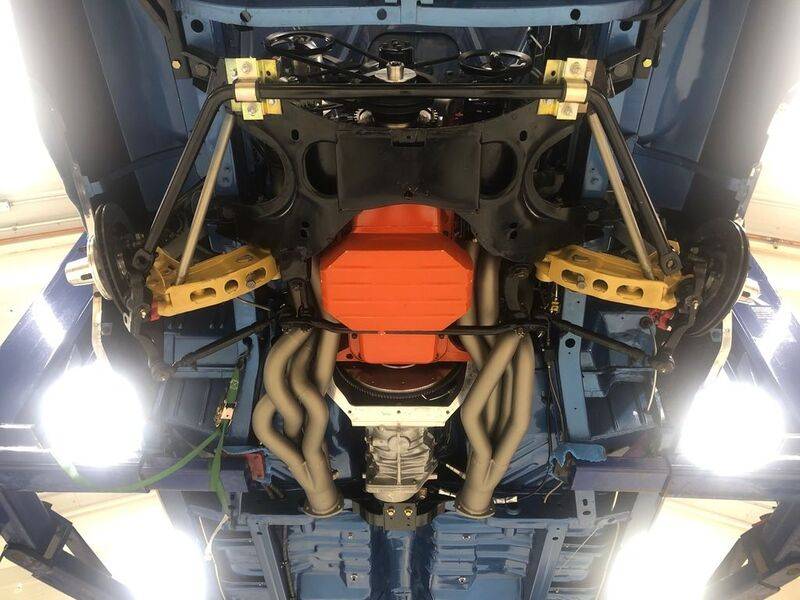

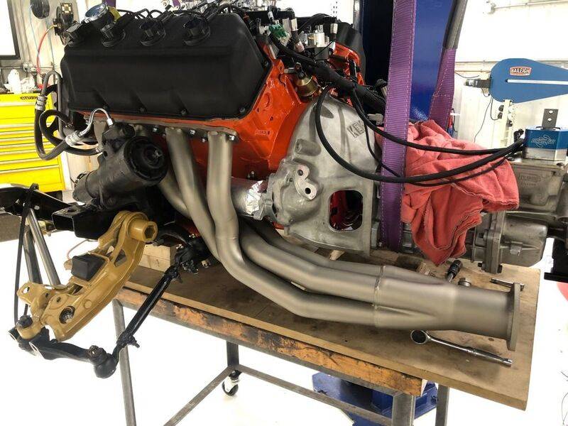

Ended up buying TTI headers, welded in o2 bungs and having them ceramic coated in "titanium" color.

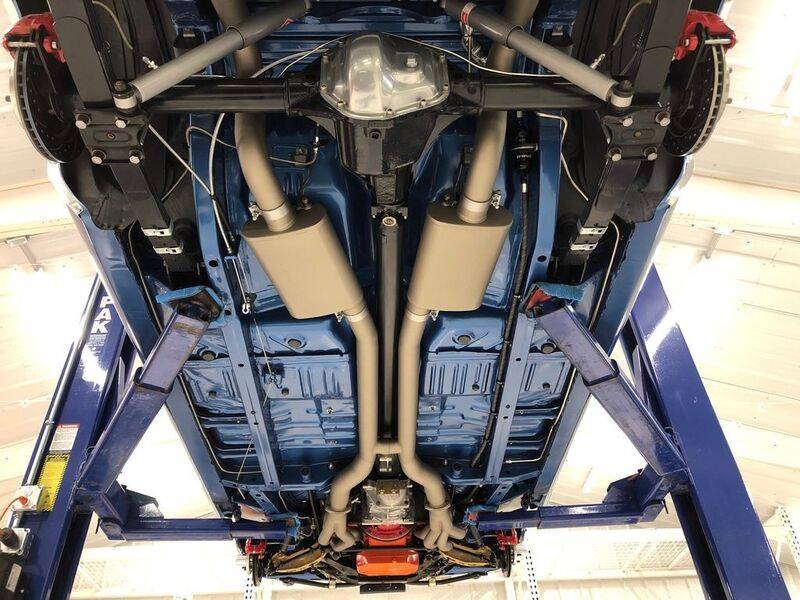

For exhaust, I bought a "stainless" system from ebay a while back. It's not stainless and not entirely sure it was made for this car. Had to cut up every part of it to make it fit. Used some 3.5in bends from the headers, reduced to dual 3in near the crossover. Pypes "race pro" mufflers (which despite their name I find to be quiet), and stock style tips from Accurate exhaust.
All coated in the same finish as the headers.

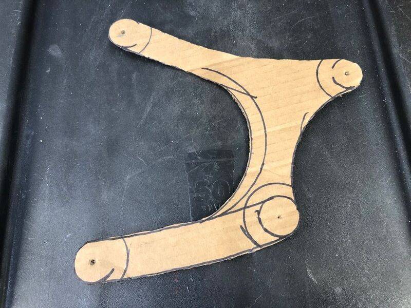

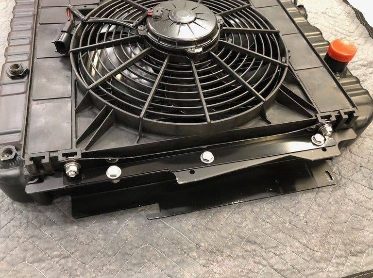

Also made some brackets to mount the Spal fans to the radiator.
