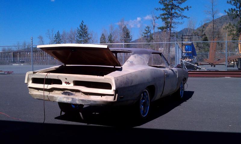

First weekend back, came home to a sunny 70 degree weekend so I rolled the Charger out into the sun to finish stripping the trunk pan.

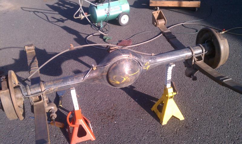

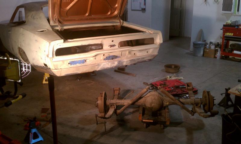

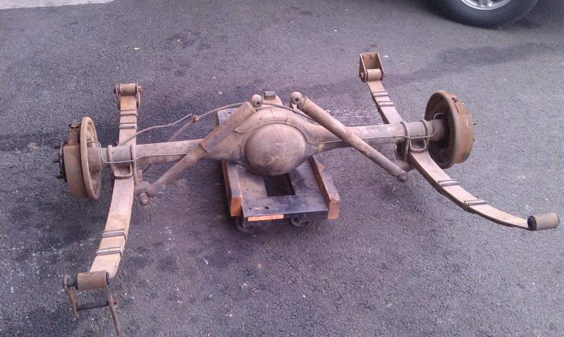

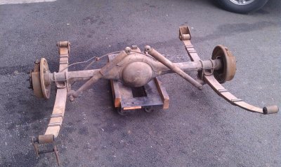

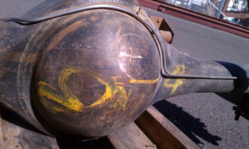

Last weekend I got an early start and had the rear end pulled out pretty easy before lunch. Ready to finish stripping/painting the underside of the car at the rear subframe, and should make the sheet metal surgery under there a hell of a lot easier too. :chain saw:
Here it is as it came out of the car. :icon_scratch:
Under the dirt I found a lot of factory markings still in great shape. I hate to paint over them but I took a ton of pictures to document them first, and didnt strip them. It's always awesome finding cool time-capsule stuff like this :icon_biggrin:

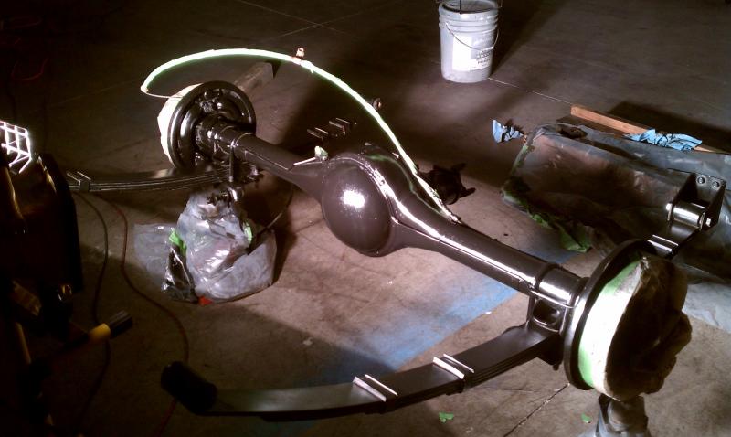

After a long day of quality time with the wire brush haha

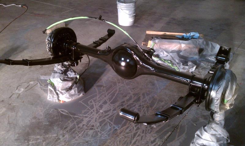

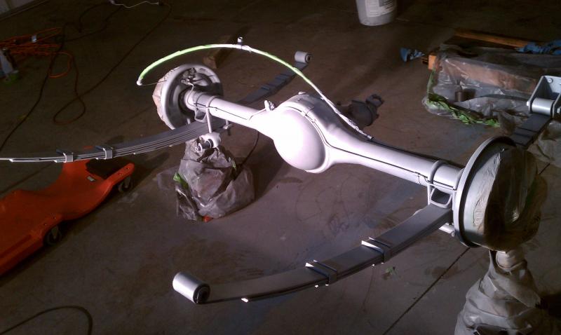

Then I shot it with Chassis Saver rust encapsulator...
... Let it cure for a day (that stuff takes forever to dry on a good day) and last night hit it with white etching primer...
... And finally topcoated it with semi-gloss black. :icon_cheers:

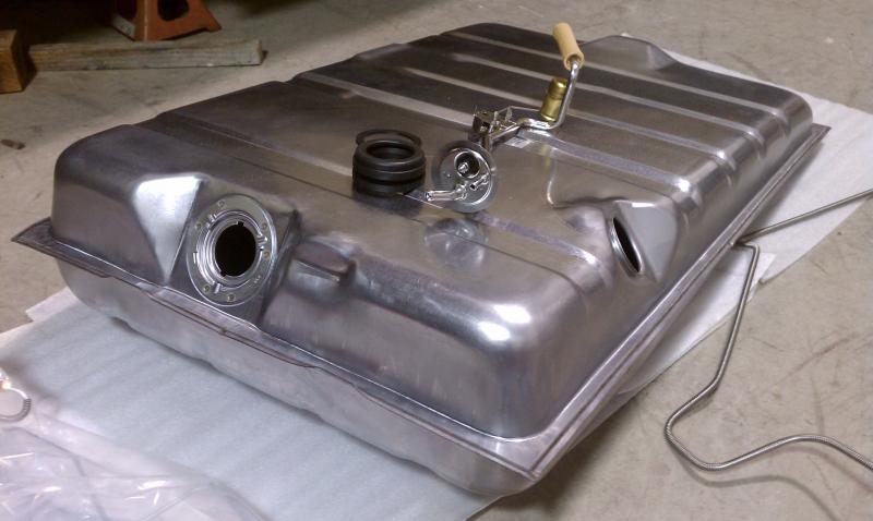

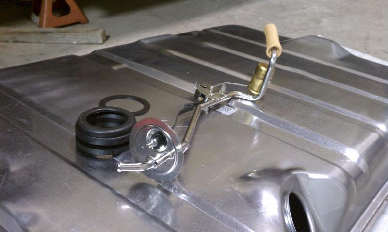

Some excellent quality work there Speed. Quick thought for you though...Regarding the sending unit...If you can re-condition it and then ops check it say with another MOPAR while it is out of your tank. you can re-use it. I did with my 1966 Plymouth Satellite project because the after market stainless replacements have been know to not operate correctly. By that I mean most will only record 1/2 tank when in fact, you are full. And, it seems no matter how much tweeking of the float arm you do, they don't work correctly. I bought a stainless steel unit to replace my original and ops checked it outside with a different Mopar and I had the same results. Plugged the old unit up and it worked but after a cleaning and inspection worked even better. Also be aware that the seal rings that are being offered today are not as think as the originals and might require a little "buttering" of RTV sealant to help seat it back onto the tank. From the pics the tank looks like it is serviceable??? If so, there is a process know as "Gas Tank Renew, that will dip and re-seal the tank which will work as good as new. Just offering you some input for your resto as we all here have gone through roughly the same things as we re-built our cars. For a young "GUN"...yep I am an Old Man...you have some really great talent. Love the pics and the status updates....cr8crshr/Tuck
Thanks cr8! The kind words and advice mean a lot. And yeah the guy I bought the sending unit from carries a couple different ones and warned me of the other one having that problem. "likes to always read 3/4 tank" was how he put it haha, but he said this one should have no problems. I'll keep that in mind and at the very least keep my original one on-hand though :icon_thumleft:
And ya know my gas tank is kind of deceiving. "Looks good from afar but far from good looking" haha When I bought it the owner had it still installed but the gas cap removed, so I have a feeling a good amount of water made it down the filler tube because it really looked pretty bad inside when I pulled it out. But who knows, I was going to keep it as well and try the restoration kit you mentioned so if it works I can have a backup laying around.

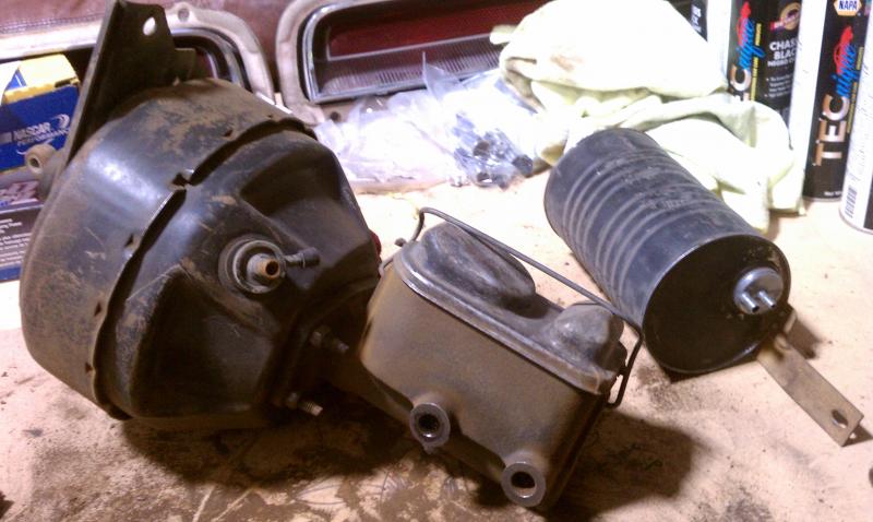

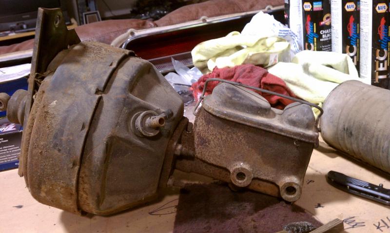

Took an easy job for tonight and started cleaning up my brake booster/ master cylinder and vacuum cannister to get them ready for some paint.
Cleaning up pretty decent.
Aside from surface rust, the rest of the assembly seems fine, even the original gasket on the backside is still cherry, so I'll be hitting it with chassis saver and paint, and install it to see how it is before I go buying another one or shipping it out to be rebuilt.

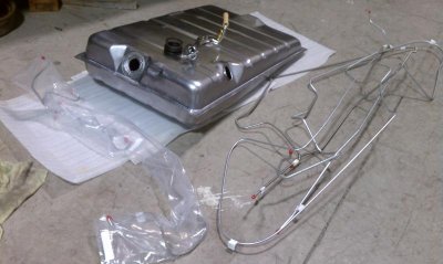

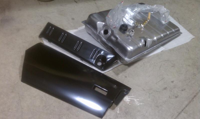

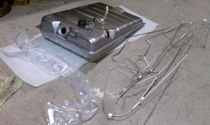

Gas tank showed up yesterday and the rest I needed for the new fuel system, pretty close to being able to install the lines.
Still waiting for sheet metal before the rear end and tank can go back in, but pretty happy with how nice the new stuff looks :headbang:

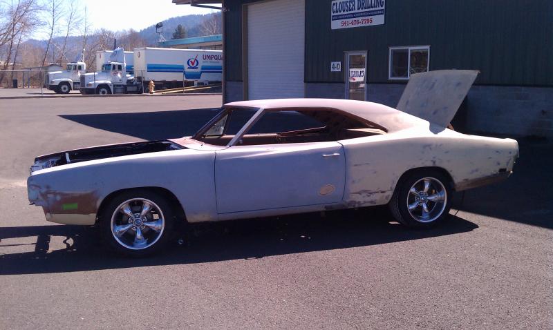

View attachment 108857Clouser well drilling !! Are you in Medford or GP ?? :laughing8:
I pass Coleman's every morning on my way to the shop.. :eek:
Mike..
PM me, I'd like to stop by and see your car :headbang:
Lol! No way! I guess it really is a small world, I'm in Grants Pass. Clouser set up shop next to me late last summer. And will do! Always cool to find fellow moparians in our neck of the woods haha
