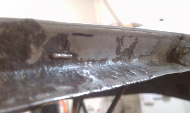

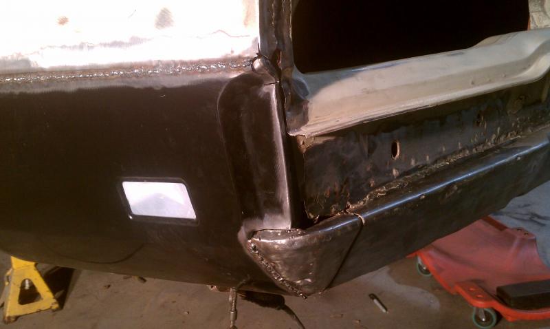

Found the ledge Charles was talking about, its just a slight lip along the edge of the roofline. (above the sharpie line in the picture) in my case I'll just form the lip with All-metal after welding. (the weld itself might even be enough to form it from)
Well sorry I've been lagging getting around to the rear window fix guys. I've just been really busy trying to get the whole rear section of the car sorted aside from that, it's been a lot more work than I thought it would be fixing the previous owners' past bodywork sins. :BangHead:

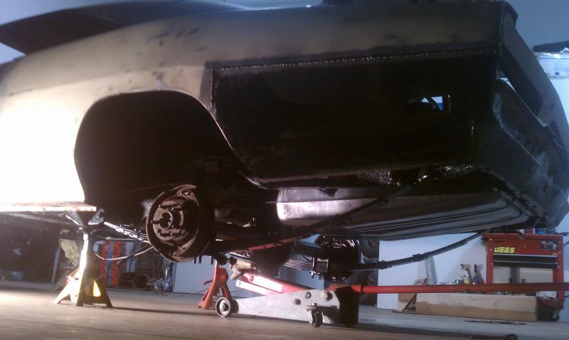

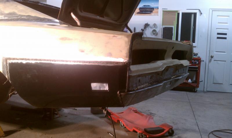

But on the bright side I've got some good progress to report, the trunk is smoothing out nicely with grinding, and I finally got my lower quarter patch welded in! Feels really good to get rid of that screwed up patch that was there before and see a nice new panel in place
:eek:ccasion14:
The corner was fun trying to get to fit, had to cut out a section of tailpanel because of all the metal welded on from the previous "repair," but with a little convincing she came together really well. I'll just make a "t" shaped patch bent down the middle to weld in and clean it up.
Hopefully now I can finish stripping and painting the rest of the undercarriage this weekend, but all in all it's a great feeling having that out of the way and seeing it all coming together.

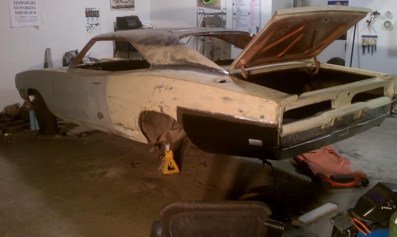

Hey guys, I've been MIA here for a little bit, but I definitely haven't been sleeping on the job and the Charger is coming together fast. Thanks to a lot of midnight oil burning I've gotten a lot done in not much time so hopefully I can keep up this pace :icon_thumleft:

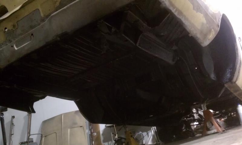

Starting from where I left off, I ended up knocking out all rest of the welding I needed to do on the back half of the car in one long night. There's still a bit to do on the outer quarters but that's getting taken care of this weekend. Stocked up on 36 grit flap wheels and went to work with some wire wheels to get the welds ground down and the rest of the undercarriage prepped and painted. It was definitely a long weekend but worth it

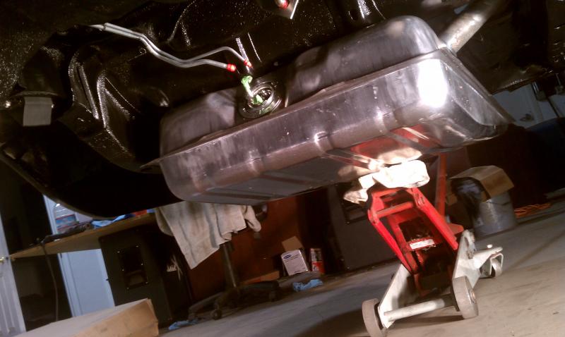

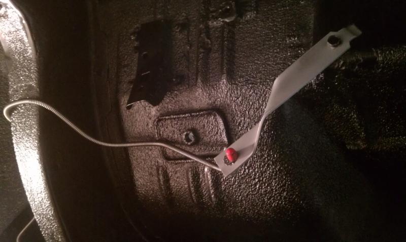

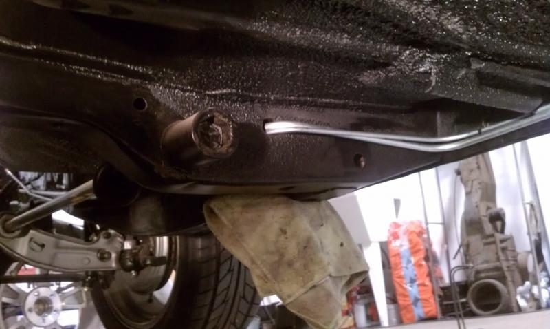

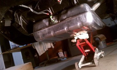

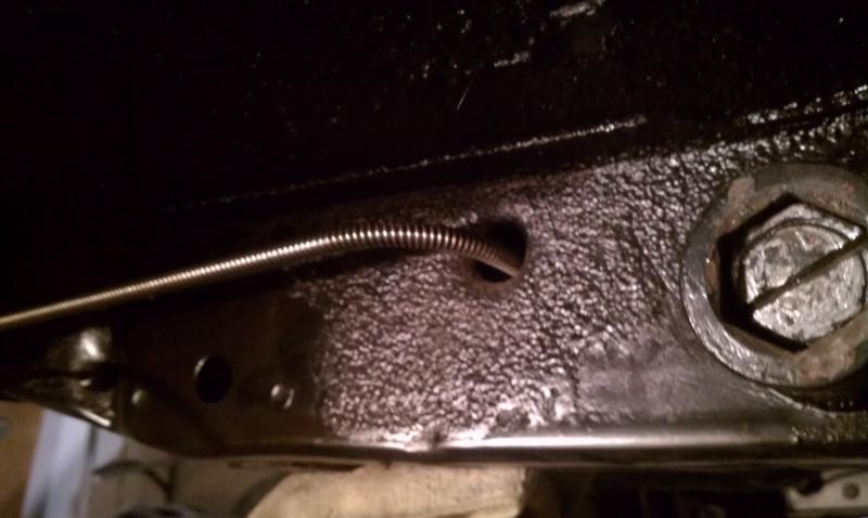

Then I pulled the old brake and fuel lines and had a fun night trying to get the new ones routed correctly. Old ones were all hacked up and patched with hoses, so it took a little time to figure out and get a nice fit but ended up fine :toothy5:

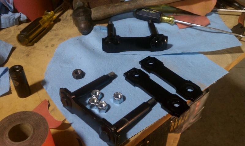

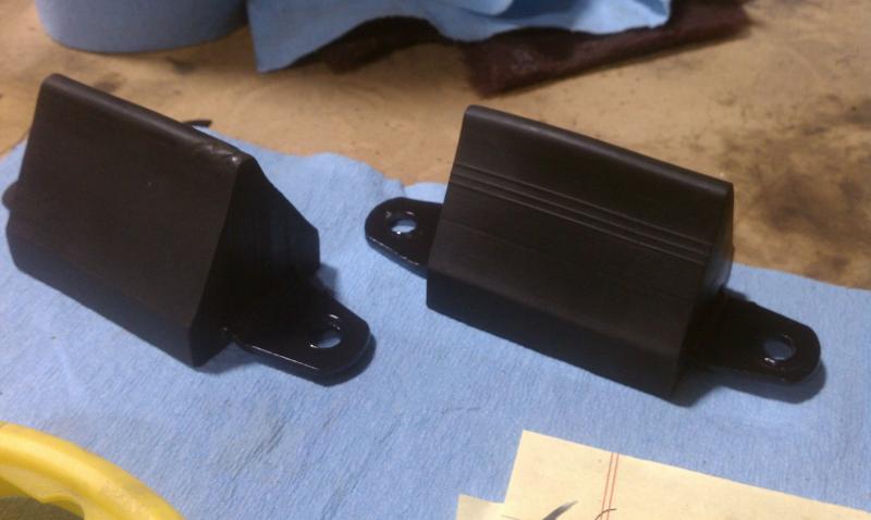

Then I spent some time sandblasting and painting the spring hangers and odds and ends for everything under the car. Also painted the brake line brackets in "alluminum" finish paint and satin clear just to have some contrast and detail.

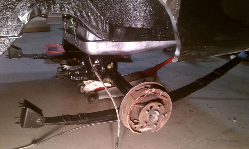

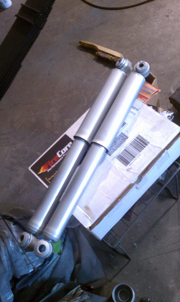

Painted my original shocks just for the meantime until I get the QA1 rear shocks

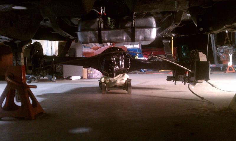

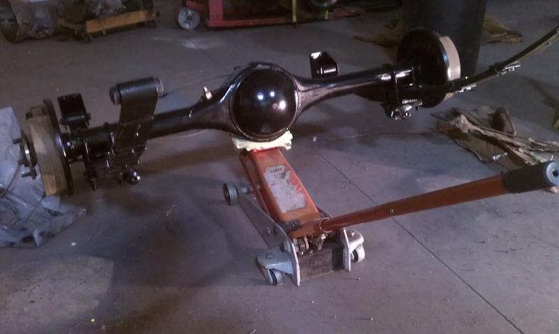

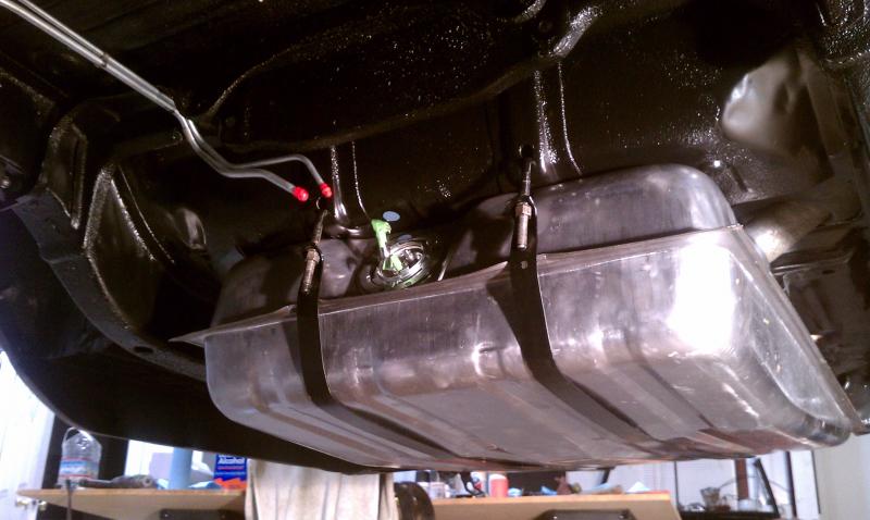

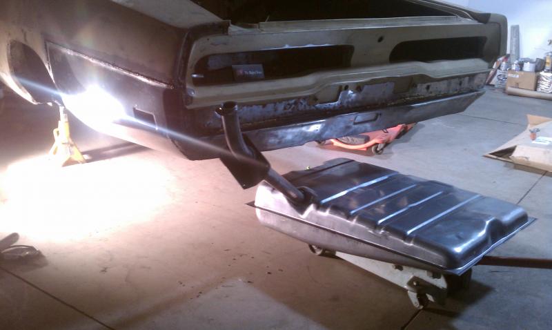

And finally last night got the new fuel tank and rear end back in the car :icon_cool: It was pretty fun monkeying that stuff in there by myself, think I'll call a couple friends up to come help next time haha left the rear drums untouched since they seem to be in working order and they won't be on the car long before I convert them to disc. Feels really good to be almost done under the car :icon_thumleft:

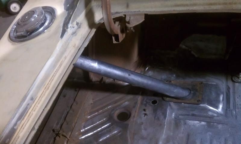

I'll get a final before/after picture tonight, but I'm really happy with how everything's coming together. Next on the list is a field trip to my buddies house this weekend to do the last of the metal surgery around the rear window shelf. Running on all 8 and moving right along :evil7:
