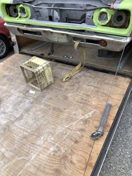

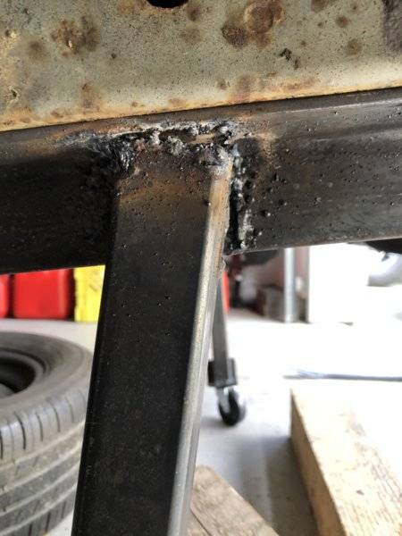

My biggest hurdle was how to move the car. I didn’t want to buy expensive dollies for the front end, and let them get ruined with sandblasting and paint, so I decided to try and make some. I picked up some box tubing, angle iron and casters and took everything over to my buddy’s place. He’s been teaching himself to weld with a little Lincoln. We managed to get everything cut and welded up in an afternoon. It didn’t look pretty but it seemed solid. I got home and mounted them to the car. As soon as I tried to roll the car to the right, on bracket started coming apart. I also realized the casters are a bit too small. I’m hoping we can fix the one bracket and everything will hold. I just need to get it on/off a flat deck, and into/out of the spray booth.
Buddy needs to work on that welding a bit more..zero penetration, he's just gobbing filler on top. That and you need an angle brace..
Agree with dadsbee, you should do some practice welding on scrap metal before risking life and limb laying under the car supported with those welds.

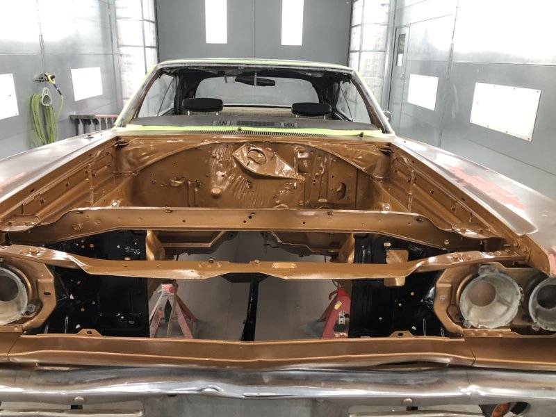

I was in a bit of a slump with the car but this weekend took a big step forward. Got the engine compartment sand blasted..sand is still coming out of everywhere! Then to my buddy’s shop where he painted the engine compartment T7 and added the rad support blackout. Brought the car home today and put the front suspension back in. I just need to put the torsion bars and calipers on, and torque everything. It was a Garage Squad quick paint but I love it and it looks 100% better. The worst thing is the Gorilla tape pulled off some of the crappy paint on the fenders....
My home-made brackets did not survive the trip, thankfully my buddy had these nice ones to use.
He need to read some books on welding and practice a lot more, like dadsbee said. If you're under the car and something breaks...
At this point, you should commit to removing all the sand that is trapped in the cowl, rockers, etc. When you wash the car, get caught in the rain, etc, the sand will get wet, hold moisture as it slowly dries and cause rust.
We spent a lot of time blowing sand out of the frame rails, nooks and crannies. I pulled the dash out today and will clean all in behind the firewall.
