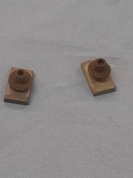

Thanks to Justin I was able to locate where these go, used for the rear top of vent frame.

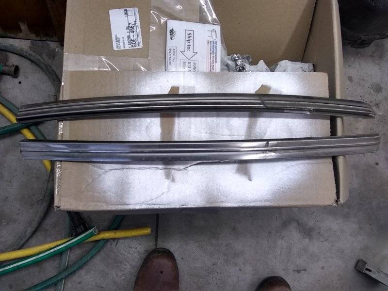

Dug these out. Need to find replacement seals & get them polished up. I peeled what I could out, then put them in the solvent tank to soften up the remaining pieces of the seals.

Dug these out. Need to find replacement seals & get them polished up. I peeled what I could out, then put them in the solvent tank to soften up the remaining pieces of the seals.View attachment 773259

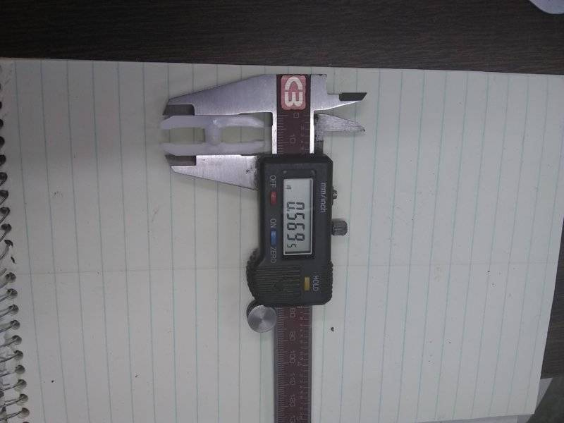

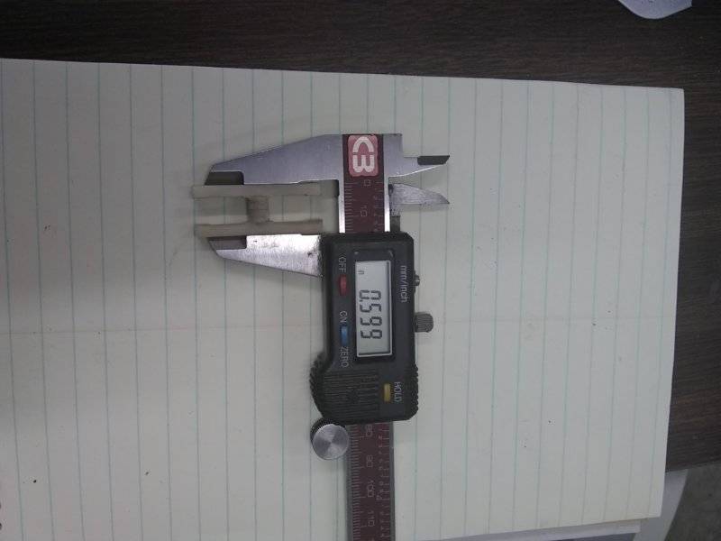

While on the topic, almost everyone recommended using the original clips. I managed to come up with 4. I then compared them.View attachment 772217 View attachment 772220
We had to modify the new clips. The new ones were too thick, had to grind them down the the original dimensions. Also used the reproduction mylars, which ripped when installing. Got NOS ones and they slipped right in.
G, I have the repop mylars to practice with. I have a set of OEMs coming if needed. Hopefully I have everything in the next week or two to get them installed.

I pulled these out of the solvent tank and got the glass setting tape out. Took me about 1/2 hour per piece. I did find the ones off my original doors off my first 69 RR. I Think I'll use them if they polish up good. That way I will have something off both the 69 RRs I had on this car. Just kind of a sentimental thing. Hoping to have everything from Richard so I can get the side glass installed this coming weekend. He has been such a good guy to deal with. If you get a chance please use him. 69Bfan.
BTW what's everyone using for stainless polishing?
