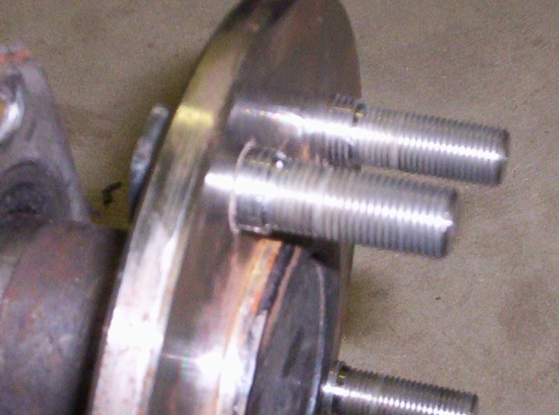

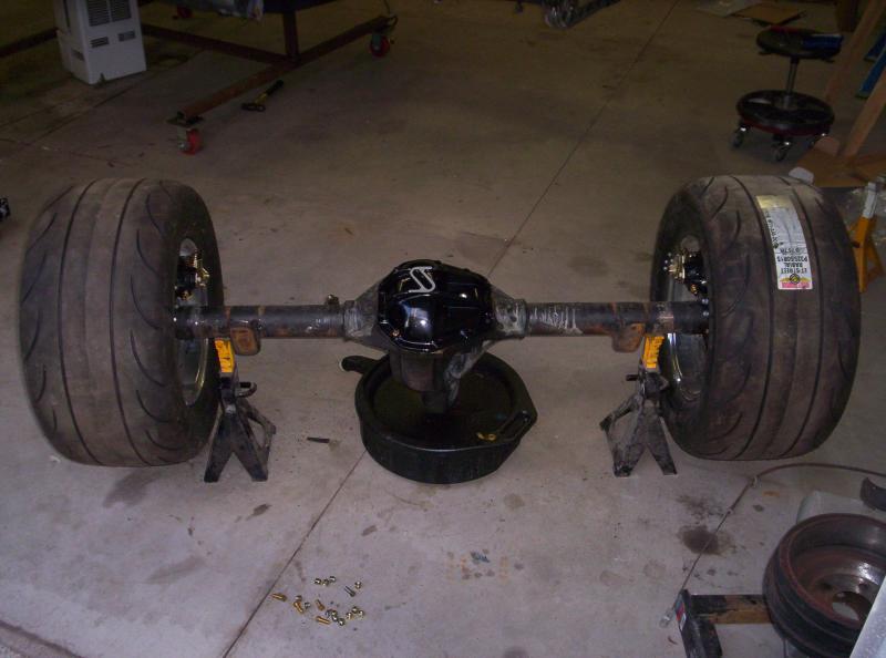

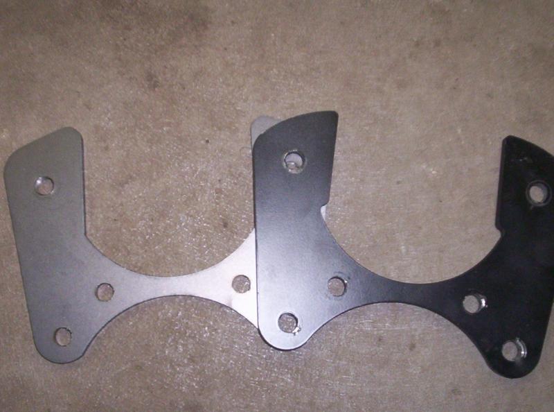

I turned down the 5/8 studs to 1/2 for street rims and moved the holes in the caliper brackets to get some clearance fot the Stockton 15" Mag 500's

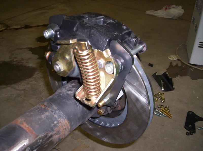

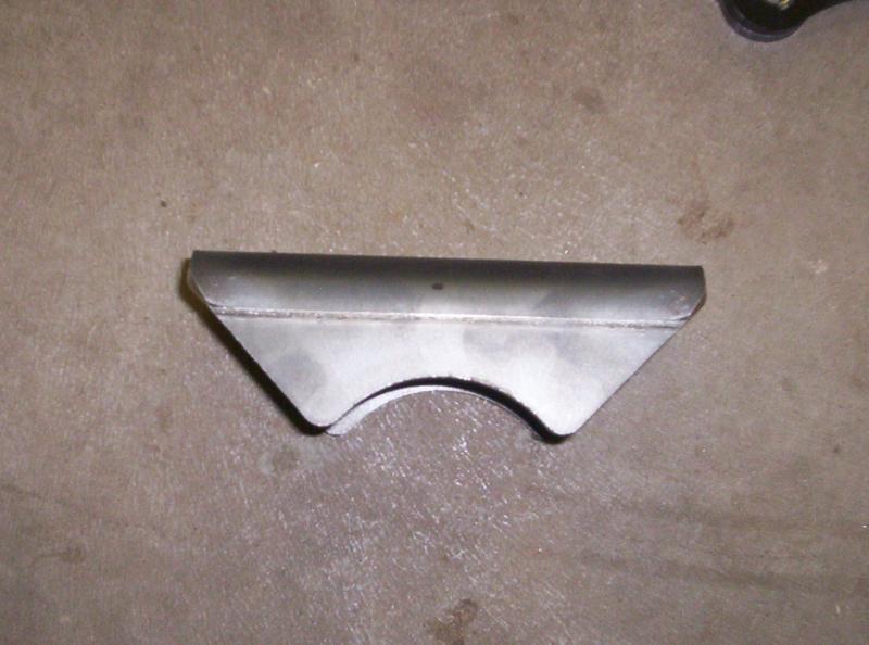

Made my own spring perches to lower the stance of the SS springs.

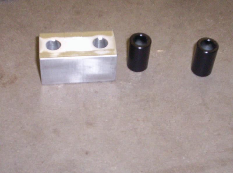

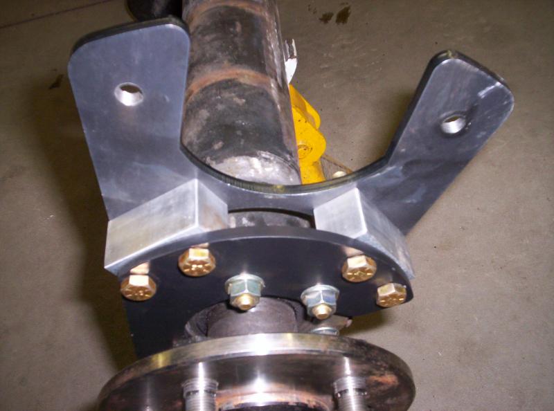

Replaced the round spacers with alum. blocks for a more solid bracket. Also replaced all the hardware with grade 8 bolts.

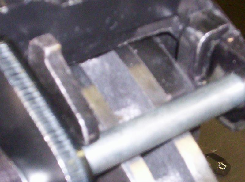

Completed assm. You can see that after lowering the caliper that the brake pads are now fitting the rotor better and flush with the O.D.

Nice work on the breaks "looks pretty solid to me".
Breaks look real good. What's the size of your tires if you don't me asking.
M/T DOT Drag Radials 325/50-15 on Stockton 15x10 Magnum 500 wheels

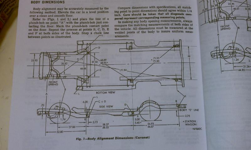

OK guys need some advice. Getting ready to roll the car back out to start hanging sheet metal. my question is what do you use for referance spots to measure and level the car? I made my dolly with all four points of support adjustable for height. Do I use frame rails front and back to level???
Not sure if you've seen this or if will help? >

Where did you find this? Looks like just what I was looking for! BTW Year One has a 30% promo today, super4.
