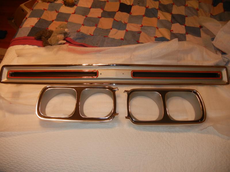

Well I went to Chi-town over the weekend and picked up some bling for the X. Trunk finish panel, headlight grille bezels, bullet turn signal indicators for top of fenders, and turn signal lenses for the front. Also dropped off my tail light bezels, wing vent frames, for Bill T's to redo. He did a A+ job on the pieces I picked up. Very happy with his work. I'll post some pics tonight. was a long day yesterday but making progress.

Bill @ Special T's in Chicago does do great work!!!!!
Pictures don't lie!!! I do imagine it cost enough but it is some great work, something some advertize and don't get it done.

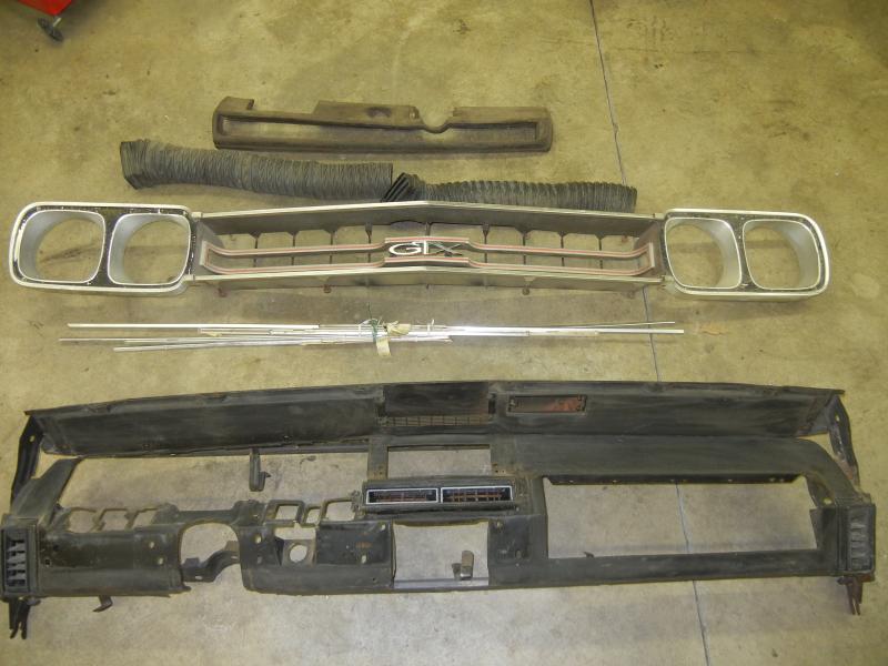

Well I'm headed to Texas tonight to pick up a grille, side molding AC dash and dashpad, and rear bumper and brackets. And if I'm a good boy maybe a ride in a 69 Hemi GTX :headbang:

Well back from Texas. Got complete grille, side molding, AC dash & dash pad, with ducting. And a ride in a Hot 69 GTX with a Ray Barton 528 Hemi. Man is that thing a beast. This gentleman is Mr. B Body!
