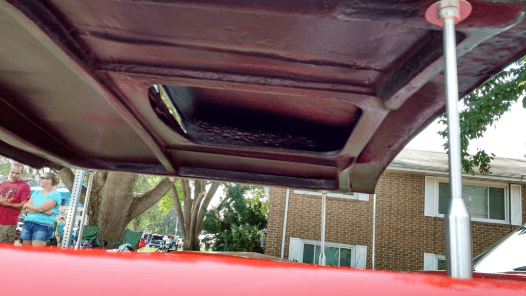

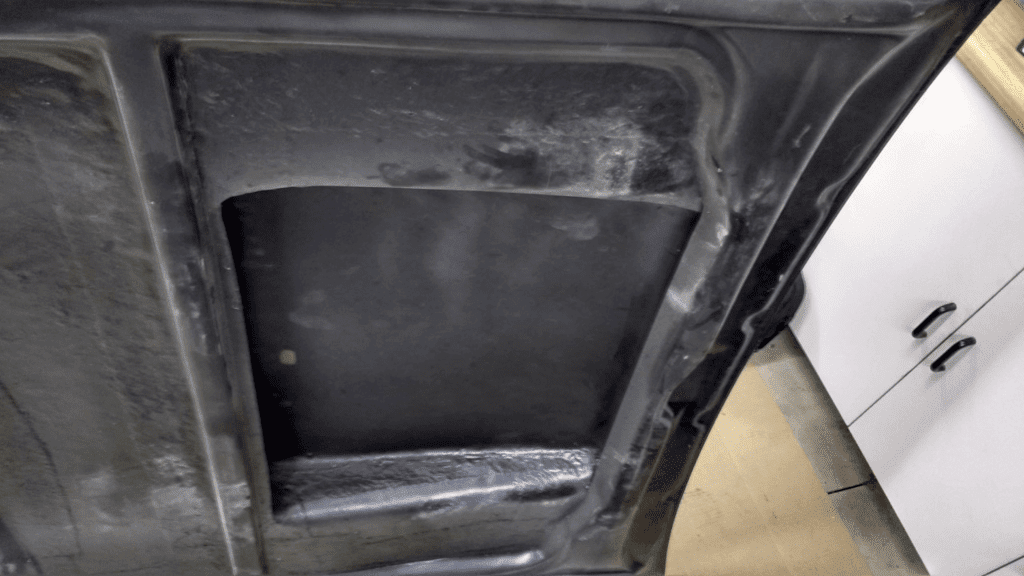

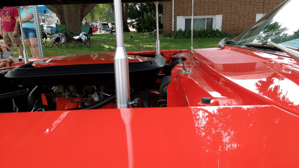

So I took some reference pictures of the red A12 RR at the car show. Looks like I'm going to have to do some clearance work on the air cleaner hood. Notice the extra braces on the A12 hood compared to my hood. Also notice the rear brace at the cowl goes clear across, I'm going to be doing some fiberglass work, but I'll wait till I get the fenders back on for that.

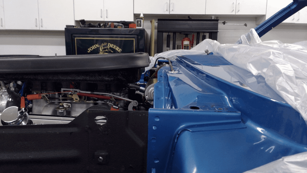

I looked at that but, the lip of the base I think is still to tall. I put the Schumacher motor mounts in and they looked tall at the time. I may go back and put solid motor mounts back in to lower it a bit. I'm sure the trick flow alum heads and phenolic spacers make for at least .5 of an inch.
It doesn't look like the aftermarket hood I have was made to seal to the hood. I'm sure I can make it work, will just take some more time. Good thing I didn't try to put the stock hood on!

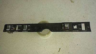

Do you know what the extra space was used for that is not opened up on the right side? Seems I've seen the factory used it for something but can't remember what. Was thinking of using that one for the Overdrive on off. Using another rocker.
Did they always use the small label plate to lay over the panel and use the screw hole to the left to attach it?
Can't seem to find a clear picture of one.
Best picture I could find Justin
The third from right side.

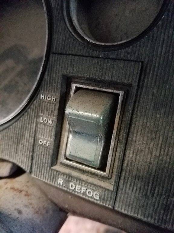

That is correct....So a vert switch would have a plate like up, down, off....and a defroster would have on, off etc....So two plates would have been available.....
So if you happen across a on off plate ley me know! I will be on the hunt for one.
Here is a defogger switch plate on a 68 ralleye dash. I know its different but i would guess the lettering would be the same for a sweep dash. Might need to do a custom job...
