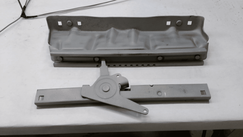

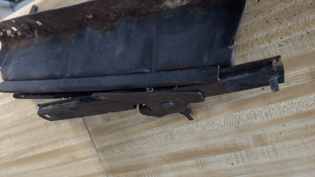

So I'm bouncing around here a little, working on the bucket seat frames/adjusters. Going to take them apart to blast and paint. A little rusty at the bottoms but not bad.
First thing is that the release wires underneath are different lengths left to right seat. I put divots on the release lever to identify which wire went where.

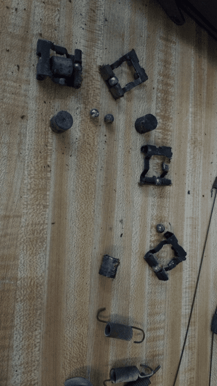

Pull out the carriage bolts. I used a file to remove the stakes. Then you can remove the cages with bearings.
BTW the knobs on the release lever have set screws holding them on!

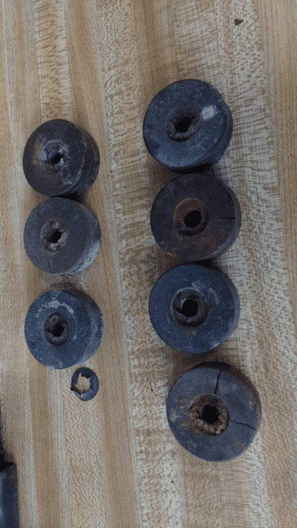

Going to make some new spacers as these are cracked or close to it.
I think the tuff part was getting them apart, removing the staked bolts! I'll let you know when I reassemble. I used a file but a Dremmal with a cutting blade would have been faster/easier.
Ahhh, brings back memories! Those rollers get cruddy as heck too. I removed one of the rivets on mine to get them apart but like your way better. Just a good cleaning and re grease works wonders.
You can get 2 sets of those spacers for about $28 shipped from ebay if you don't feel like making them.
Looking good!
Thanks for the heads up on the spacers. I have access to a cnc lathe so about 15 minutes and bingo.
Yes that grease they use was about like tar. I'm sure it'll be so slick I may have trouble going from one extreme to another. I usually had mine all the way back or next to last notch.
