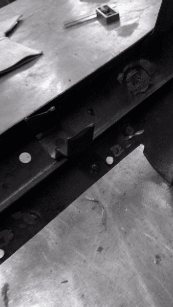

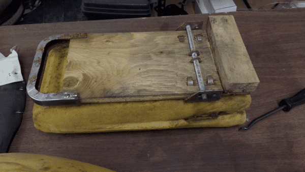

These were the places it was stuck.

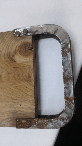

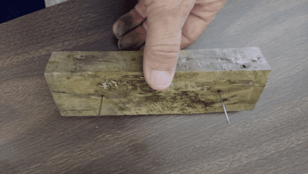

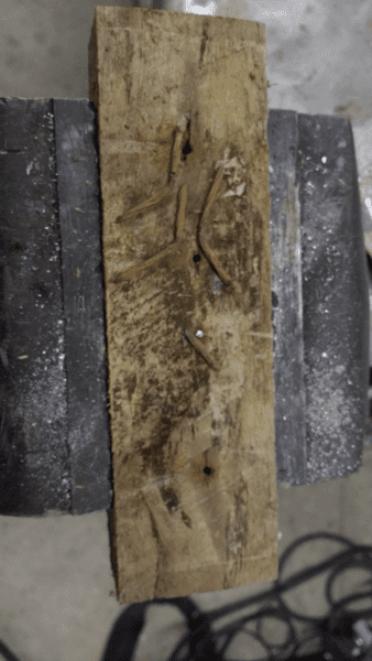

I had thought the 1x2 piece was something that was added when it was recovered. But upon inspection it had the original staples in it. Also I doubt the would have used spiral headless nails to attach it. I will use some liquid nails and a couple stainless screws to put it back together.
Yup I'd say that's about 40+ yrs young!

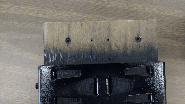

So After blasting the metal parts & spraying some black on them I put the wood block back on. I used some tig rod to line everything up, put a little wood glue on then put 2 wood screws in.

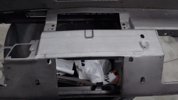

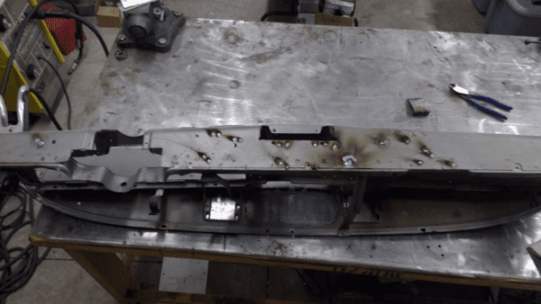

Anyway I dug the dash out and welded all the extra drilled holes in the bottom of it.
Notice the huge one just to the right of the ash tray, not sure what that was for! Next I'll be cutting in the holes for the AC vents. Then on to prime & paint.

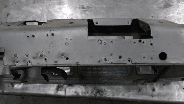

Anyway I dug the dash out and welded all the extra drilled holes in the bottom of it.View attachment 530841 View attachment 530842 View attachment 530843

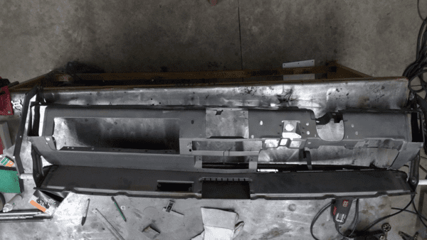

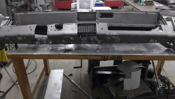

So last nights endeavor was to cut the holes for the AC vents in the factory locations. I bought a AC dash with all the goodies, using it for a pattern. First I grabbed my calipers to get measurements and get it laid out. The correct lines are black. Took to tries to get it right.
Next I used a cut off wheel on my 4" grinder to cut the holes.
I used a sanding wheel to finish the openings to size. I was able to keep them within .020 of the oem openings on the other dash so that was pretty good. I'll get the vents out to test fit before I go to paint. I found a couple thing to address while comparing the to dash frames. Mine had been a drag car for a while so some stuff got hacked up. A harness clip was cut and a bracket was gone.
