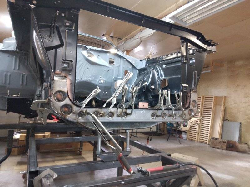

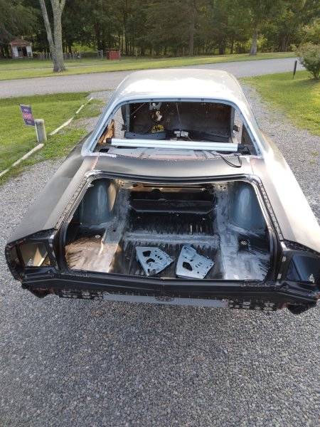

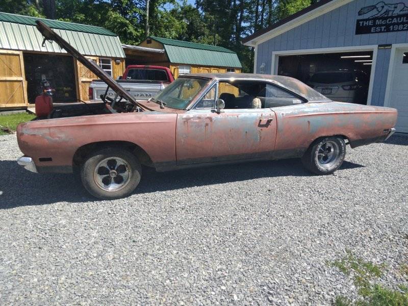

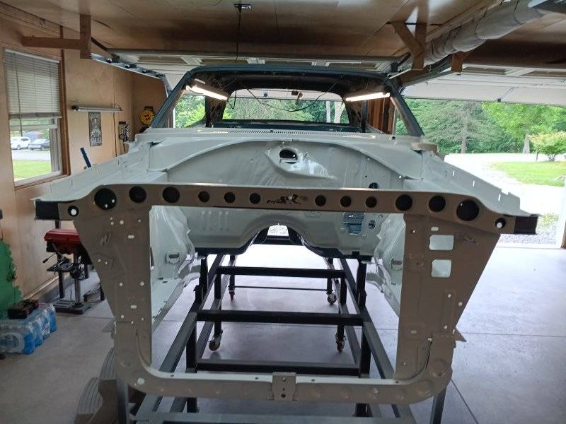

So im posting this for my dad, easier for me than him, (internet understanding passed him). so he got a 69 satellite from his father when he was in high school belive it was mabye 77 or 76, he drove it for a few years, parked it till 86 drove a year and parked again till we started restoring in sept of 22. The build started with the basic new trunk, rear crossmember, all the normal rusty stuff an eastern snow driven car has, needed quarters repaired so skins were unavailable which meant new quarters, etc, so on way more than i planned. Here are a few pictures ill update so more info on whats been done already and where we hope its headed

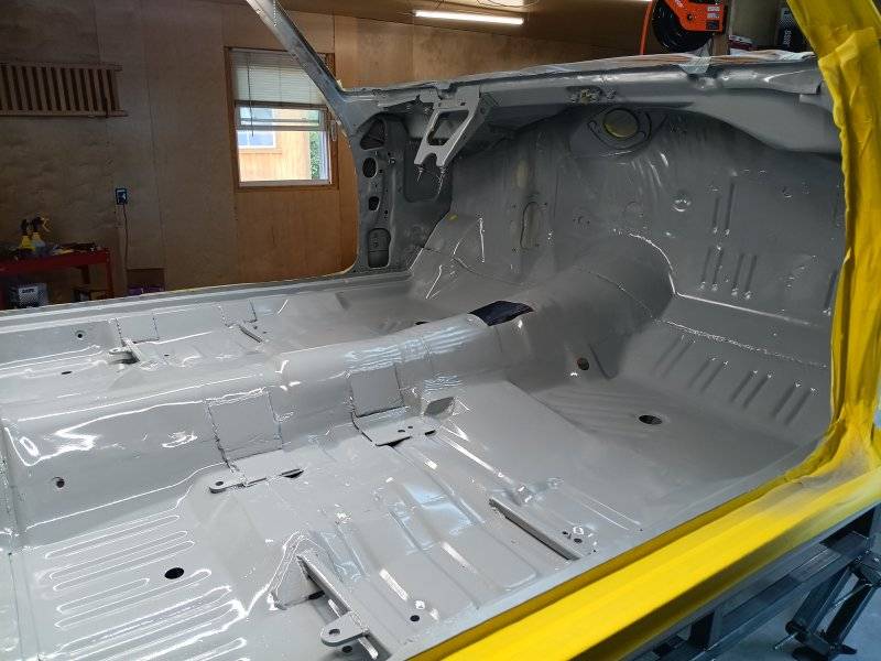

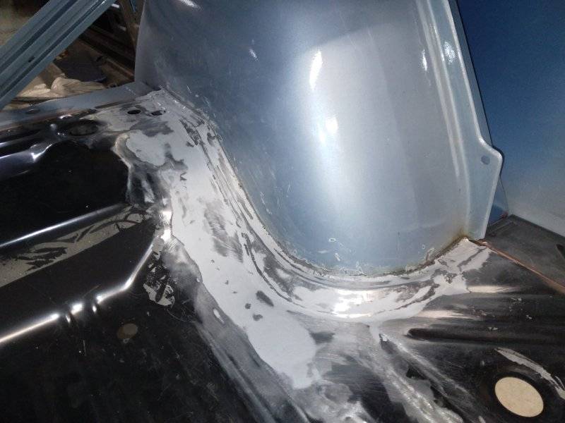

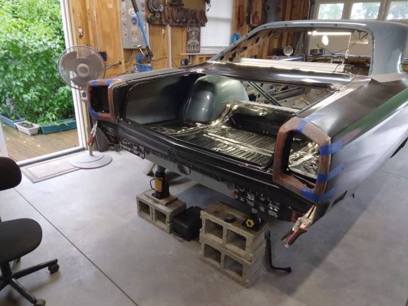

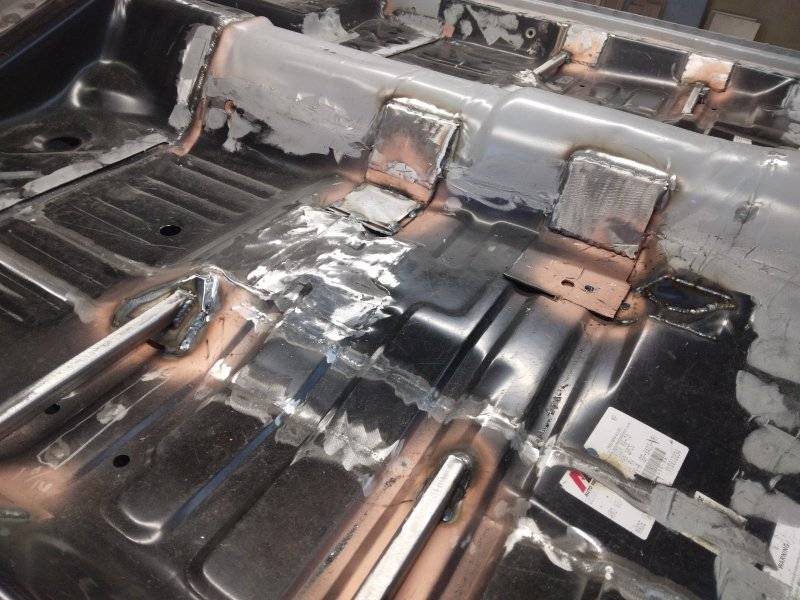

So not sure which would be quicker a list of the orginal metal left or what was replaced. All the major metal work is done, within the next few weeks ill be laying the epoxy on the outside and 2k and all the fun blocking to get ready to paint in probably end of August, mid September.

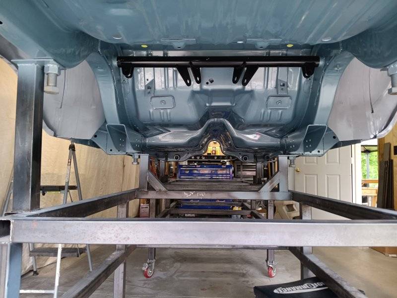

Car has been stiffened with usct torque boxes, frame connectors, inner fender and upper/lower core supports. Motor is a blueprint 408 with a TKX 5 speed. Still have to order the rearend. Suspension is from QA1 complete coil over conversion front and rear, Dad wanted to go with new stuff. Will be painted back to the B3, but with modern formula, close as i could get it, the inside is B7. Dad wants to put keystone classic back on but wont fit over the wilwood brakes, so looking into a company to make a modern 18" similar to the old keystones

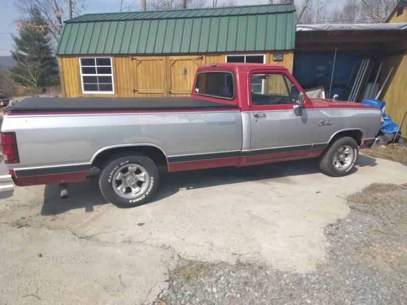

Thanks! Ill pass it on to him. its always had a 360 in it since he got rid of the 318 back in the day, so we decided to stick with it. Ill end up putting the 360 out of it in my old 1st gen dodge d150

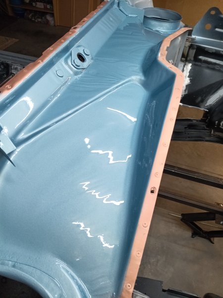

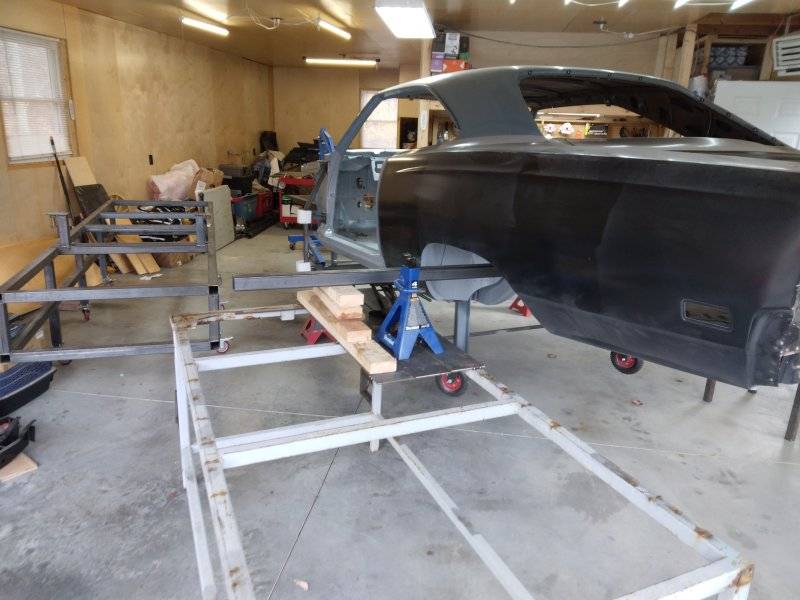

Few more picture's, some of the body work and paint
Some more. Sorry about the random progress order, i guess i shouldve did this for him over the past two years

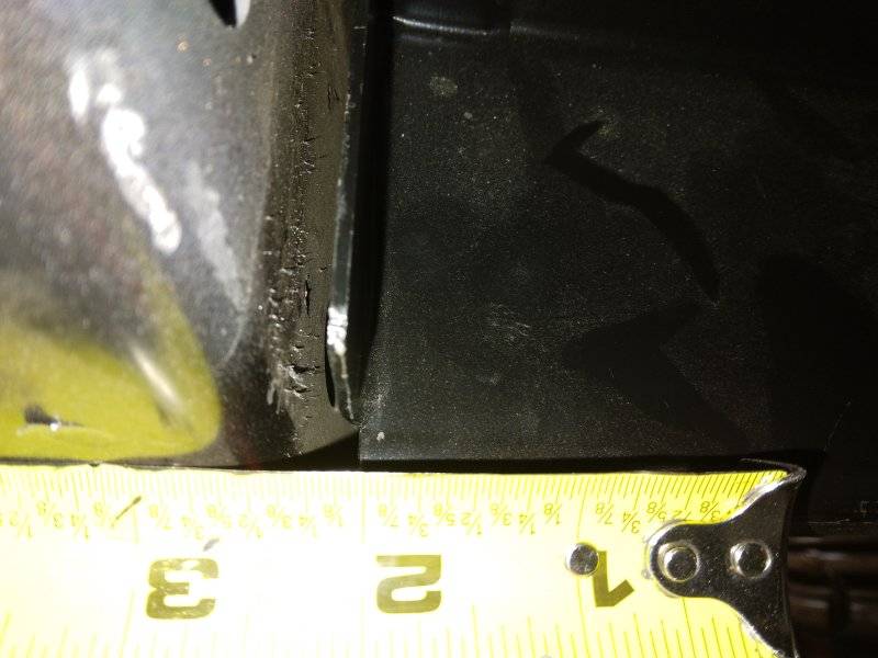

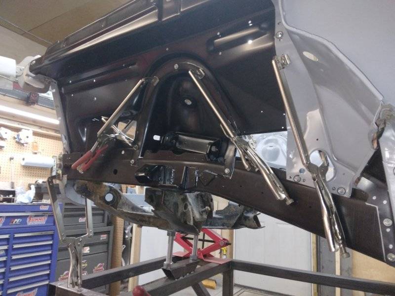

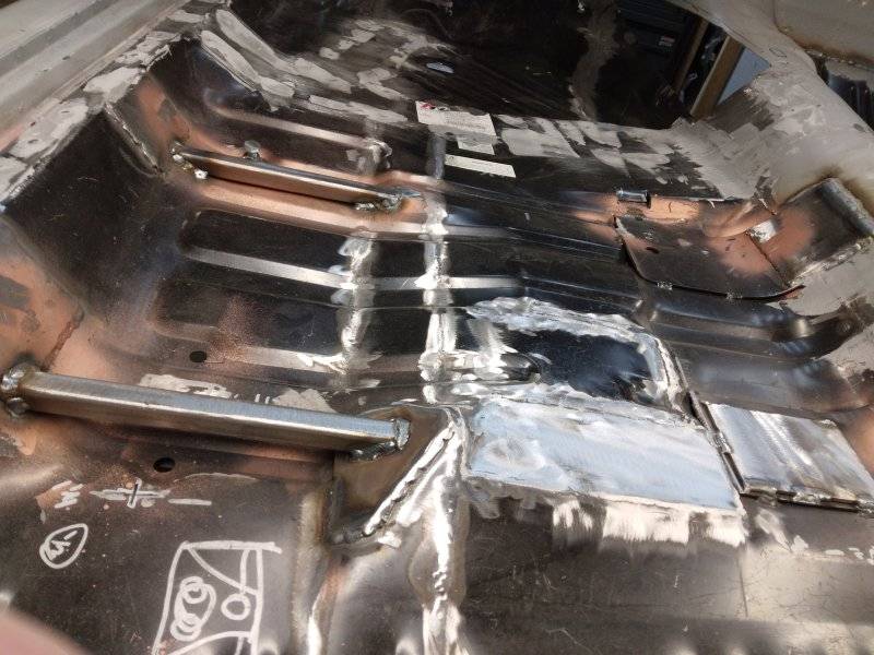

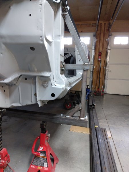

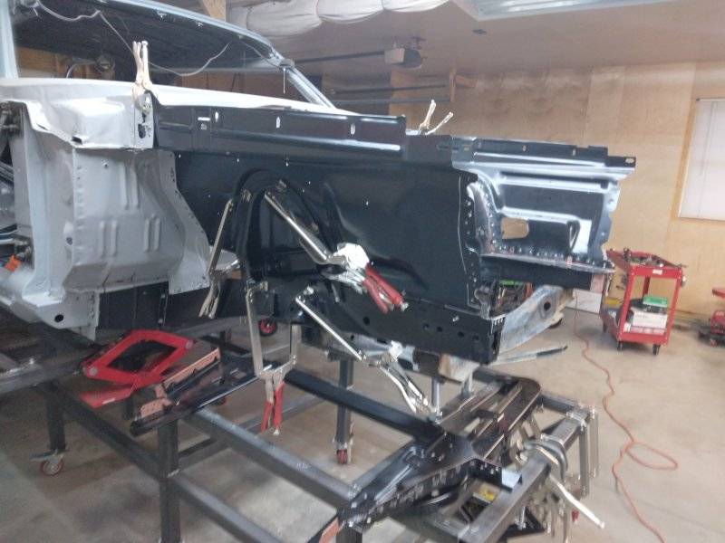

Some of the front end work, both frame rails were rotted and soft, so had to tackle replacing both. Did one at a time, with the k member bolted/welded to frame rack with 1" bolts to make minor adjustments as needed. Couldnt find any old rails close, so of course AMD rails were the choice, I won't say they were great but the fit close and little mods where they start to curve up a firewall made fitmet fine. DS was about 1/4" out where it met the torsion crossmember, but tek screws and jacks got it closer. Also where they met the crossmember the bends for the tabs were short so i had to cut and add a new tabs

Not a bbody, but i got this off my grandad 24 years ago. He bought it new, i have 103000 original miles. 318 with auto. rims and tires, 2" drop in rear to level, everthing else unchanged. Will do a little minor bodywork ( doors, PS bed wheel well) over the winter and put fresh paint it in the spring. Same colors. If you look at the old picture you can see dads satellite. It sat in that spot year after year.
