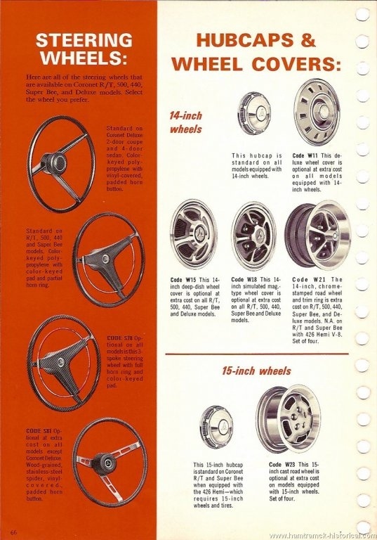

what rims came on a 1969 super bee. I do not have the broadcast sheet and I was wondering what the options where for these cars.
Luke
All I know, and I may be incorrect, but they were all 14" wheels. Maybe someone more gangster than me can expand on the rims question:rofl:
I am aware they where 14" rims. Just wondering what styles where available. Magnum 500, steelies, cop style, etc
Luke
pretty sure 14x5.5 steel (hub caps) or 14x5.5 magnums with trim rings. hemi's and 6paks had 15".
Magnum 500's is really a Ford term, Ford used the same wheel with a different center cap. Chrysler called them "Road Wheels" (Very imaginative name) Option code W21. See below.
These data sheets are for '69 Coronet.

It depends..
Dog dish cars would be body color
Cars with wheel covers would be black
