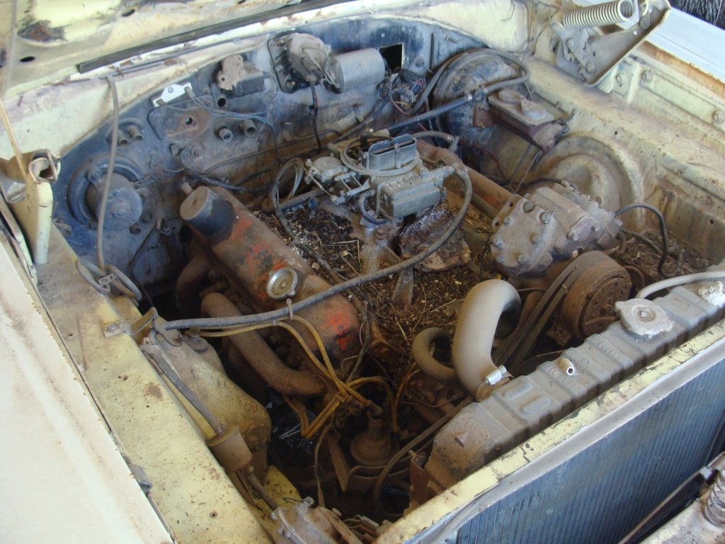

If anyone else has any experience with something like this, please feel free to chime in. I attached a picture for fun so you could see the mess I started with!!!

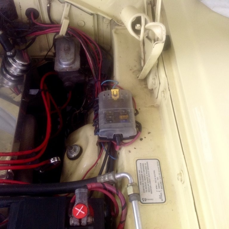

Bulkhead connector cleaning is just good housekeeping. Remove all banks carefully. Do not break off ears. Spray with contact cleaner until it runs clean. Plug back in. Finally an engine compartment picture that makes mine look clean!
