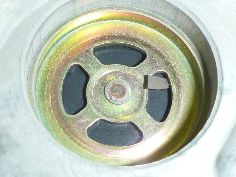

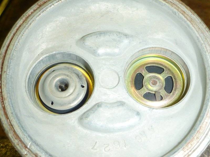

No specs from Amazon, what a surprise. Looks like 1/4" pipe thread. If your fuel bowl vents correctly, it shouldn't siphon back to the tank. Fuel pumps have their own valves, so if the pump isn't the issue, it may just be the 10% ethanol in the gas nowadays, unless you don't have that in NC.
