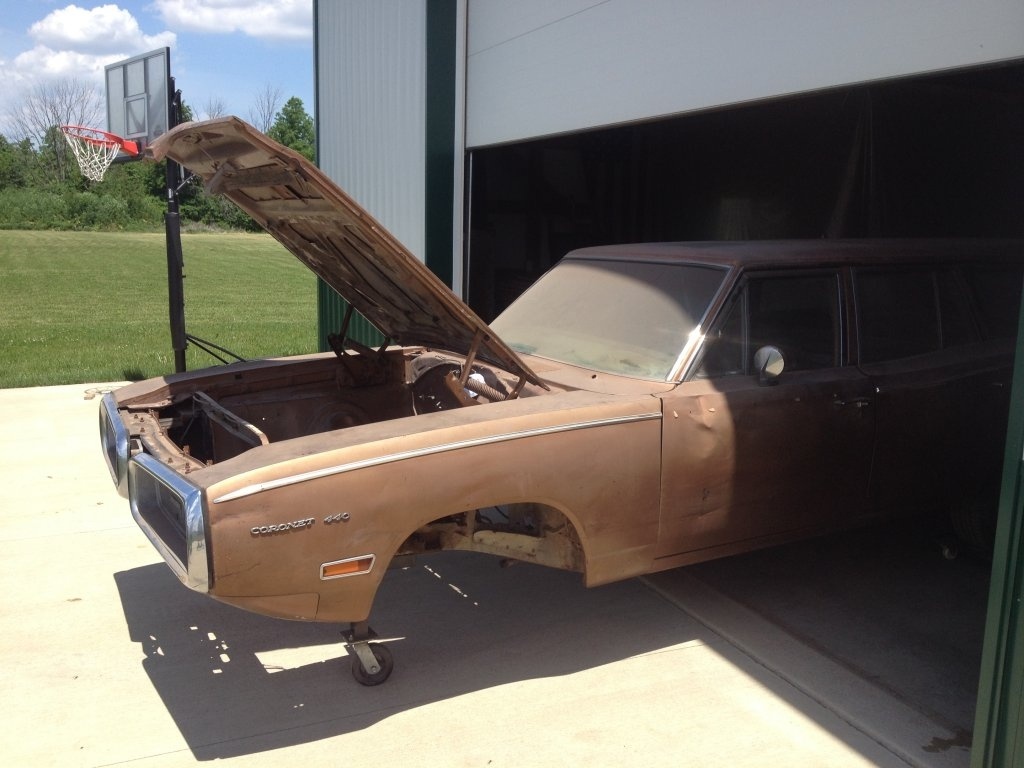

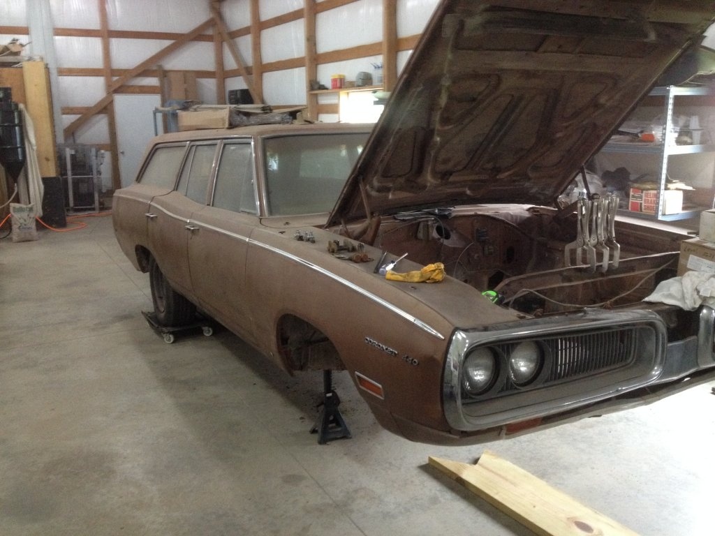

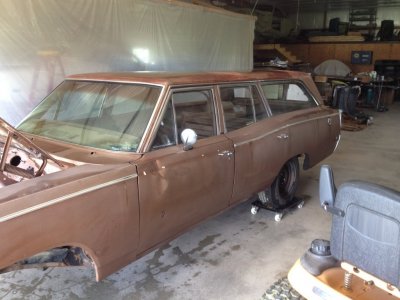

I decided to take a break from Coronet restoration in an effort to get the Wagon in "driver" running condition for the summer. Thinking I would like to at least enjoy driving something in the short term.

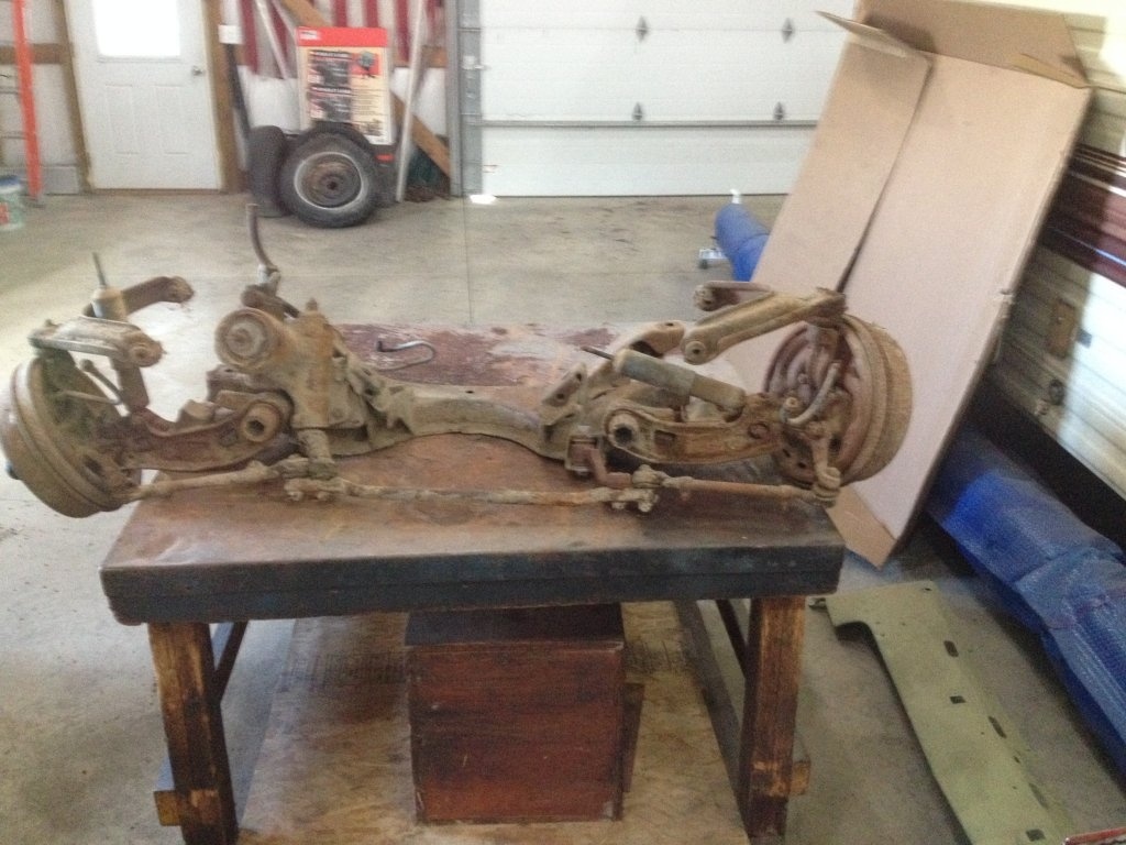

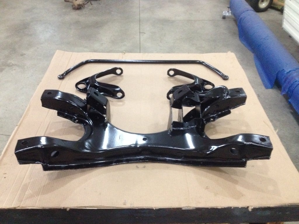

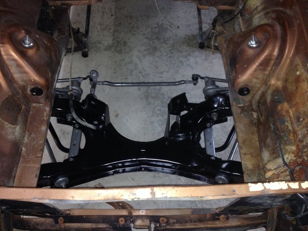

Had my brother help me remove the entire front suspension in order to rebuild it. Bot everything tore down and blasted for paint. Purchased bushing kit and new power front disc conversion kit. Almost ready to start assembling everything for reinstall.
Here's a few pics.

Nice Coronet, and really nice work on it!
That wagon will make a nice cruiser until the 2 door is ready....

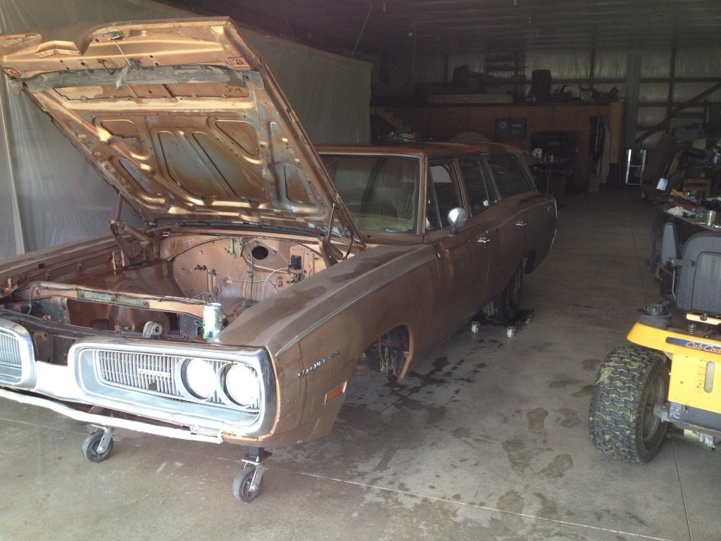

Got a chance to give the wagon a much needed pressure wash this past weekend. Car must have been in a flood at some point cause a ton of dirt/mud came out of it.

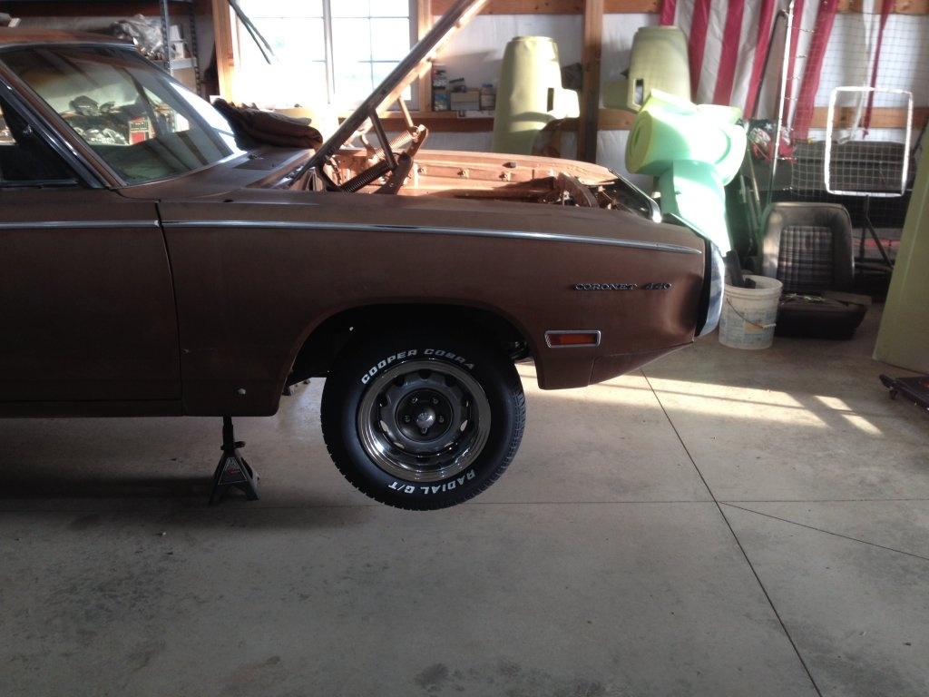

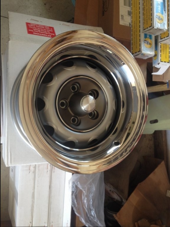

I ordered new ralley wheels and bilstein shocks for her. Need to get some new rubber purchased too as I'm getting anxious to get wheels back on the car.

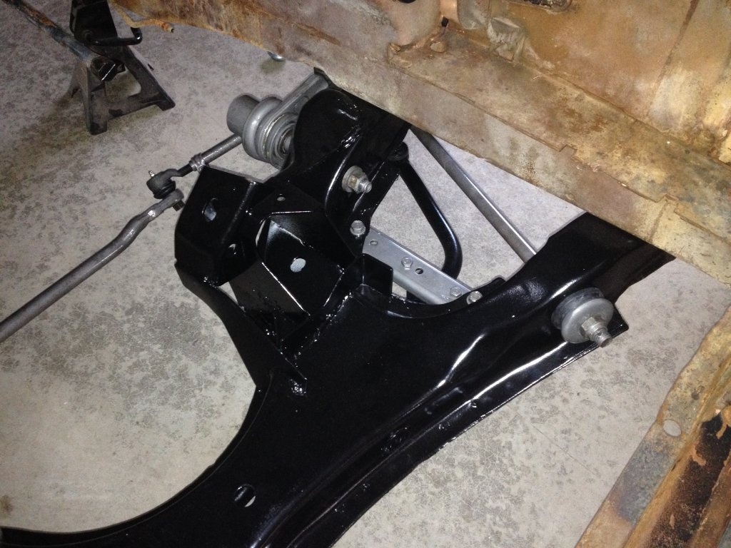

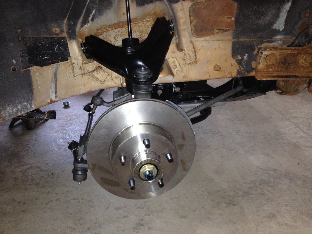

Finally got the chance to finish putting front suspension back together and get it in the car. Everything cleaned and painted/sealed with new bushings. Also converted to front disc brakes. Things coming along nicely.
Hopefully I can get the calipers mounted this week. Just waiting on power steering gear box to be finished to bolt that back on. Also went with the Bilstein shocks I've seen good reviews on by other members.
Received my new wheels a while back and I'm excited to see how they look on the car. Hope to have tires later this week so I can get them mounted and on the car.

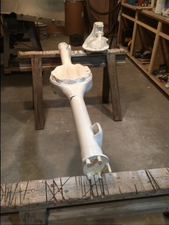

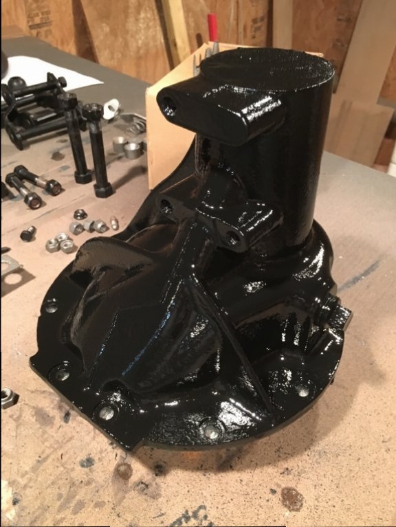

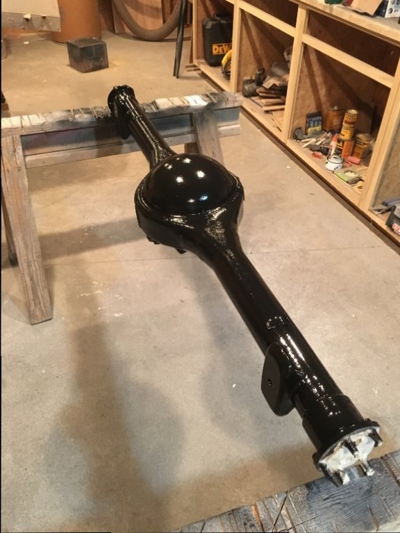

Anyway, moved to the rear of the wagon. I got rear end out so it could be replaced by 8 3/4.
Ordered all new seals, bearings and gaskets. Also picked up a used center section at swap meet with 391 gear and posi. Thinking about buying new 355 gear for it.

Got pretty much everything for the rear end cleaned, painted and ready to go back together. Should have it ready for install in a few weeks. Just need to get leaf springs cleaned up.
