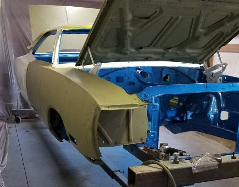

Here's a pic of the new skin hung. Just need to pull back off so I can scuff and shoot with epoxy primer.

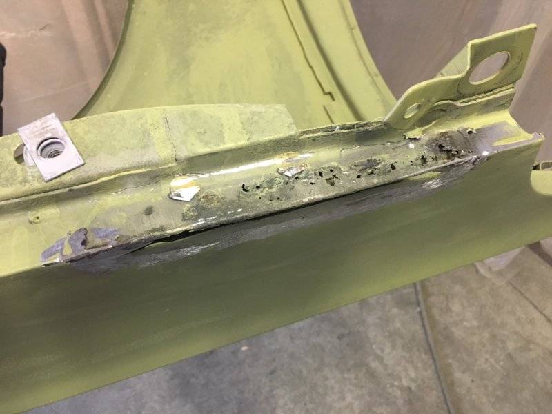

Pulled off driver fender to repair some brazed patches. Ground off patches to reveal some areas that were previously band aided rather than patched correctly.
I'll work to cut out these areas and weld in fresh steel for proper repair.

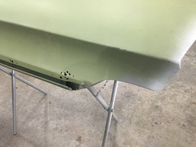

Got another old patch braised on the lower rear portion of the fender that needs repaired. I bought a new AMD piece to make repair, but I got delayed.
WTF!!?? This new piece isn't even close to being wide enough. It doesn't even have the correct body line that runs around the wheel opening.

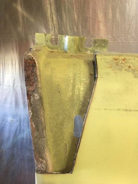

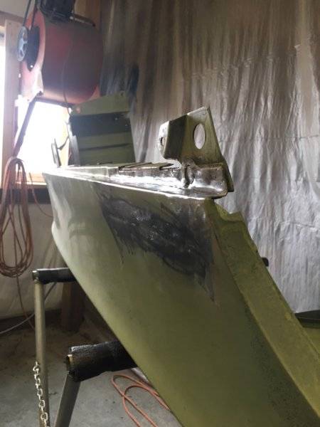

Had one more scab piece to repair on driver side fender. Got the Sherman patch panel in and got to work.
Here's the braised area and hole underneath.

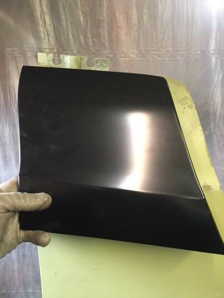

Using a paper template I made I cut out bad metal area along with dented area I couldn't bang out due to brace behind.
Used same temple to cut Sherman panel for new patch piece.

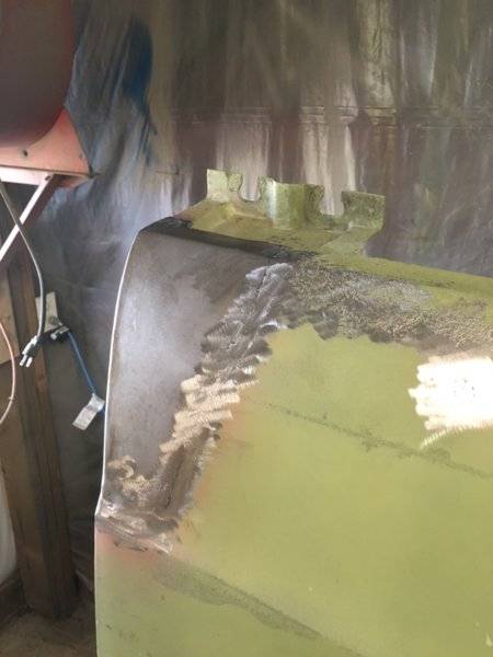

And after spot welding and grinding.
Took about four hours but I'm happy with the results.
