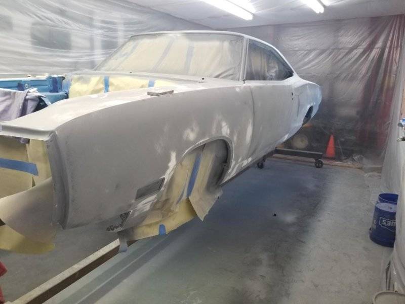

Finished blocking first round of high build. Had a few low spots that we filled with icing and blocked down, then applied second round of high build.
Getting a little closer.

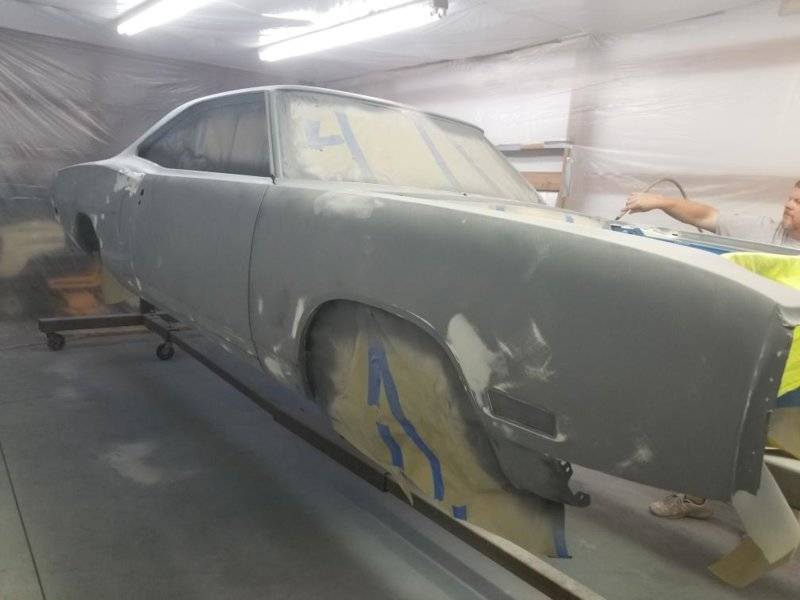

I forgot to take pictures of the second round of primer and blocking, but remembered at the end of the third round. Here’s a pic after blocking the third time. Only had a few spots to applying icing.
Had a local body guy stop out and check our progress and provide feedback. He thought car was really close to being ready for color so my brother and I sprayed fourth coat of high build tonight.
Based on how it looked while primer was wet, the body guy said to just sand with 400 grit till the black guide coat is gone and it’s ready for sealer and color.
Finally!!

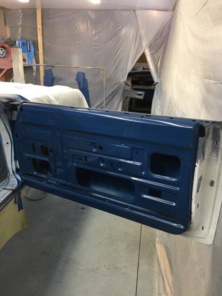

Made a little more progress this weekend, shot color on inside of doors and rear upper trim panels. Also shot color on underside of hood, hood springs and hood latch support.
We already sanded door jambs and plan to shoot color on those next weekend. Just wanted to give inner door paint plenty of time to harden to avoid issues with masking tape.

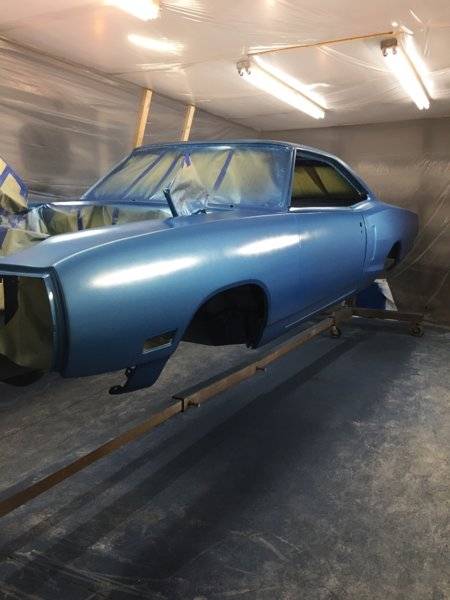

I learned a valuable lesson today. Being this is my first experience with painting, I learned that it’s important to find out when buying paint that you need to ask what the recommended sealer color is supposed to be.
Pretty much all the areas I’ve painted already aren’t exterior panels like trunk, engine bay, underside of hood, etc. were over white epoxy primer. But today we were painting the door jambs and the paint shop said we were supposed to use black sealer before spraying the base per manufacturer recommendations. What I found was a totally different finish color than I expected.

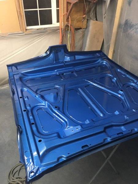

The bright side is this color matches the dark blue interior I have already bought so I no longer need to try and sell to replace with white. Bad news is I need to repaint hood and engine bay. Not so worried about trunk area, but not fixing other areas would be a mistake. Live and learn I guess.
Ended up repainting the engine bay, underside of hood, etc. using black sealer beforehand. I think this will help match better than before. Lightning makes all the difference too. Paint looks dark until you put a light on it and then the blue really jumps out.

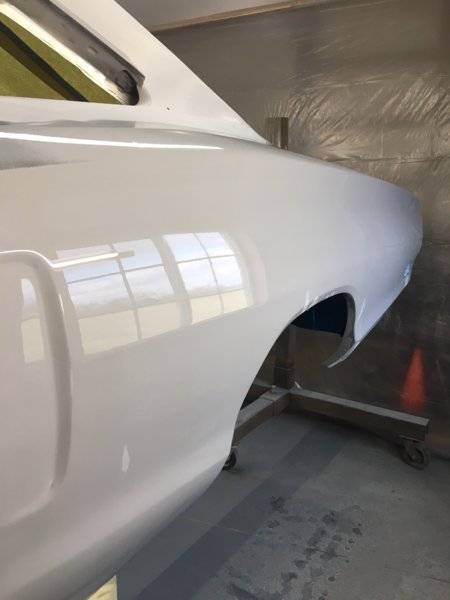

Spent the last two days working on final blocking on outside of car in prep of paint. Then we used water to check surfaces to make sure everything looks straight.
Found a couple little areas where we need to sand a bit more, but otherwise it’s ready for paint. Plan to touch up those areas and paint this coming weekend.
Looking forward to seeing this in paint, going to look great!
All that blocking is really paying off! It is going to look great!

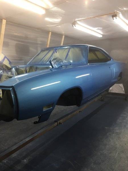

The old girl got her new skin yesterday. We finally got it painted.
