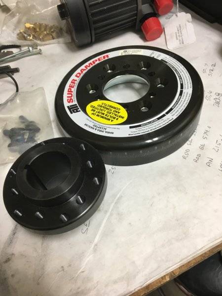

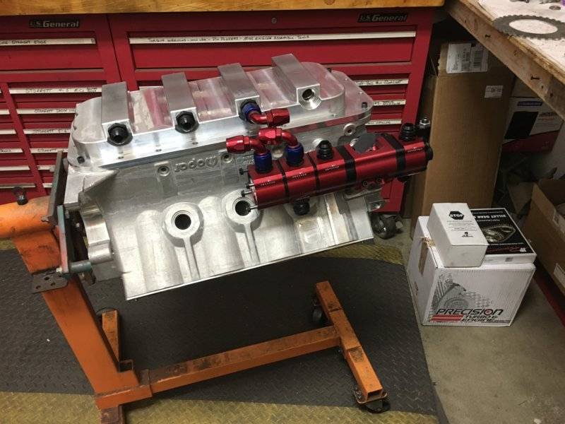

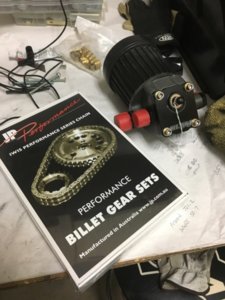

The final piece of the puzzle came in for the dry sump project. Now I need to get the CNC boys on it!

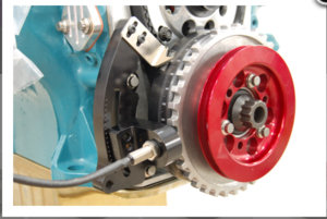

I picked up a JP Timing set and the ATI damper. I also ordered the AR Engineering 36-1wheel and trigger setup with the Holley sensor from FastmanEFI.com. Andy makes some awesome parts and Rich Nedball is a hemi/efi guru.
4F41BC05-6523-4040-B608-979EFF30E533.jpeg A2ED4E05-EBDC-4FC6-9AC6-2A91AD01C9E9.jpeg 0B222D96-B3E9-4408-BF90-DCE13A9B7A11.jpeg
So Friday, I stopped in the dyno shop to see the final pull on the NSS engine for the car I caged. It went north of 800 and sounded great. We had to use my dyno headers as his early B body headers didn’t fit the dyno chassis. I took a few minutes to measure the dyno chassis so I could make turbo supports and mounts for my drysump tank, water tanks and fuel pump.

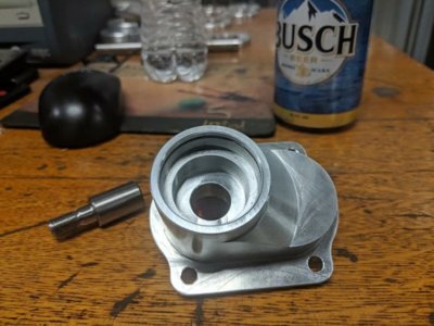

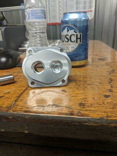

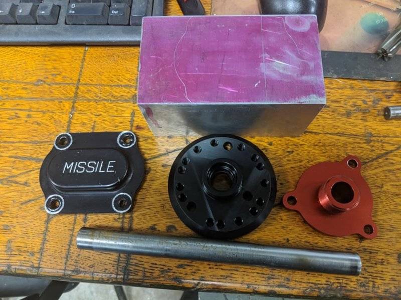

So it like a little progress has been made on my dry sump. You can see the open end of the pump here waiting for its end plate.
Here’s the CAD file for the piece. And the photos throughout the machining process.
