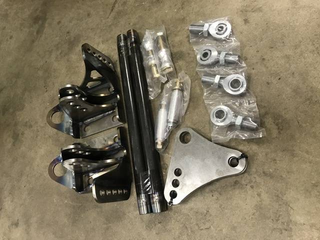

So dumb question: I assume a "fab9" is a Ford based 9" rear?Cal-trac split monos showed up along with the Funkhouser Race cars rear traction bar setup. Now I just need to decide between a Dana 60 and the Fab9 I built as I have both. View attachment 1464841
In factory form, The Dana 60 is much stronger and takes less power to drive. In aftermarket form, the 9” is king in everything from parts availability and aftermarket support to shear power capacity. The weight difference is negligible once you beef up a 9” and in my power range, I feel both would be fine although I would give the nudge to the 9” since it would be an all aftermarket center section and gear setup. The dana60 gives me a much better advantage in the “bang for the buck” category in my case since the center section alone is $2125 for the 9” and I have everything besides the gear set and axles for the Dana 60. You can’t go wrong with either one in my opinion.So dumb question: I assume a "fab9" is a Ford based 9" rear?
I would think a stock Dana 60 is a bit stronger, but also heavier, than a Ford 9". Likely neither of these you have are/will be stock due to the power you will have. Anyway, do you mind briefly mentioning the pros and cons of each? (At least to educate me a bit...)

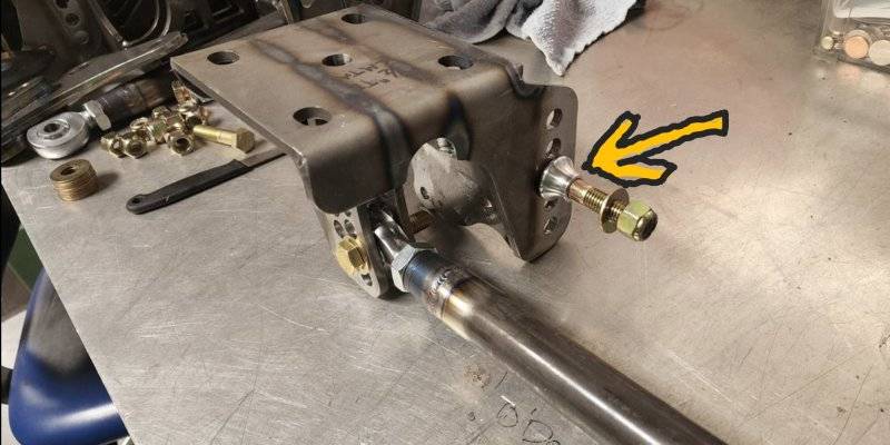

Functionally, they both do the same thing with a slightly different method. Another case of “more than one way to skin a cat”. I chose these for the adjustability over my caltracs and the adjustable shock mounts on them.The traction bars look a lot like my Assassin bars. What is the difference please?

Well, thanks. The additional flexibility of adjustment points and the different way the Assassin bars "interact" with the leaf spring was the difference for my choice, and the Assassin came in the middle of installed height for ground clearance between the full size CalTracs and the CalTracs "low profile" model.Functionally, they both do the same thing with a slightly different method. Another case of “more than one way to skin a cat”. I chose these for the adjustability over my caltracs and the adjustable shock mounts on them.
The arrow points to the multiple shock mount holes if I understand correctly?adjustable shock mounts on them
Yes, the arrow illustrates the shock mounts. My car will be low and I want that adjustment as my top mount is fixed. I’ll be running a fairly long show as the radial cars extend in the rear. They’re all good products from great people but I picked what worked for me. There is no one absolute best product for all applications. It’s definitely specific to each car the “best” solution is most likely different for each application.Well, thanks. The additional flexibility of adjustment points and the different way the Assassin bars "interact" with the leaf spring was the difference for my choice, and the Assassin came in the middle of installed height for ground clearance between the full size CalTracs and the CalTracs "low profile" model.

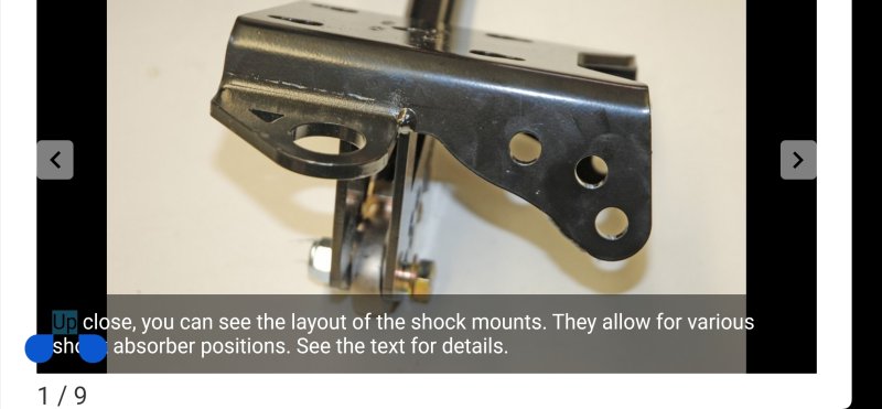

Let me post a couple of pix that may help me see the difference between the Assassin and the Funkhouser or someone may point it out.
There appears to be some shock mounting position flexibility on the Assassin:

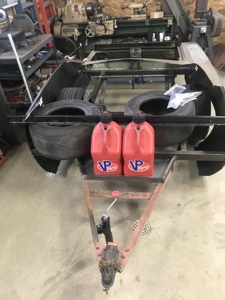

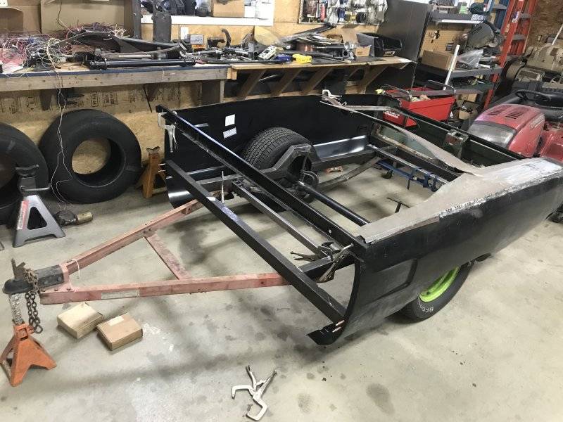

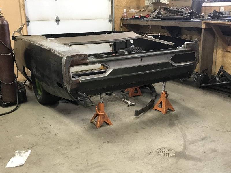

I will be doing massive burnouts with the trailer attached but definitely not racing lol. It’s mainly for convenience on Dragweek. And I thought it would be cooler than just a plain little trailer like everyone else pulls.Will you be racing with the trailer attached? Ha ... Dang you come up with more good ideas than anybody I've ever seen! Bravo Zulu!
