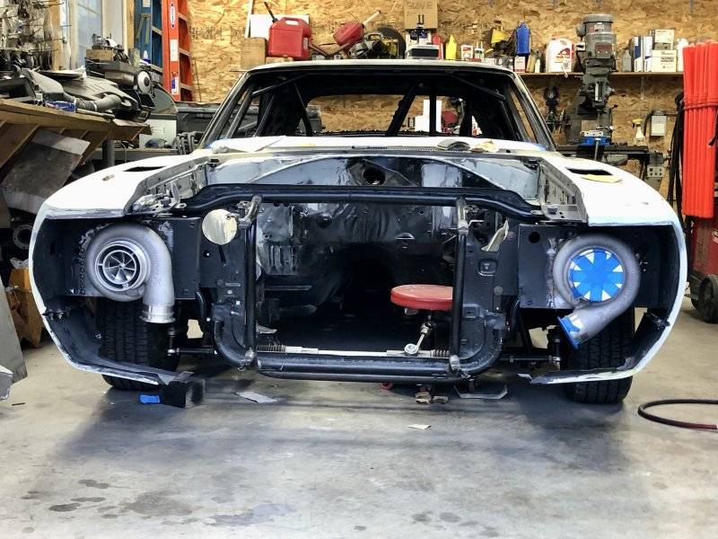

I had a secondary injector pinned to the wrong location causing it lean out a cylinder and back fire. I got that sorted. Ran a few soft 5.93s with 1.5x 60’ times leaving in second gear on E85 with 7psi. Running 17psi out the back. It coasted through the 1/4 at 9.37 so that was encouraging.

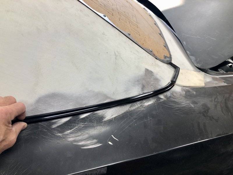

I went with an optic armor panel for a screw in lexan rear window. Definitely adding the vinyl top.

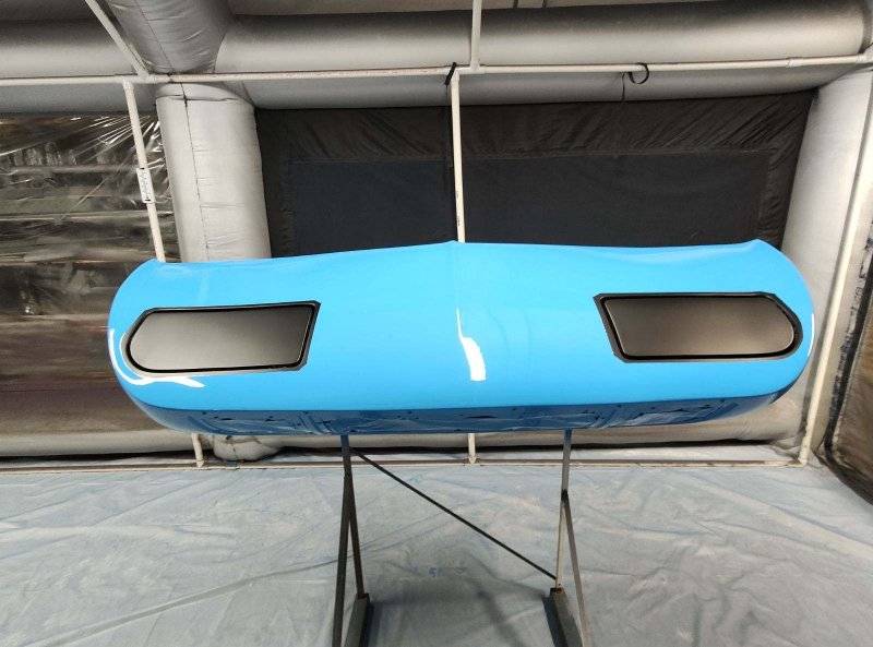

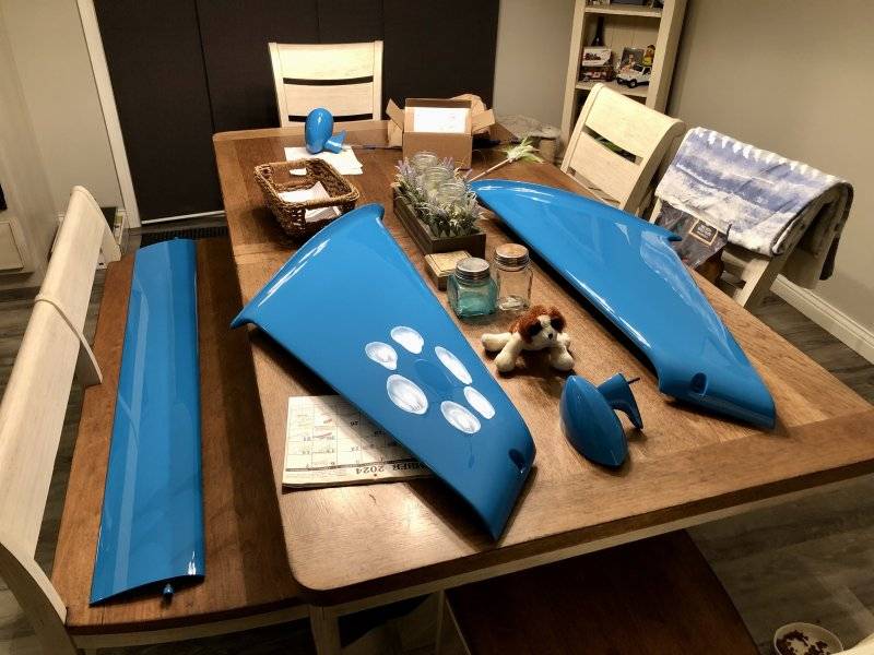

Love the color. It's gonna be monster on the strip & street!
It was originally going to be hot rod black, but I decided it was a played out fad. I went with a really bright color instead. My green car is currently 12-1400 at the tire so this will definitely be a monster at 2500ish whp.
