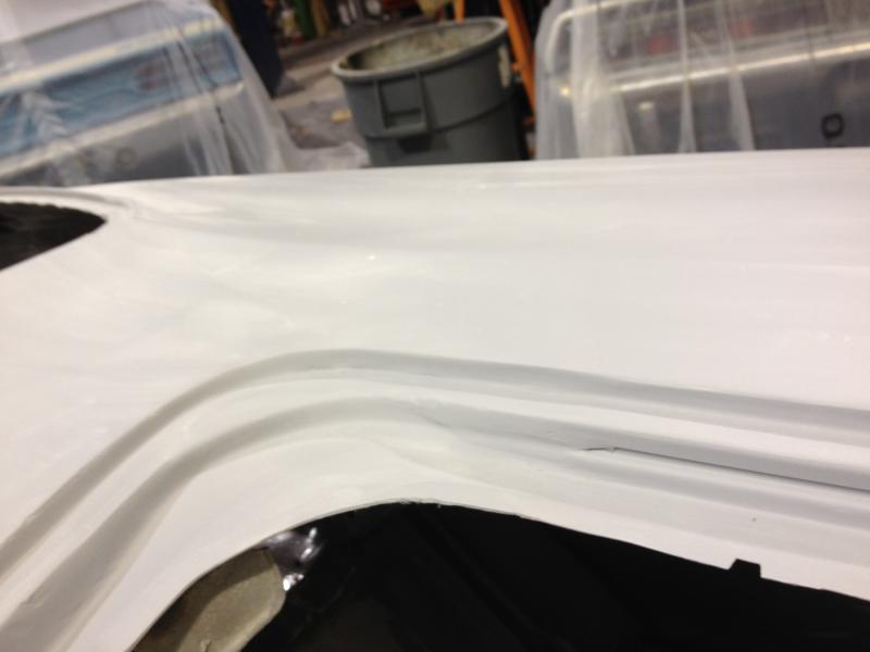

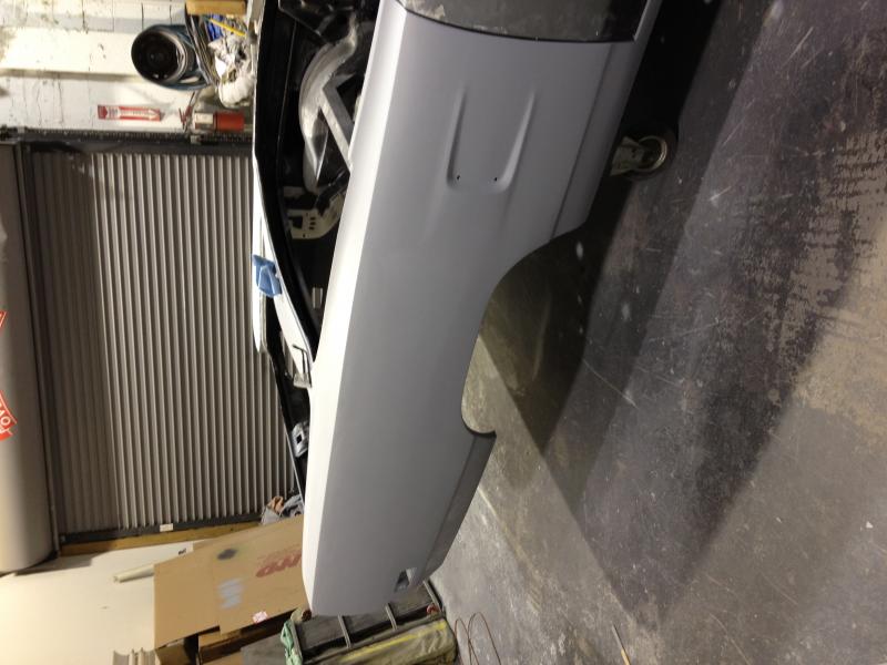

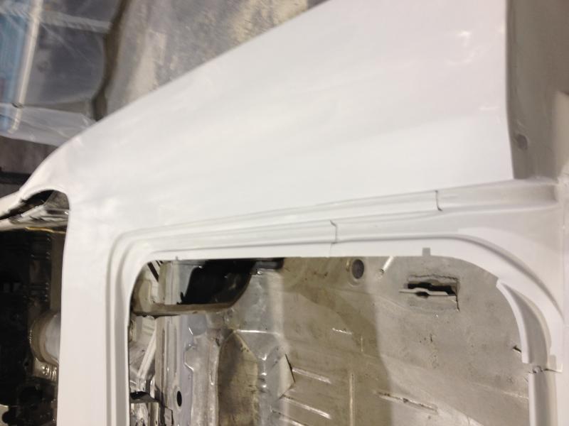

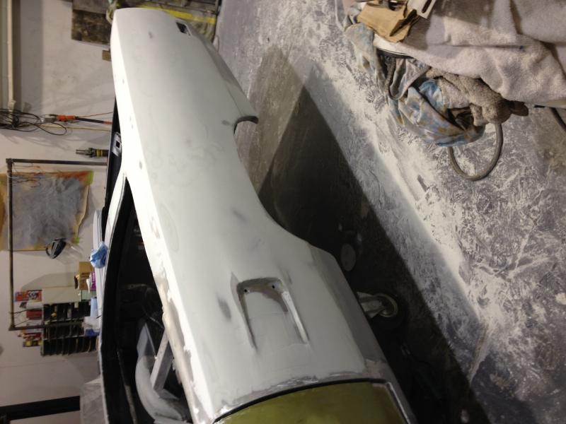

I finally feel like I am making progress. The 1/4s are coming out great.
Thats some great work, those quarters look real good...
Thanks, The problem with the quarters is that they were installed 15+ years ago. They were the old style of skins which did not have the top body line and were overlap welded on the side. It would have been a cleaner job if butt welded, that was then and this what I delt with. After 15 years they had developed some dents and they were hung not as nice as I would have liked with too many warps from welds and not as crisp lines as I would have liked. Another problem I had was that one side I had to partially release at the top weld because the top of the 1/4 had dropped when it was first installed. The 1/4 extension would not line up properly. I just did not want to tear them off to replace them. Skim coat and a lot of sweat was my only option. No one will ever know or care when the paint is on.
