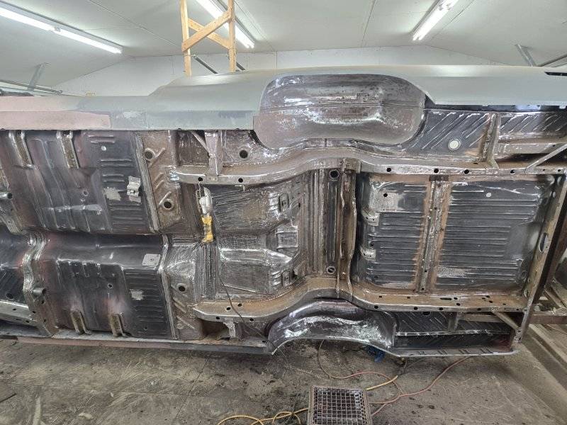

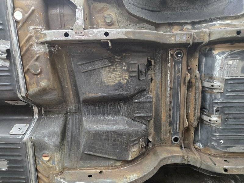

Exactly! I see so many posts about how it will cost $80-100k or more to restore some rusted Mopar and how it`s not worth it and people don`t believe me when I say mine will be done for around $30-35k . Even if you can`t or don`t want to do the finish body and paint there is a lot of work most anybody can do to save paying someone else. Fortunately since I replaced the trunk pan, extensions and full front floor pan there isn`t a lot of original undercarriage to strip and clean and on the rotisserie is much better than lying on a creeper with the car on jack stands which is how I did my Barracuda.

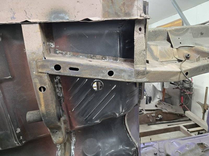

Third and last caved in frame rail repaired, somehow the passenger front escaped the wrath of all the previous owners floor jacks. :rolleyes: On to zapping up the holes from the self tapping screws used to hold the floor pan down tight and continue cleaning up the rest of the original floor and rails.
Ok so I understand the other areas on the frame rails being caved in as they are commen jacking points but why here behind the axle? Stupid previous owners or mechanic! I guess I should have inspected them better before I welded in the trunk pan as it would have been easier to beat out, oh well - back to pulling.

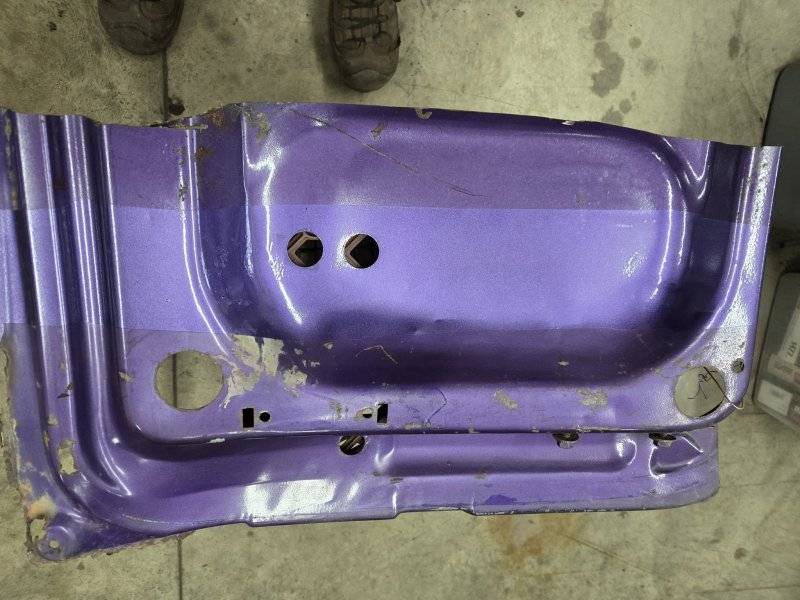

Getting close so decided to do a spray out of my sample of Tamco FC7 today, not at all happy with the match. The middle stripe is Tamco, the rest is factory original.
Ya, just a bit! I am expecting a phone call today about it and I`ll post the outcome.
I talked to someone at Tamco this morning and it didn`t sound like they were willing to try and adjust their formula for a better match which is dissapointing. The woman did say she would send me another sample jar to try and it is already on it`s way free of charge so that is cool. I sprayed out he first sample with my small jam gun at around 25 psi but she recommended 29 psi, I don`t think that will will change how it lays out very much but it`s wort a shot. If it still doesn`t match I guess my best option is to have it mixed by the local store I have been using for years but the only down side it will be PPG which is a lot more expensive. :BangHead:

Paint saga continues. I received another sample of Tamco and just as I suspected it was the same as the first one, I also decided to try a sample from Revolt. Tammy Miller is the daughter or the owners of Tamco and the company was named after her but she left a few years ago and now is at Revolt. Tammy is known for her customer service and when I showed her that the color match from the Revolt sample was off (closer that Tamco but still off) she told me to send her my sample part and she will custom match it. I sent it out yesterday and am hoping to have them match it by the end of the week. I will keep you guys posted. Meanwhile I am calling the underside ready for primer and paint! I`ll start picking away at the finish work on the inside floors and start working on the front frame rail/inner fenders/cowl areas while I wait for paint. Also if anyone has input on my correct finish question post - Correct finish for the bolt on dual exhaust muffler hanger on a `70?

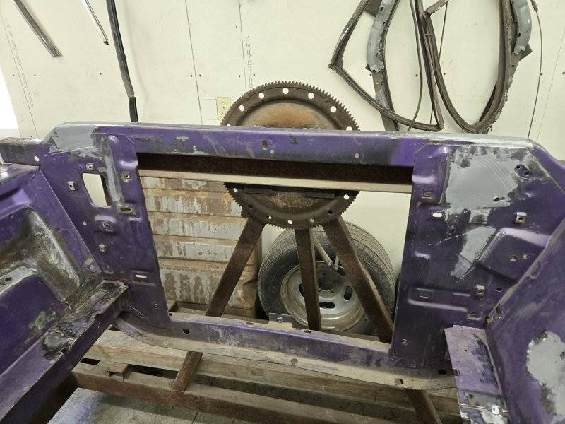

Engine bay is done as far as welding and grinding all the extra holes and a couple damaged areas, skimmed with All Metal.

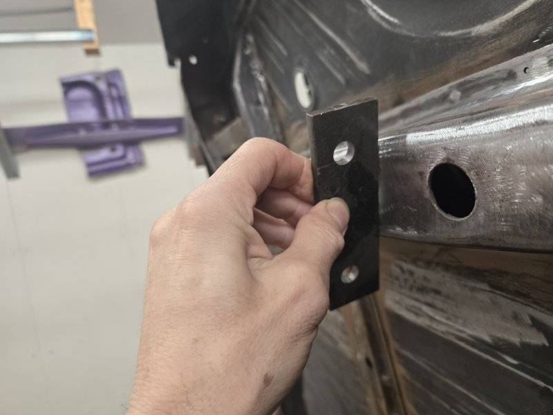

Drivers side exhaust hanger bracket sat in acid for about a week and came out clean with only light pitting, I'll give it a light bead blasted and get it in primer. I was told the factory finish is zinc chromate but I'll try to make it look close using paint - anyone have tricks?
