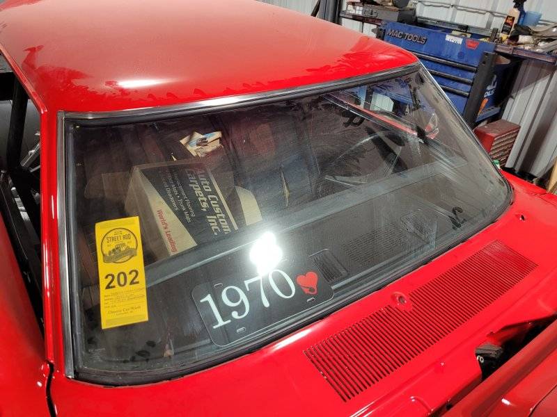

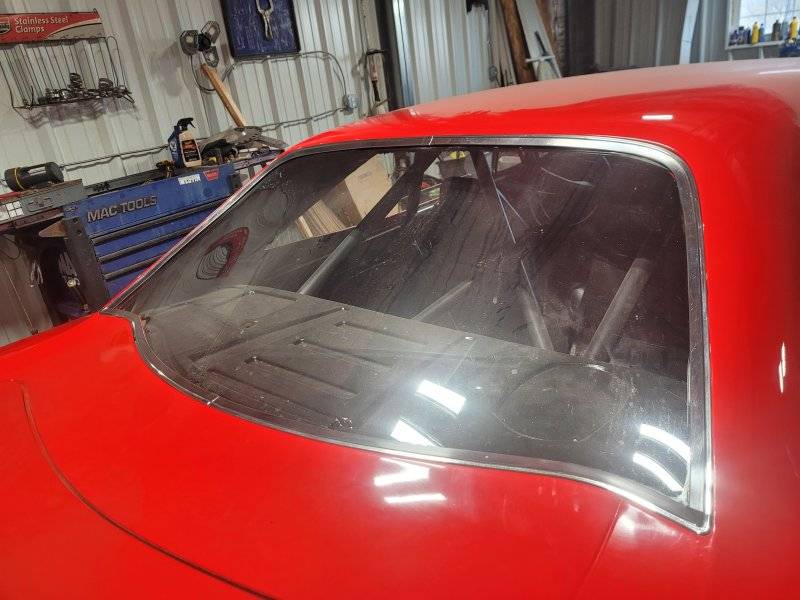

Got a little more done today put rear window trim on and front all but the bottom piece because hood stripe is not done.

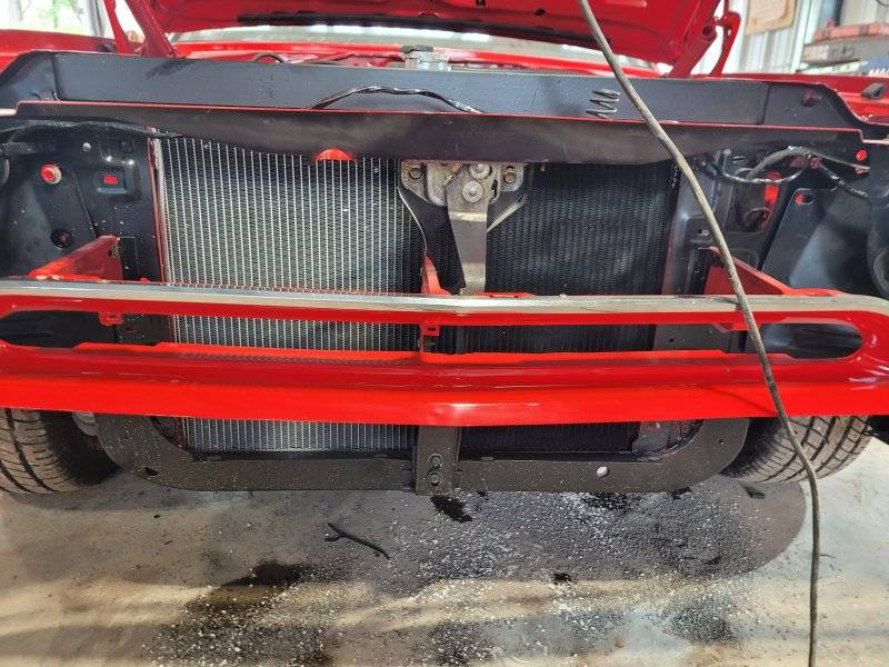

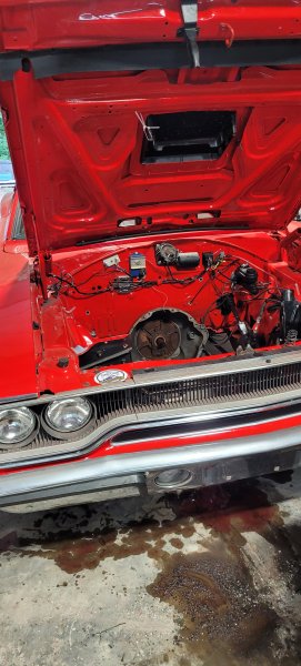

Well fixed the power steering, easy fix and the carb flotation came unstuck on its own! I have the exhaust scheduled for Tuesday and I blacked out my aluminum radiator, been bugging me. Also attached bumper loosely to try it out. I going to sell it anyway because I have a rechromed one being delivered to me at Carlisle Chrysler show.

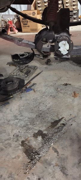

Ok I have not been around for a while, so I took the car to get the exhaust done and decided since it was 15 miles and just back roads I'd drive there taking it slow because of 5:89 rear and straight longtube headers arrived fine. They said fire it up drive it onto the lift, hit the key nothing, thought battery was down so put jump box on and fired up on lift now let's get started. Well first the Pypes exhaust system wouldn't work out, because of tubs and shock locations. So had to leave it and go with custom setup, went back next evening to get car and brought my trailer. They said it was making a noise, sounded like fly wheel rubbing, didn't make it all the time. Exhaust sounds good, nice work, asked helper to watch me as I loaded, what a idiot kept waving forward then felt something stopped asked what it was he let me scrap bottom of passenger fender on trailer fender. Arrrgh!! 40 something and doesn't pay attention. Well got home unloaded, screeching started again, looked at flywheel nothing, decided to pull into garage oil pressure drops wiped bearing, I haven't had desire to even look into it until the other day. Heres where I'm at now.
Well remember I had the float stick ,I checked on the oil didn't think it was hurt but was wrong , what a stupid thing. Oh well I will check it out this week and see what I need to do.
Well got the engine tore down so far rod and mains, of course need to have crank turned, but everything else is ok . So new rings,gasket kit,and oil pump and then back together, still sucks but could have been worse.

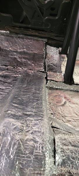

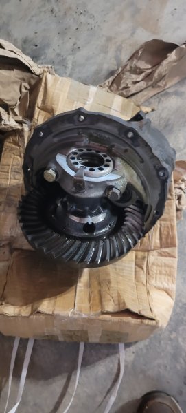

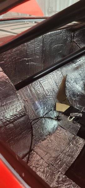

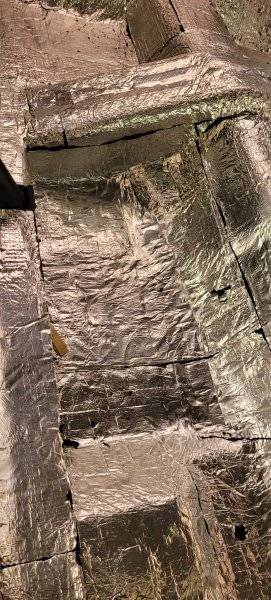

Well I have been trying to get ready for Carlisle, I want to take my car, put in some sound deadening in,removed rear differential, switching ring gear and pinion to a 3:70 ratio. I also got some thin sound deadening mat for the door and rear panels areas.

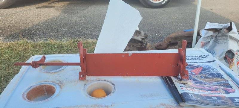

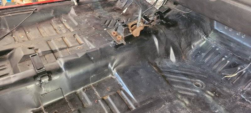

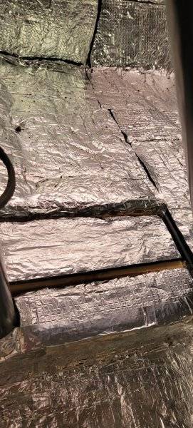

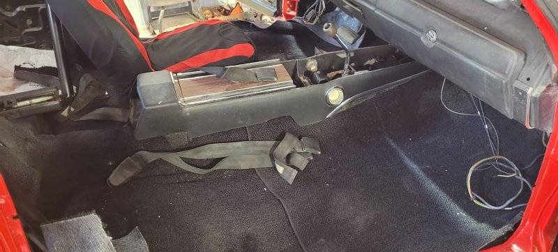

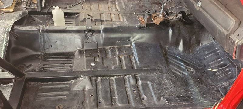

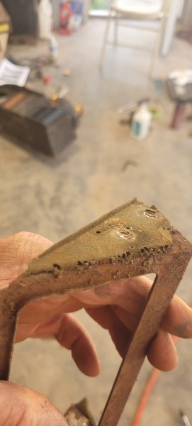

Well waiting on parts ,so did more insulation and then leveled the floors because of the 2 tubing that was put in to stiffen it up and laid carpet to let it conform. I also started to repair my heater box. Tired now. I forgot I installed the console brackets tacked them in and painted them.
I cut 2x4 and a 2x12 to fit into the areas that were low and stuck a layer of the sound deadening mat on it, working well.

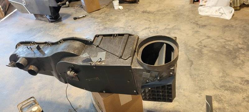

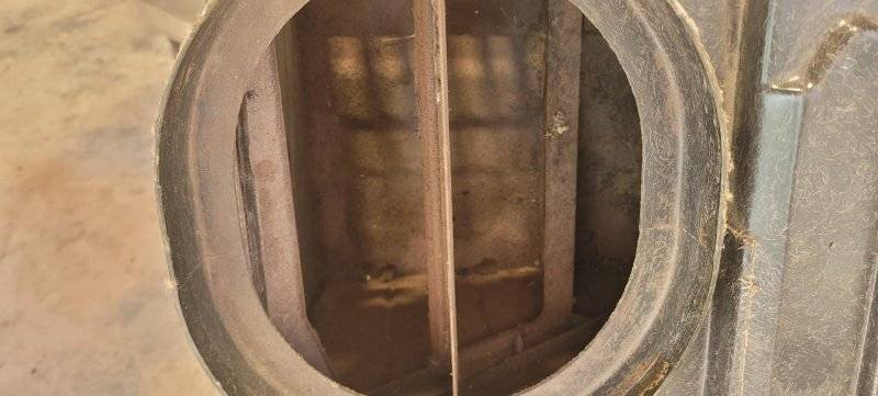

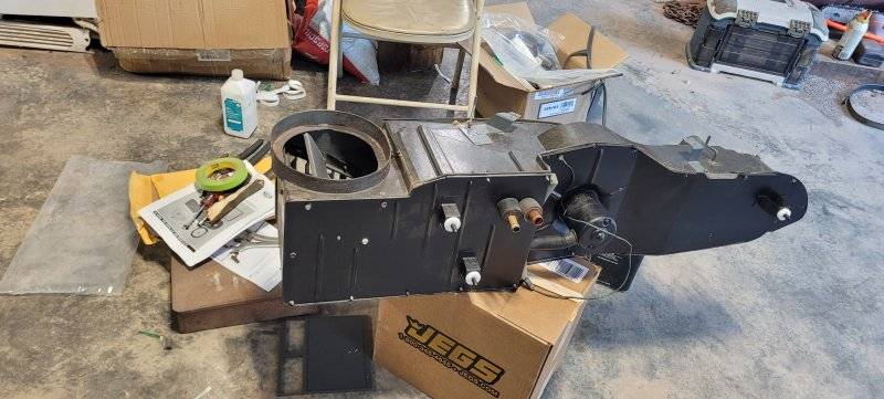

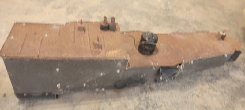

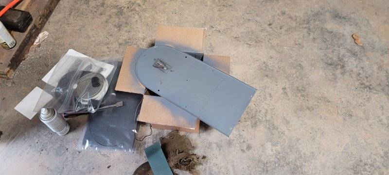

Working more on the heater box, my heater core is bad ,ordered one from Jegs,only one who had it in stock.

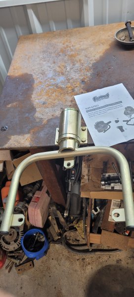

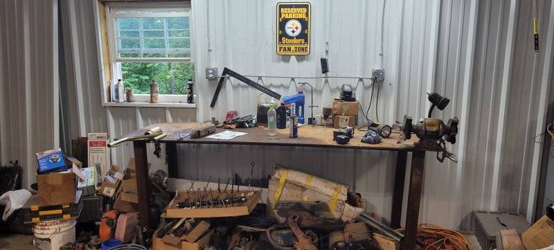

So I have to wait for heater core to finish restoration of heater box so I, cleaned up the shop and organized some stuff. Then I installed my differential stand, so I can start working on it changing my ring gear and pinion from 4:55 to 3:70 ratio.

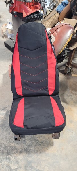

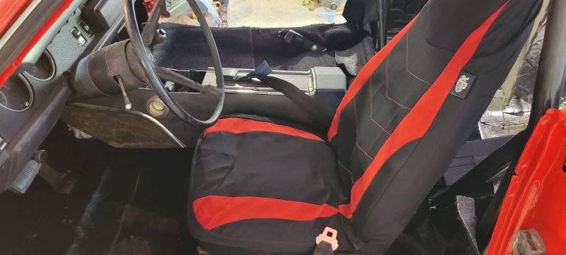

I also slipped on the seat covers, just temporary ones, until I get new foam and put the legendary oem style on.

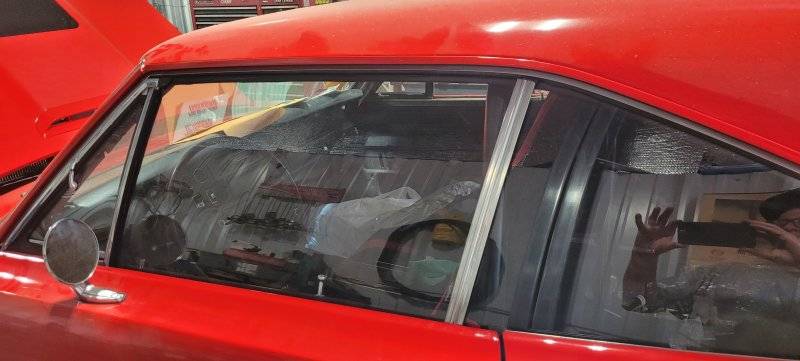

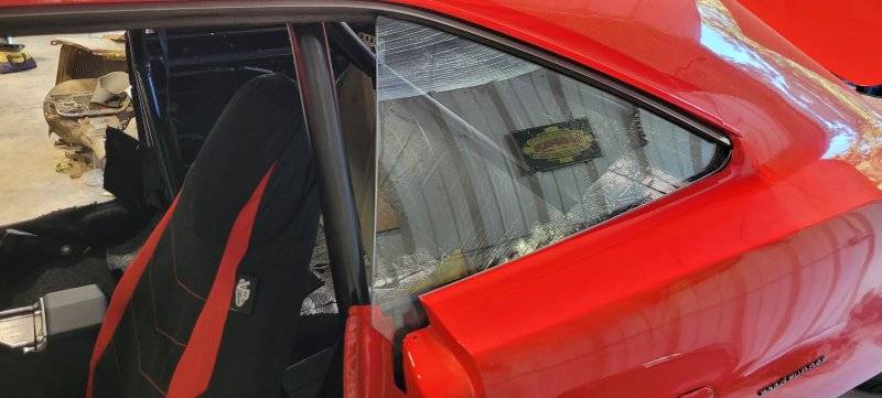

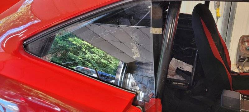

Well I installed the quarter windows, went well but because of the tubs they won't roll all the way down. I also put in front seat belts and console and drivers seat.

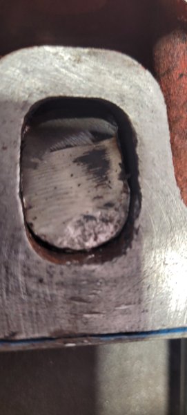

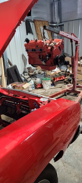

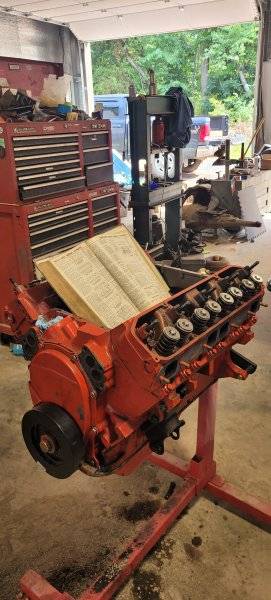

Got my engine assembled, probably get to put it on my run stand tomorrow, blocked off heat chambers on the heads ,cut a 3/16 plates and welded them in.

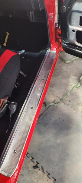

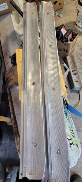

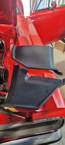

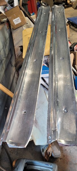

So changed my focus to door sills,kick panels, finish carpet, and door windows installed.
