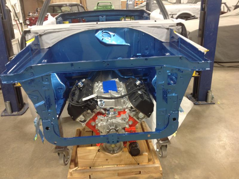

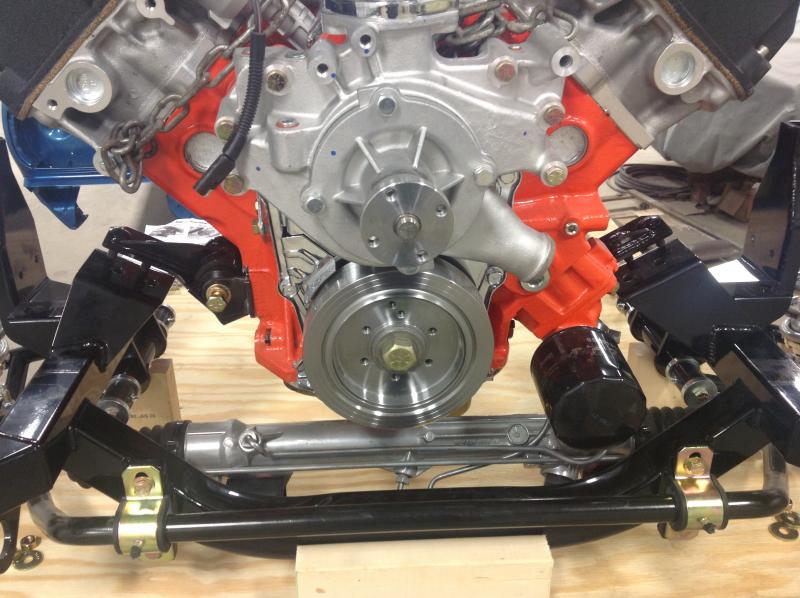

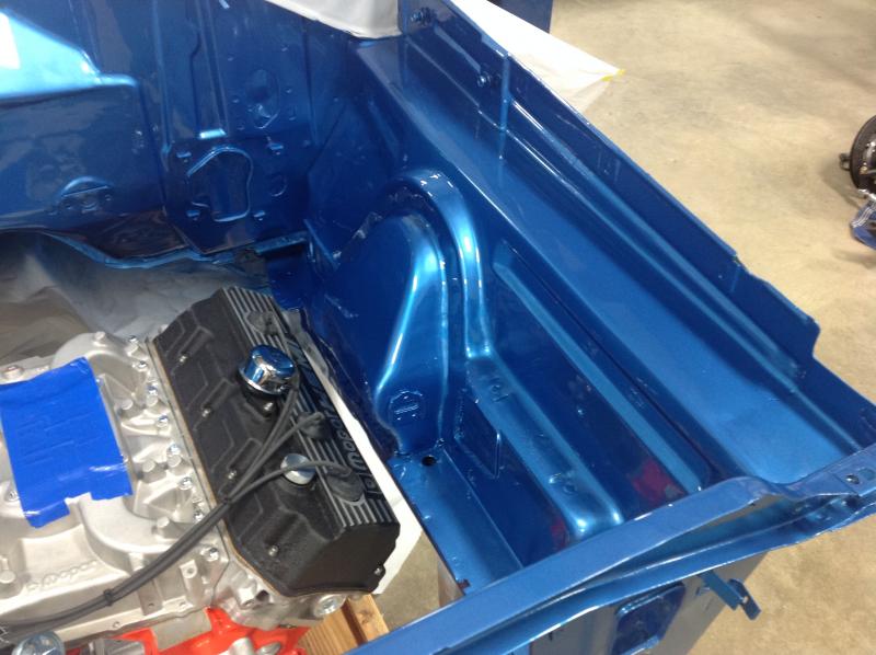

I think we are going to have to take valve covers off to drop body down

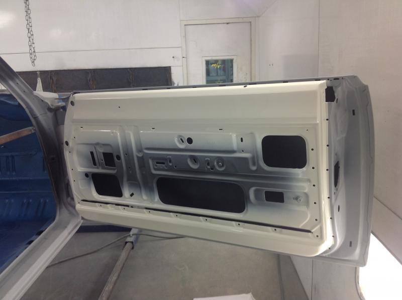

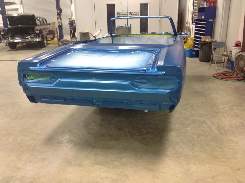

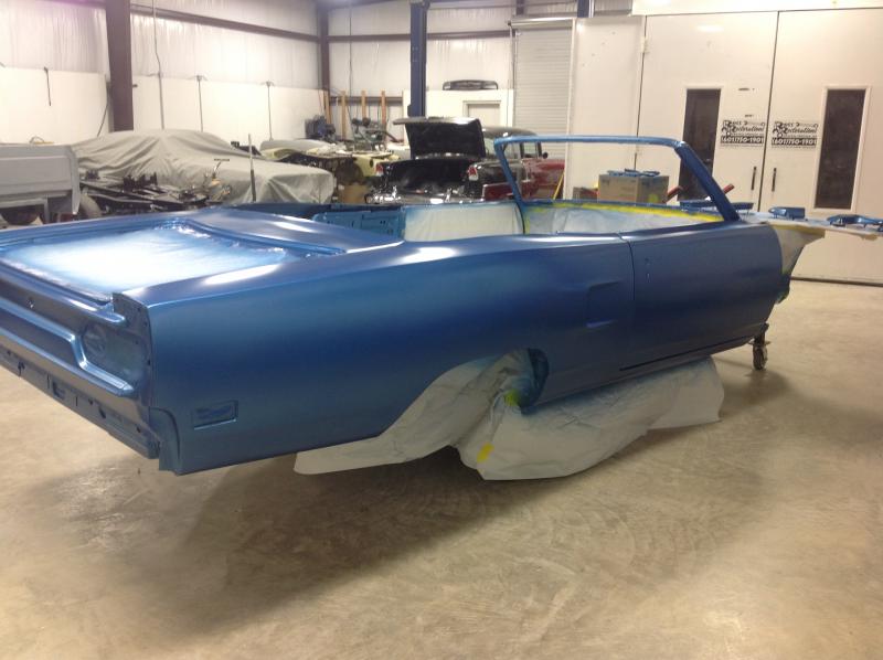

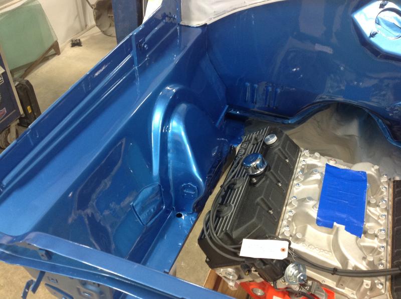

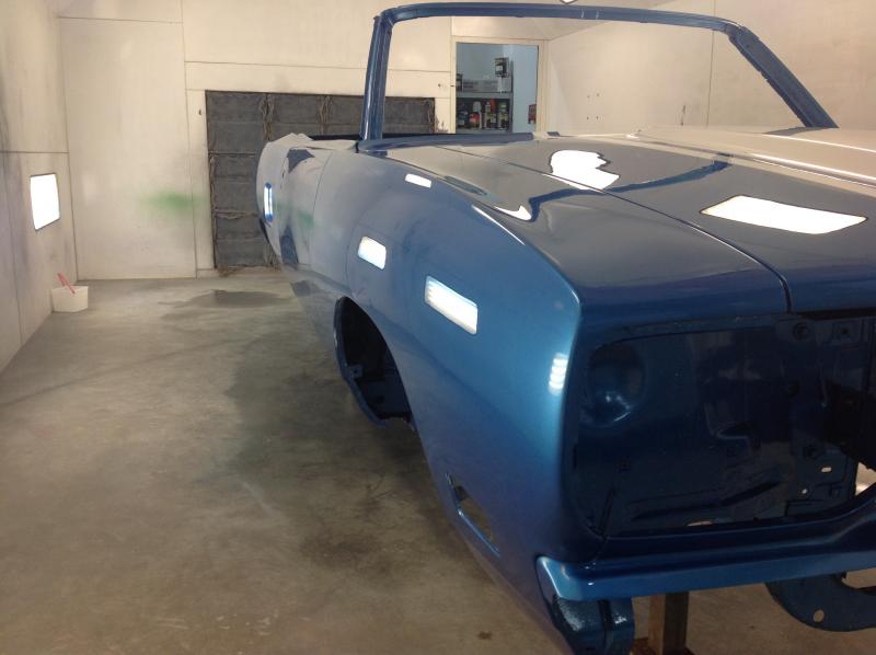

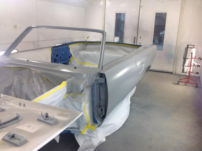

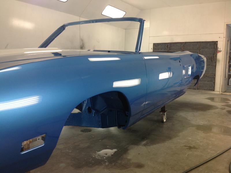

Have just about caught up with pictures of the progress so far.

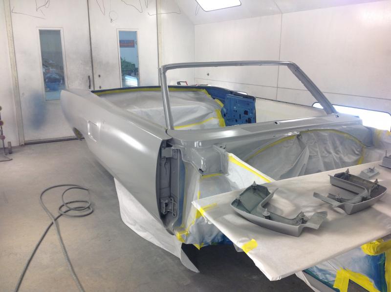

We started tearing the car apart in January of 2013, it was the end of September when we took the car to be stripped, at that time the stripper went ahead and did the parts so my builder could start working on doing repairs to them although there was little to do with deck, hood or doors. January 21 14 is when car was picked was from being stripped. once we saw bare metal we put in complete floor pan, wire covers, trunk pan, trunk extensions, inner outer wheel, tail panel, lock support, and two partial quarters along with some rail repairs. Car went back to stripper for derusting on 5/21/14 and stripper transported to the ecoat facility. We got the car back from ecoat on 7/30/14.

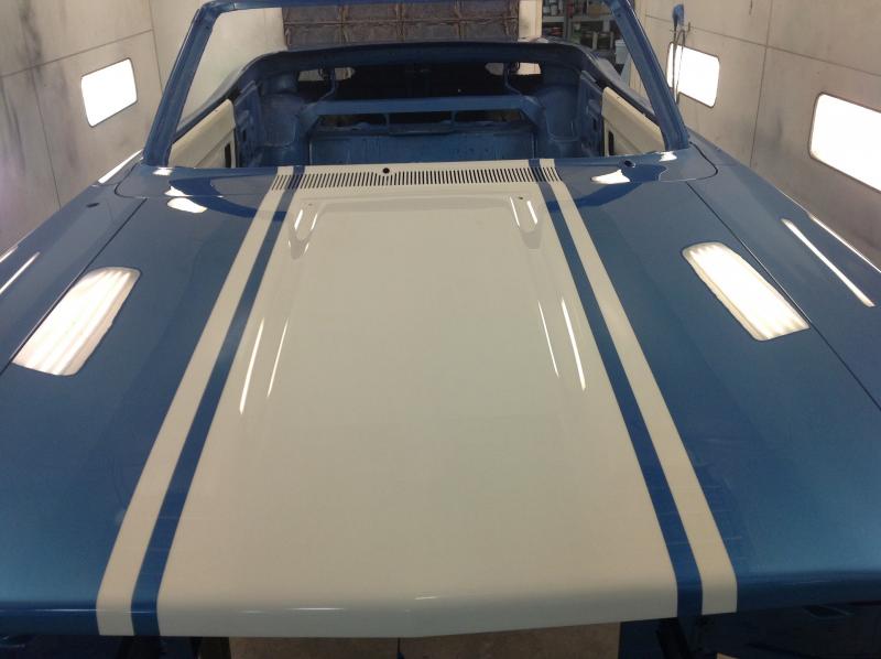

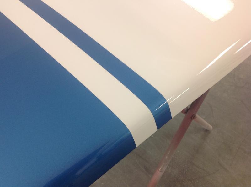

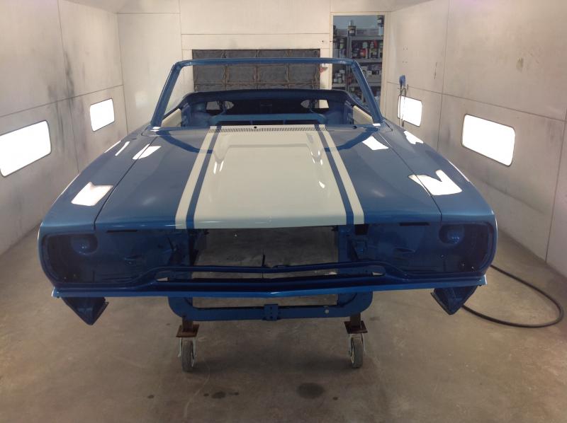

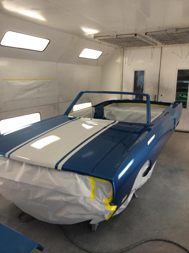

This Chevelle was my favorite car. It was destroyed in an accident in October of 2012 coming home from cruising the coast in Mississippi. We were in our Blue Bird Wanderlodge when we had a steer tire blow out doing about 75 mph and made sharp turn left into the median went air born and totaled the bluebird, a 4 month old aluminum trailer, the 70 chevelle and also broke my back. Better half was with me and she got a little banged up. If it were not for the bird we would be dead. I am just giving you a little history because I know some may want to give me a little grief for putting the white stripe on the hood of the RR, I know the performance stripes are suppose to be black but the better half loves the white stripes so we have white stripes similar to the chevelle.
Tried to upload a scanned picture of the chevelle and it did not upload will try another route later
If you're not doing an original resto then you make 'em how you like 'em. (or in this case to keep on side with the Mrs. lol) Keep up the good work RR528, it's looking great.
Sounds like you and the better 1/2 were blessed in that accident! I cant speak for anyone else but me,,,, but to be honest, the white brings the blue out better and "really" looks great!!! Im glad ya listen to the wife!!! That is one pretty ride you have there!!! Enjoy that gal.. and of course the car. :)
Don't know how I missed this. Your transformation on this bird from where you started is simply amazing. I agree with Ron, that white stripe does bring out the blue better.

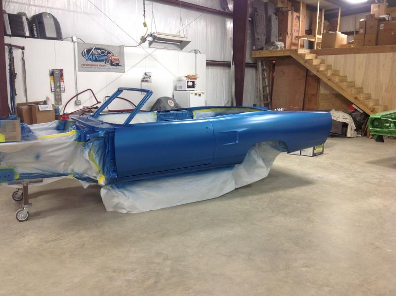

Suppose to be b5

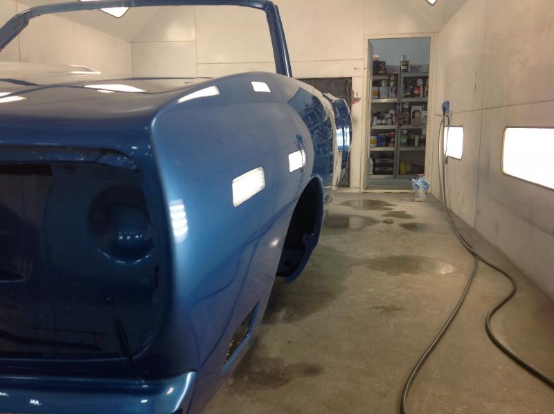

Have not seen paint in person yet it is 400 miles away
Was going to see this weekend but my builder says he will get drive train in next week so I decided to wait on that

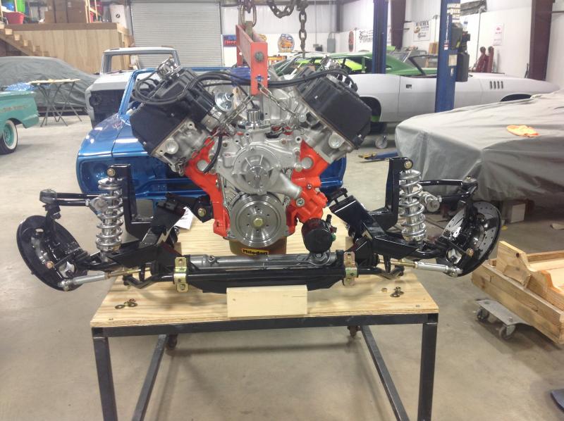

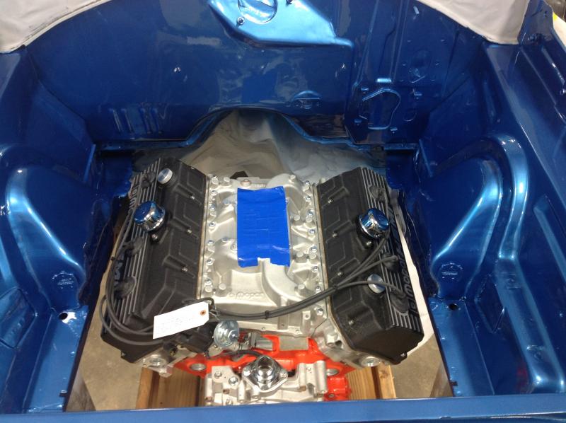

She's a beaut and boy is that one sweet looking motor your putting in it!
