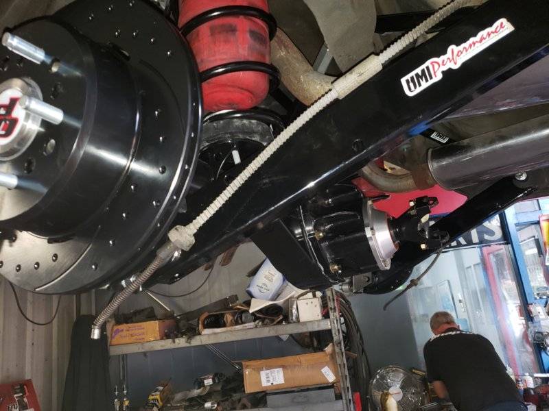

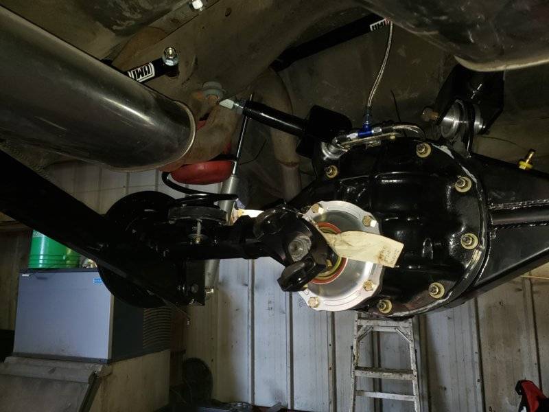

I got the Ford 9" based rear axle assembly from Quick Performance for my wife's GTO 421 Tripower 4 bolt main rebuilt and souped-up bruiser.
I also added at least $1,000 in upgrades, and I won't ever worry about it breaking, and that is behind a 4XX HP and torque motor with a standard transmission.
The pinion is offset by QP to align with the factory location! Very important!
I also saved at least $1k over Currie, Moser, etc etc and I would compare the one I have to ANY of those manufacturers for quality, strength, and performance.
