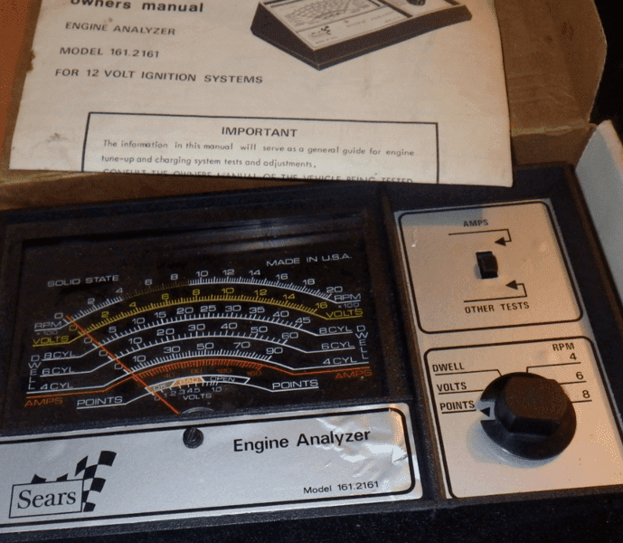

Lol, that video reminded me of one of my relics...…..
