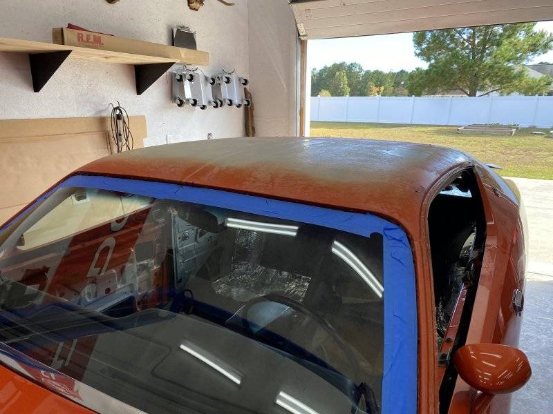

I found that running a red scotch brite over the paint before spraying the glue helped out with adhesion. Also, I would lay it out and fold it in half then spray half the roof and back of half of the top, then et it get tacky and apply the top and work it down. Then repeat for the other side. If this is how you do it, sorry for the redundancy!Couple hours outside and it peeled right off. Now to clean up the sticky mess.
View attachment 1361866View attachment 1361867

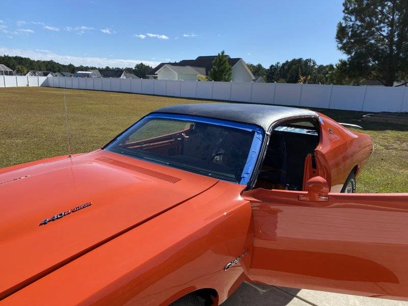

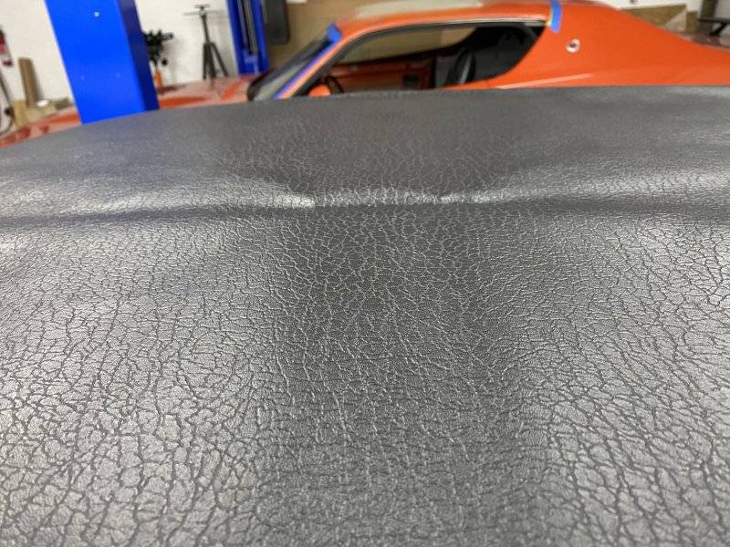

Very nice! Yes, the wrinkles suck. Setting it flat in the sun helps.Ordered a new top Saturday and the thing showed up on my door step today. The fastest order I have ever gotten from Legendary. They must store the material folded as these creases seem to have been there awhile.
