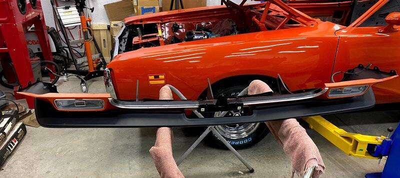

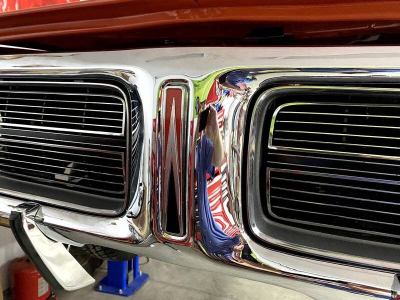

Scored a NOS bumper emblem on ebay for $50. Just installed it.

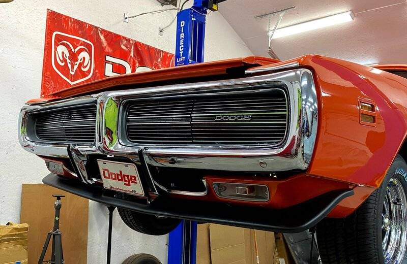

That grille looks fantastic! Nice work!
Thanks. There are pits in the pot metal and a PITA to smooth them out, mask paint and polish the outer edges. Its a 10 foot grille but I am OK with it. Will have it all buttoned up this weekend.

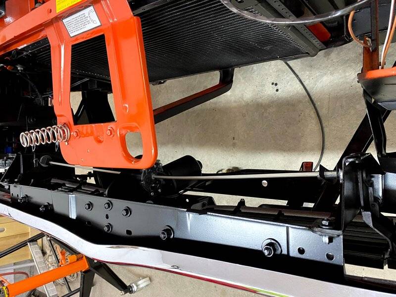

Bumper is all adjusted. Head lamp motor installed and tested. Assembled the front valance and installed. Time for grilling and beers!

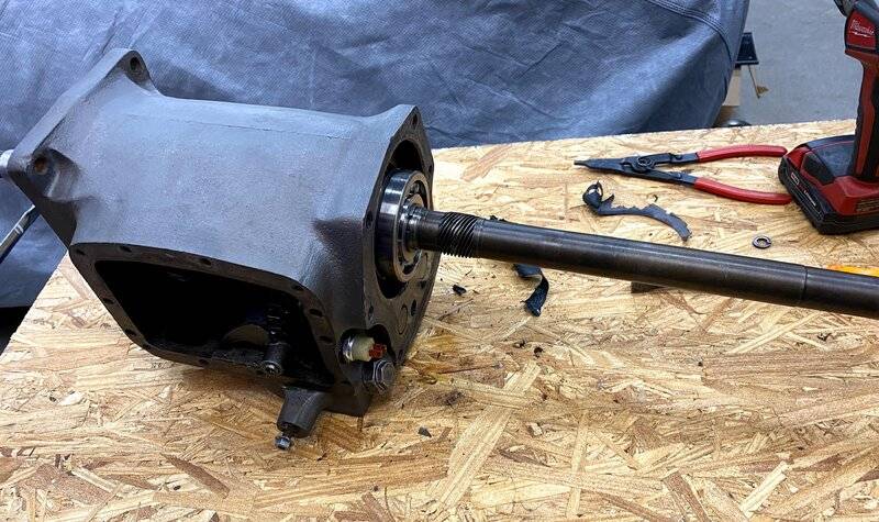

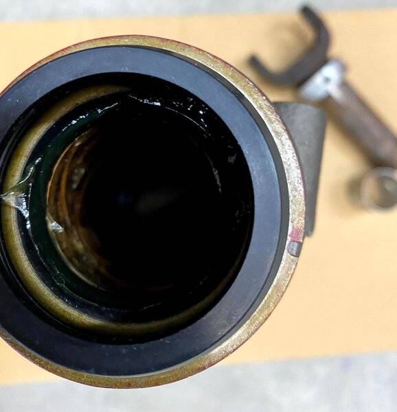

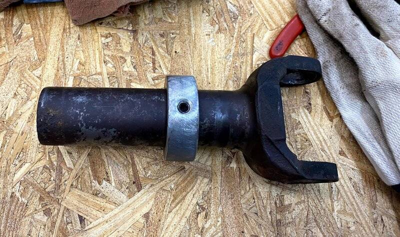

Pulled the transmission back out today. I was installing the drive shaft and was not happy how tight the yoke fit into the trans. Carefully pulled the tail shaft and drove the bushing out. Used a old yoke with a collar installed to drive the new bushing in after I froze it for a few hours. New Dr. Diff yoke slipped right in after that. Now to pick up a couple gaskets at Carlisle before I can put it back in.

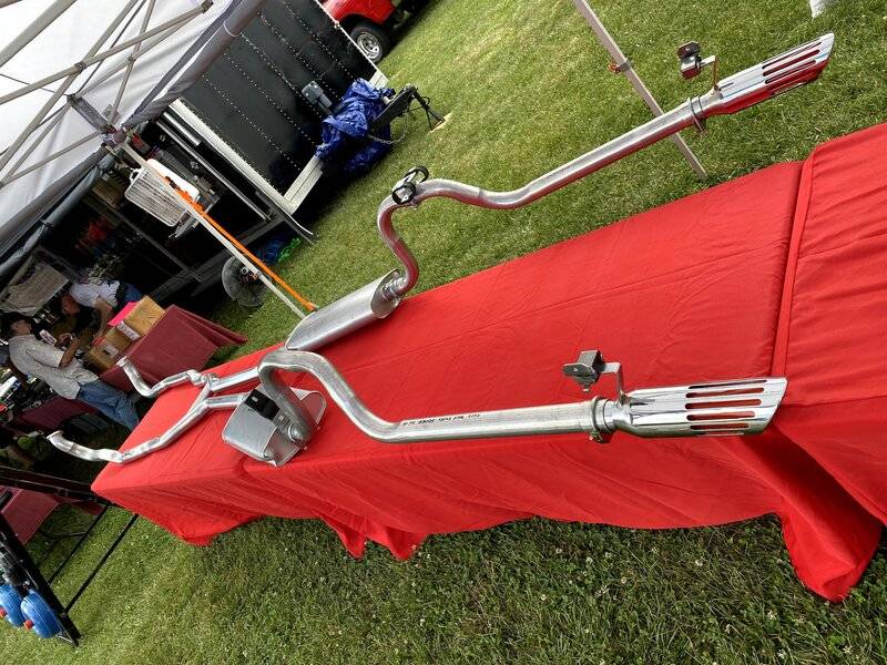

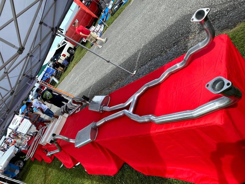

Picked up my complete exhaust system from Don's Custom Exhaust at Carlisle. He had it on display when I got there.
Damn that looks nice - Even the hangars look beautiful and original

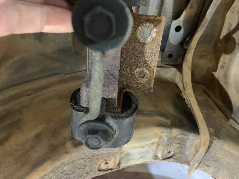

Curious question......where does the passenger side hanger get attached?
At the top of the wheel opening. There is a bracket that it mounts to that's attached to the shock mount.

That's the same bracket that I have on my 1971 Clonerunner.
I assume all Satellites and road runners have the same bracket.
Looks like I will be looking for the same hanger when I go to purchase the exhaust for my car.
