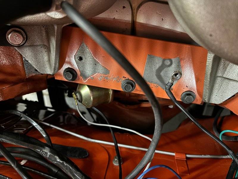

I made a plate and mounted mine on the rear of the engine for my 71. I ran an additional ground from the mounting bolt to the firewall. You can see it hiding back there.
Been there 2 years no problems. I do keep a spare in the glove box. There is an air gap under the plate as it sits on top of the valley pan hold down. I can get a better pic later.
Here is a shot looking down at it and the plate it self. It's 3/16" flat stock drilled and tapped 1/4"-20 to mount it.
