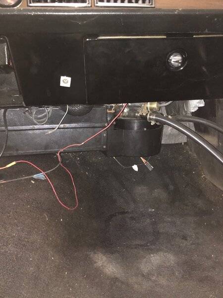

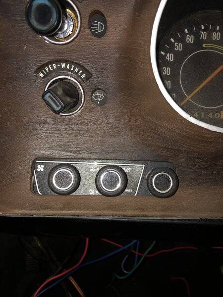

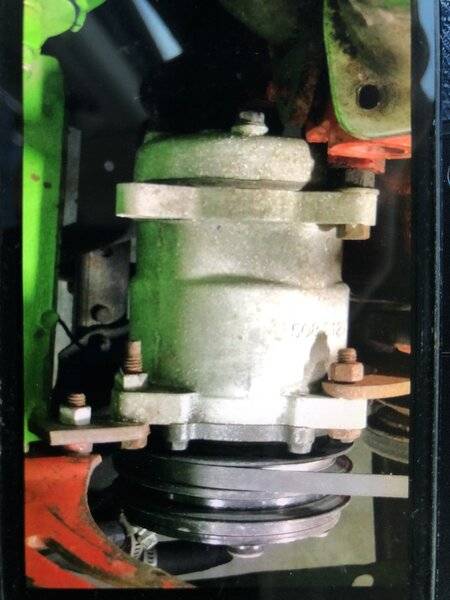

Do you have any information on the aftermarket A/C setup you have? If money becomes available next year, I have been wanting to possibly set up an A/C in my car but didn't want to modify the firewall and it looks like yours uses the factory non ac spot. How does the inside look if you have any pictures of the controls and routing.
I’ll get you some pics and info this evening. I’ve never bothered to figure out what brand A/C it is. It will freeze you out though, once the cabin is cooled off I have to run it on the first blower speed setting.

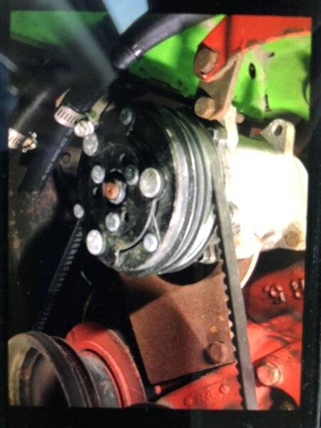

Here’s a couple of pics I dug up before I pulled the engine and a few pics under dash and of the controls. The kit used a Sanden 508 compressor, guess that’s pretty standard for aftermarket. The compressor mounts underneath the alternator, the bracket I have almost looks homemade though. It wasn’t painted and covered in surface rust when I bough the car. I’m doing research now trying to figure out how hard it would be to convert over to a serpentine driven system. If I figure out any more info I’ll pass it along to you.
View attachment 1006133 View attachment 1006132 View attachment 1006131 View attachment 1006130
Thank you, That helps a lot!

Converting to a serpentine driven system is pretty simple, but expensive, and usually does not leave room for a mechanical cooling fan.
