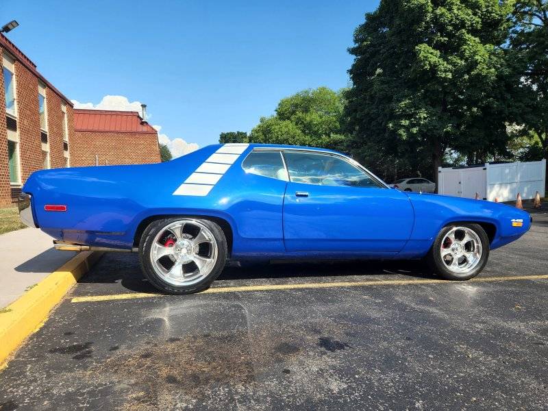

Thanks for the compliment. I agree it looks a bit off. It's actually fairly level and the pinch seam is 3/8" higher in the rear, but it certainly doesn't look that way. I've got 18's in the front and 20's in the rear. I'll probably go higher in the rear eventually. I just needed to get the front where it needed to be so I could get it aligned.
Interesting, I've also got 20's in the rear and 18's up front. Do you have RMS front and rear, or just front? I have a rebuilt K-frame/T-bar up front, but a 4-link in the rear. I've got Doug's headers with no ground clearance issues. Only clearance issue I have is the darn 7qt Moroso Oil pan the P.O. installed. I was going for more of the 70's Raked look, as opposed to a more modern look. Must say I do like the lower, sleeker, modern look your ride is going for.
If you're going to raise the rear, do it before the alignment... changing the rear height changes things up front.

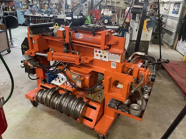

Get yourself a bag or two of those. I may be doing them plus some oval down the road on the 65 when it's time for exhaustion.:lol: Way better than trying to pie cut the pipe doing the cuts.

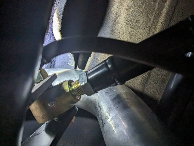

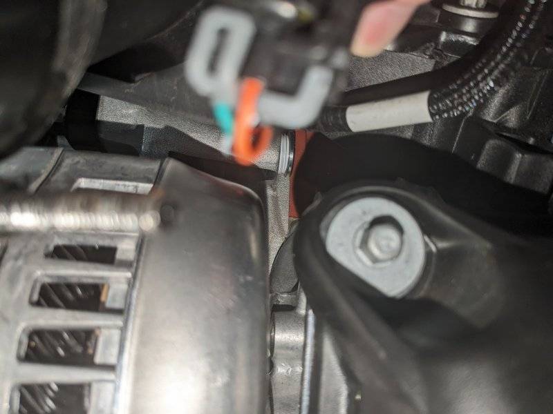

I retaped my coolant plug and tightened hard for good measure. After a 5 mile drive, I could see a small drop still coming out. It's dry in the picture below but you can see the leak path.
I'm not sure why it's not sealing. Part of me wants to put some stop leak in the reservoir, but it's all brand new so it shouldn't need it. It may be a slow enough leak that I can ignore it for a while. Next up is AC hoses or seat brackets.

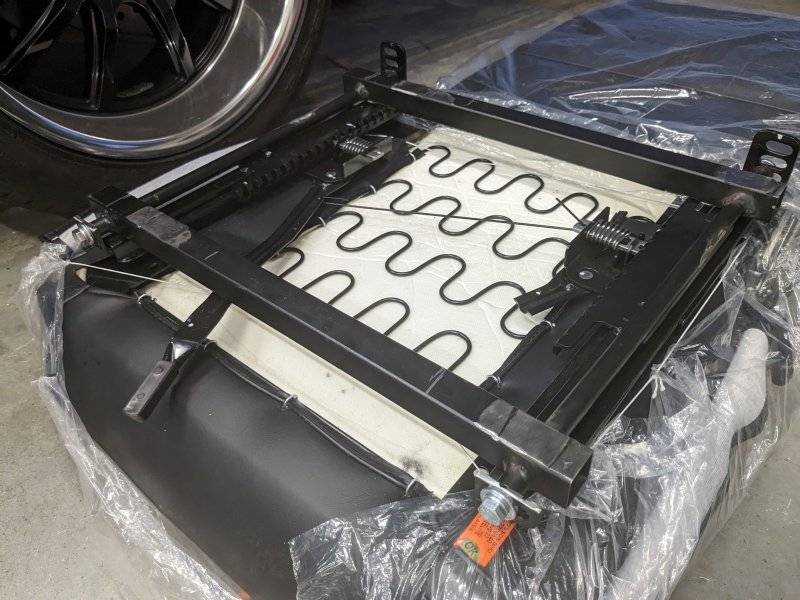

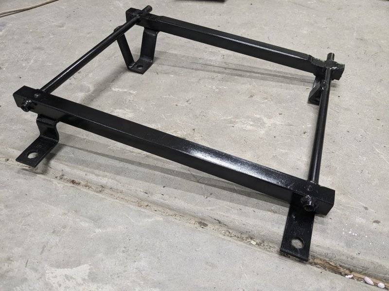

I started working on installing my Procar seats. Unfortunately they don't make brackets for the 71/72. The ones they do sell are for a 68-70. I had to cut off the legs and make my own. Additionally there's more modifications necessary to use the lowest seating height. Even still it's a bit high, but it'll work. Here's a picture of one in progress.

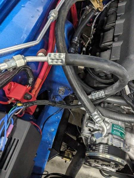

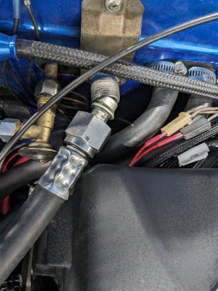

I grabbed my AC lines off the old 318 in hopes they would work. I was thrilled that the thread sizes matched since the compressor is in roughly the same spot. Unfortunately that's not the only thing that needed to work. Oh well.

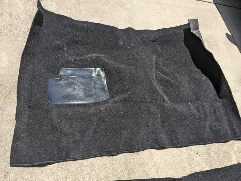

Got my Essex mass backing carpet today and was disappointed to find the high beam bezel/cutout wasn't included. Any tips for how to add one?

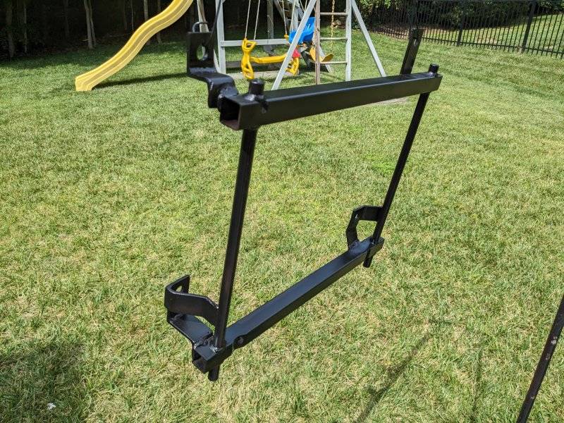

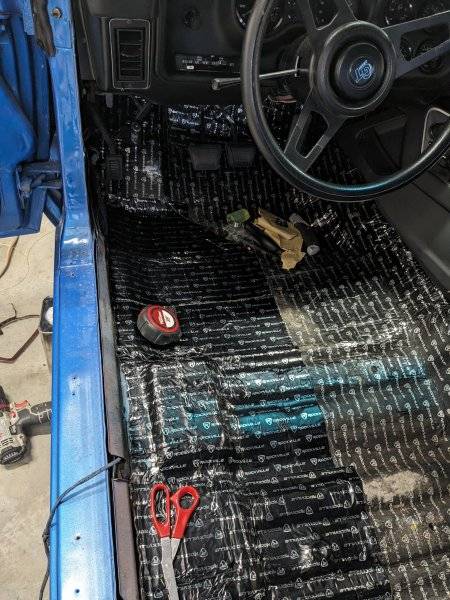

I got one of the frames completely done today and got the sound mat reinstalled on that side as well. Just need to duplicate it for the other side.
I got the second seat frame finished today. Since the tunnel is offset, it makes for some interesting mounts.

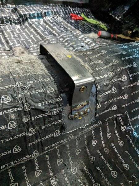

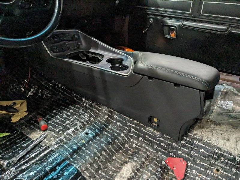

I also got the rear console mount finished. It's very solid. I had to clearance the underside of the console a bit to get it to lay down against the tunnel, but nothing too bad. Still need a front mount. Excuse the welding. I'm still a noob and the grinder is my friend right now.
