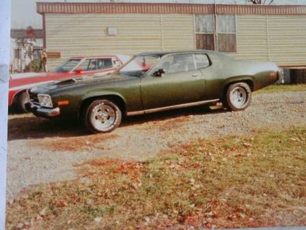

I found it out of a company in Oregon. Took 6 month to get it even before covid, I think they had to make the material or something. I almost gave up. They did communicate well. PM me and I can help you find them.
Mine is in good shape.
I was just curious as I've never seen that style listed for sale.

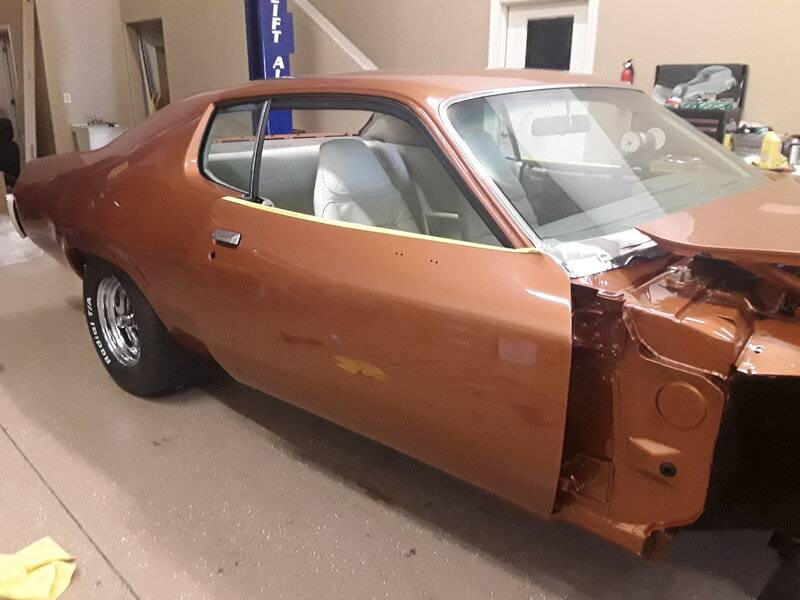

I was able to get back down to AZ to get some more work done.

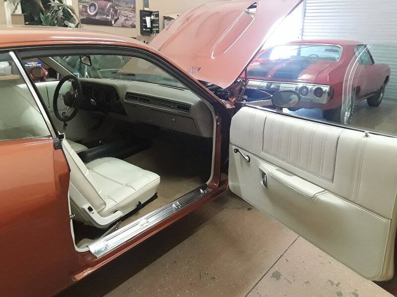

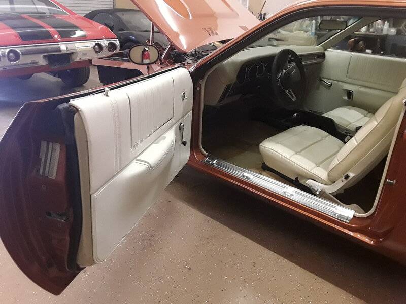

Got the front moulding on and finished the interior trim.

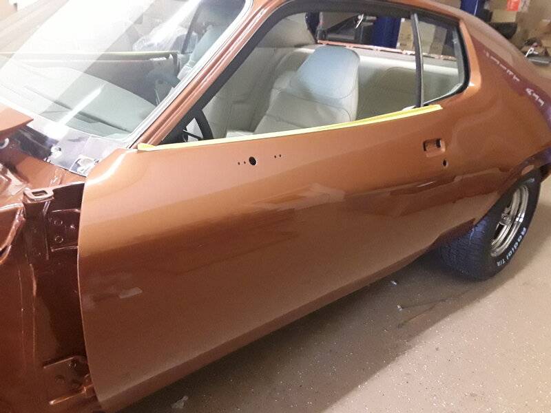

Got the doors on and adjusted. Thanks to Builderguy, installing the door bumpers before you close the doors was a great tip! Definitely saved the paint.

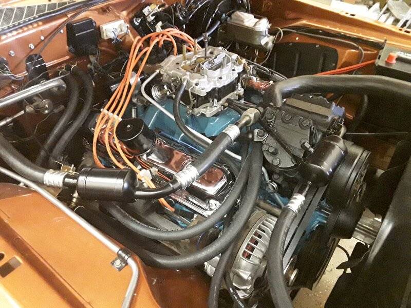

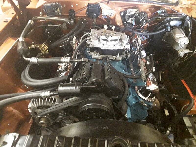

Finishing the accessories for the engine compartment. Getting close to adding fluids and a battery then firing it up.
I am struggling with the window regulators, they are really binding and won't move up or down. I ran out of time this trip. Could use any tips and tricks, I am also thinking they may just be plain wornout. I cannot find a rebuild kit for a 1973. Will other years work? Thank in advance!

Any thoughts or pics on the regulator. Maybe I got something mixed up between pass and driver side. It was a long time ago when I took them out and my pics are not helping
If I haven't said it already, I love that color combo.
Do the windows go up and down freely in the channels without the regulators?
Do the regulators wind freely without being attached to the windows?
I did not try the windows in the channel yet.
The regulator binds up after about 2 inches from the bottom going up. I try to help it move up but it just gets jammed. Tried loosening the bolts in different combos, top loose bottom tight vice versa all loose all tight. Also 2 of the round guides on the top horizontal rail broke off so I replaced them with the square style.

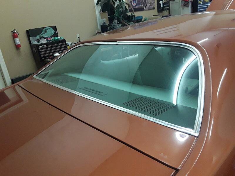

So I have good news and bad for this last trip to work on the car. I was able to get the window regulators, windows and latch assemblies installed and working. I decided to start from scratch on the driver's side since I was having no success with the passenger side. Got it installed and working in one shot. I duplicated the sequence on the passenger side with success

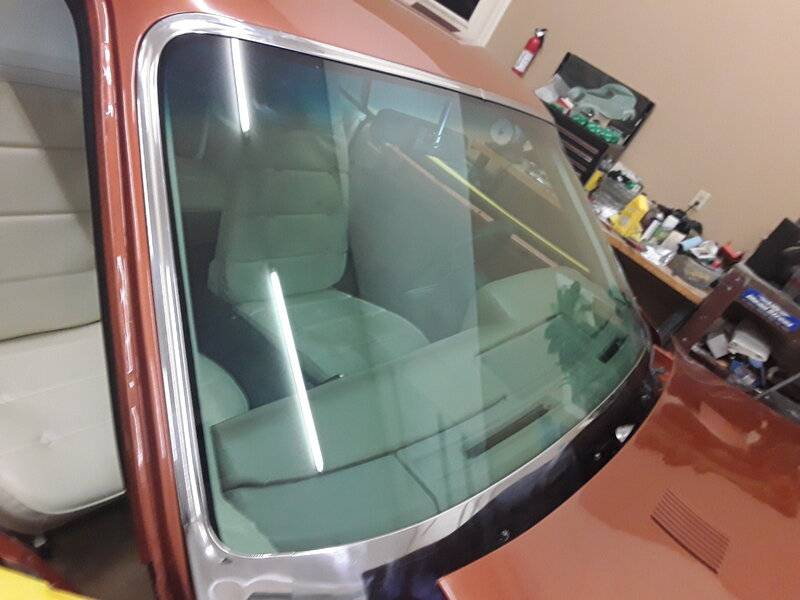

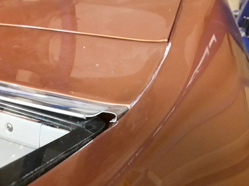

I had removed the rear window after reinstalling it last trip because the moulding would not fit correctly I thought the window was too high in the channel. Once we reinstalled it and immediately installed the moulding everything fit properly.
Before
After

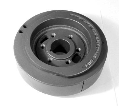

Just so we are on the same page, your 1973 340 should have came from the factory with this HB (which is for the cast crank).
Next, your torque converter should have came from the factory with weights attached as the cast crank requires this. You can use , or so I have read, a neutral balance converter (no weight) with a cast crank motor if you get the correct flex plate from (say) B&M racing. A lot of converters now have no weight, Chrysler sells the weight and a template so you can weld it on yourself.
I guess I am not understanding what the shop did. If they balanced everything, as written, there should not be an issue.
Since there is an issue, something is not compatible. Not quite sure but I will keep thinking about it.
As for your questions, I have never tried that, and would be hesitant to do that; but that being said, I would defer to those with more knowledge on this.
My HB looks the same as your pic, the TC does have weights on it. I agree it sounds like he did everything correctly, mind you I am going by what he said was done, it is certainly possible someone made a mistake. Thx
