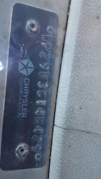

I have a real strange car. I bought a 73 charger. I sent the WY title in and the state of South Dakota rejected it and threw it away. They said the numbers were wrong and that is all they said. I did a Vin number search on it and it comes up as a 73 Coronet? This was the same number that was on the title and the title listed it as a 73 charger SE. I know the title was from years back but what the heck?? I also know the Vin looks to be unchanged. The rivets look to be original. So now it appears I own a U code 73 charger with out a title. The fender tag is gone and I am not sure if the Vin is any other place on this year of car. Just wondering if anyone has ever herd of a car with the wrong Vin. Also is there any other place where the Vin might be stamped?
Thanks

Wait a minute . They're probably getting buggered up on the W. Which used to be coronet only.
The W does correspond to both Coronet and Charger but the 29 shows a 2 door sports hardtop, a model the Coronet didn't have since they were all 4 doors post sedans and 4 door wagons by then.

I think the 29 is SE, 23 is Rallye..

The last 8 digits of the VIN will be stamped on the radiator support and on the cowl under the weather strip above the master cylinder area.
Thank you. I couldn't find a number on the Radiator support but will look again.

This should be pretty easy to resolve.
Explain to them that starting in 1971, Dodge consolidated the mid side B body into two different name plates, kept the W VIN category and dropped the X VIN category previously reserved for Chargers. Two doors received the W VINs and the Charger nameplate. Four doors received the W VIN and Coronet name plate. Therefore, any W*2* VIN carries a Charger name and any W*4* carries a Coronet name. There is plenty of documentation in factory parts books and service manuals as evidence.
