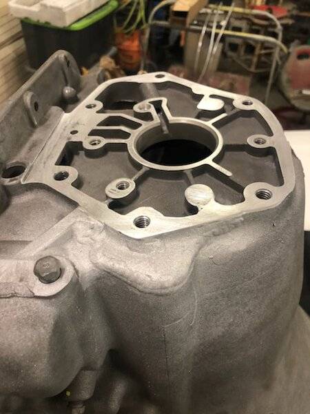

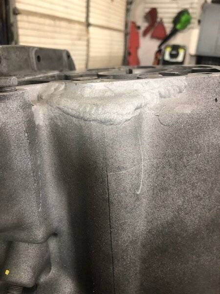

Had time yesterday to run both the case and the extension housing to the welder. Good news was that he can/did repair the numbers matching case.

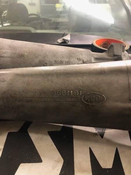

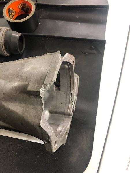

Bad news, the extension housing was beyond repair:
Good news, the trans I was saving to go into my challenger had the same extension housing and better yet, had the same part number. Bonus: Now has a penatstar

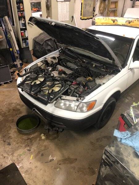

Waiting, still waiting!! All this time off left me time to do some yard work and to finally put a new radiator and rear struts in the
winter beater. Long time since using metric tools.

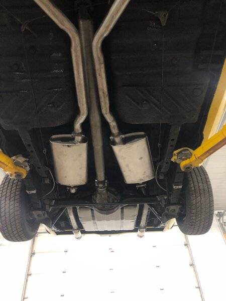

Found more time and the winter beater is done and will be leaving my garage to make room for the return of the Roadrunner. That is, after I replace the damaged exhaust system. Looks like only the left muffler was torn up. A replacement came yesterday so I will try and get to the shop Sunday or Monday if work doesn't call me in.

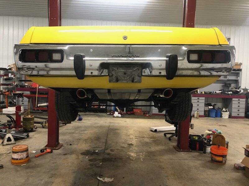

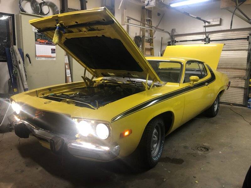

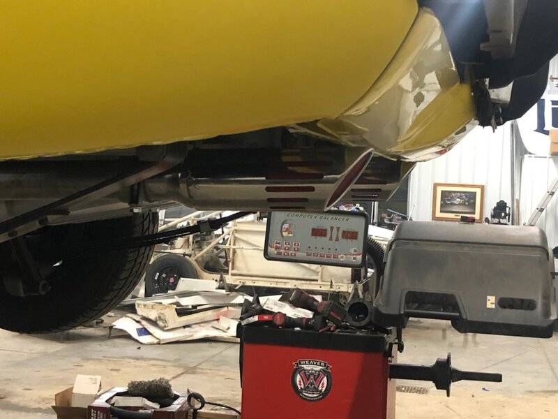

Exhaust is all back together again!!! :) Found the exact same muffler that was used in the original installation (no Hawk, not the cardboard one). Tips are finally on and clearing the valance just fine. Drove it back home and it is just a little rocket, just some minor tweaks needed but that will have to wait until after Thanksgiving. For now it is just good to have it back home, kinda missed her. Not sure how I am going to take it when she is sold. We have been together for around two years now and I know every inch of her, the good and the bad, and I like having her around.
Hey, carboard mufflers sound really racy very quickly!

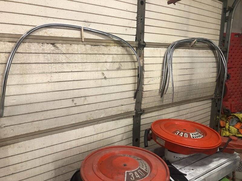

Dang, finding "one" wheel arch for the right front took a little longer than I thought but I now have it and I can proceed. I will fix mine a little later but right now I need this trim install done so I can keep moving forward. One more item off the short punch list.

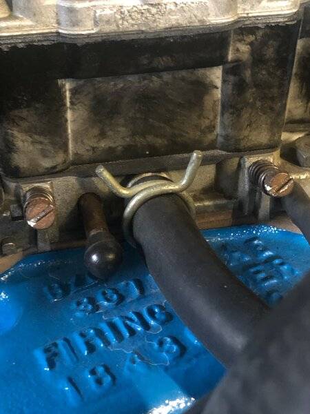

The wife and I were able to get in the garage and work on the car for a couple of hours today. First we set the thermoquad's idle mixture for each primary throat. I marked the screws with paint at 12:00 when fully screwed in. They were close but not exactly in the same position. Then opened them up 2 turns for a starting point. Engine was allowed to warm up and the choke to come off. We were shooting for 850 RPM in "N" per the manual. Adjusted the screws so many time in/out and side to side I lost count of the exact number of turns for final position. Sorry, but each carb will be a little different anyway. Ended up being happy with the tach bouncing right around 850. I am still checking on if that is the correct Corbin hose clamp or if it should be the flat style.
Next up was tuning of the timing. Using the wife's steady foot as a throttle lock, we ran it up to 3000 RPM with the vacuum advance off and plugged. Set the timing at 36 degrees BTDC. This setting, with the advance re-connected, resulted in a reading of 20 degrees BTDC at idle speed of 850 RPM. Those numbers are just fine with me. I have to wait for this last snowfall to melt off before I can road test these settings.
One small PS

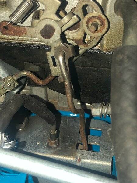

I did have to adjust the electric choke rod to make the choke completely come off and allow the secondaries to open. Before the adjustment (bending the rod to make it shorter) the secondaries opening was hit or miss. Now it is spot on and stays that way once warmed up. Always learning.

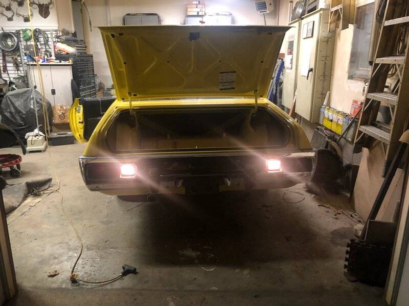

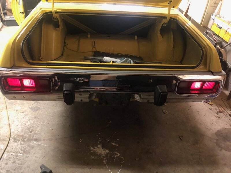

Just finished putting in the marker lights and adjusting the headlights. Everything works like it should. Pretty stoked about that since working on the rear lights is a PITA! I know I had them working while loose in the trunk, but working on the car can often be hit or miss. Two more items off the punch list. :) :)

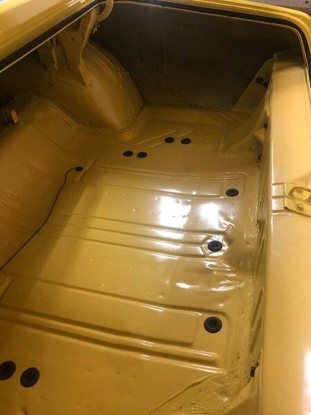

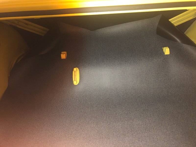

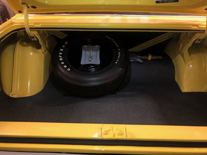

Got the trunk all cleaned up so the mat could go in. I know the mat wasn't super expensive (less than $50) but one would think it would fit better than this. The right cutout is about 3/4" short of where it should be. I will trim it off the left side as the spare tire covers that. I am sure the factory did not get inside and trim every mat. As with everything on these cars, a 10 minute job takes 3 times longer than expected. But; one more item of the punch list. Sorry, just had to vent a little. :(

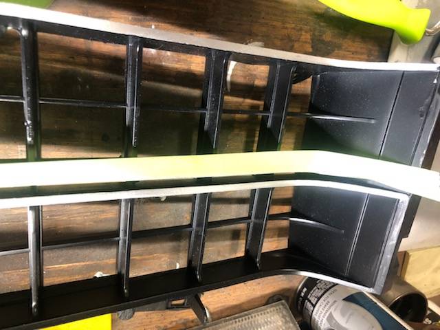

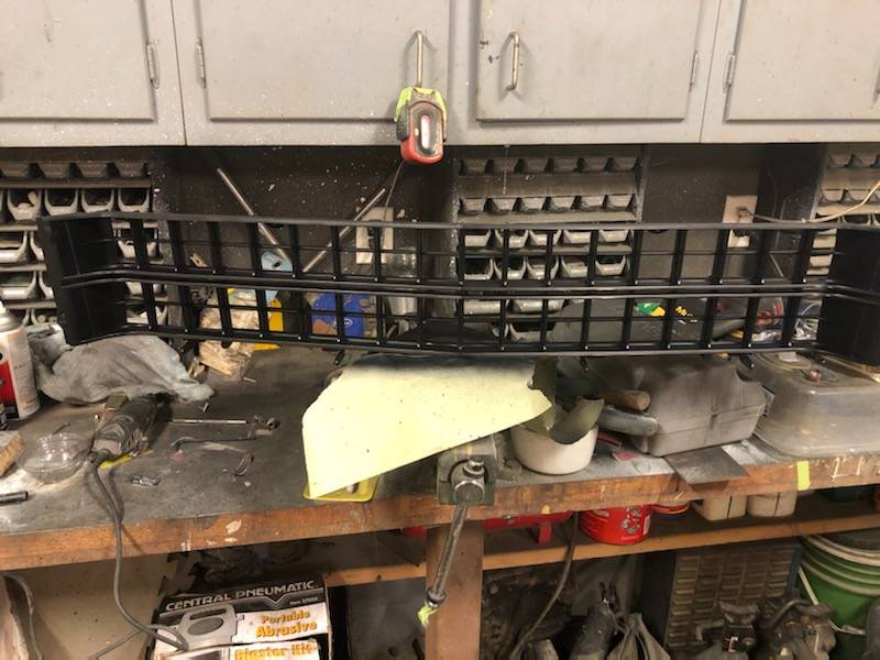

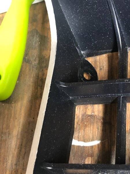

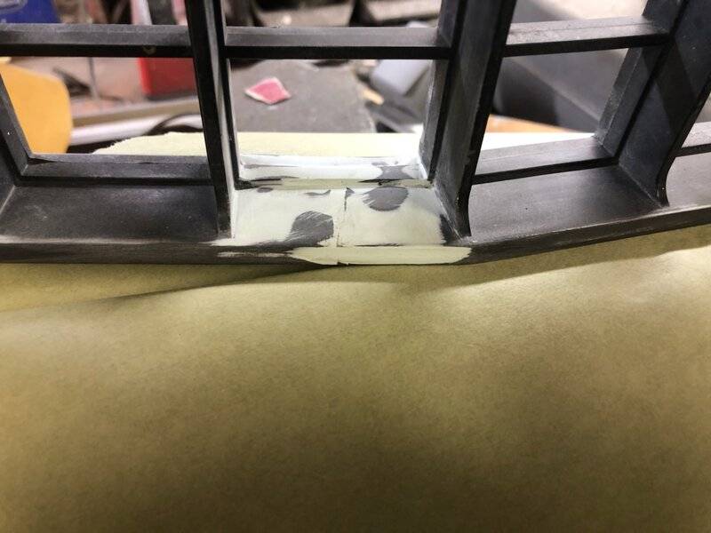

The grill that was in the car had some minor damage that needed to be fixed. Most of it could be repaired by heating the plastic, putting in the correct position, and then letting it cool to take a new set. Only one spot needed some extra attention. It was cracked, missing a piece, and in an area that you see right away. Melted it back together, added a little glue, then added some glaze, and finished with primer and paint. Still need to do the silver/grey highlights after the paint dries, but I have a plan for that.

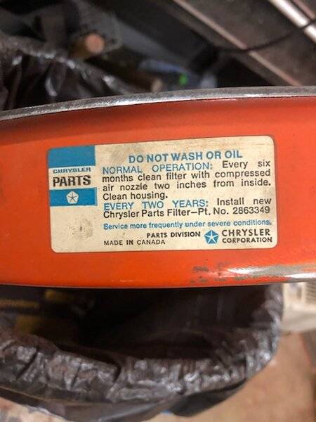

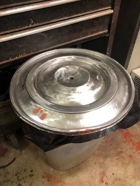

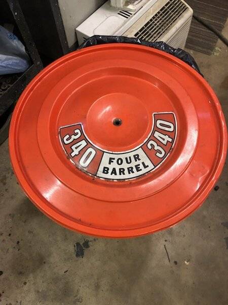

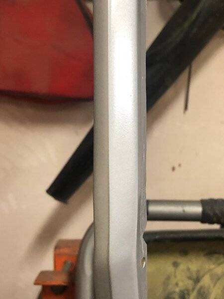

As I wait for the grill to dry, decided to start on the air cleaner. Somewhere in it's life, the air cleaner was repainted (wrong color, too dark) and had the snot knocked out of it. Who does this to an air cleaner? It also has minor surface rust issues to address.
Taking it down to bare metal since I have to beat and bang on it.
I can find this info decal, but finding one with the "Made in Canada" part is eluding me so far.
You spend enough time on the innerweb and you can find almost anything. Just had to change the search wording a little. This was from Performance Car Graphics. So it be available so it be sent to me.

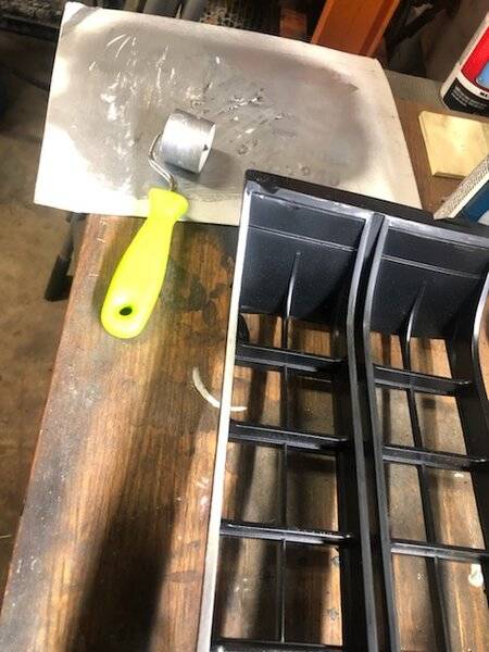

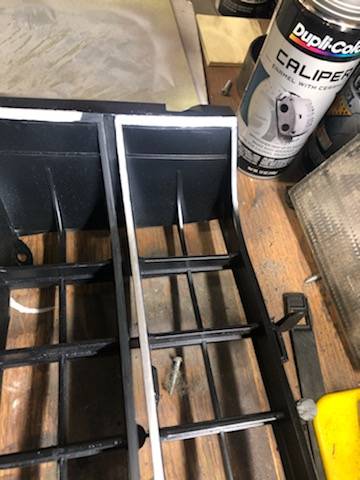

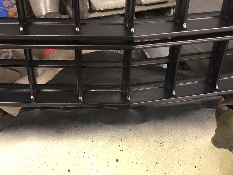

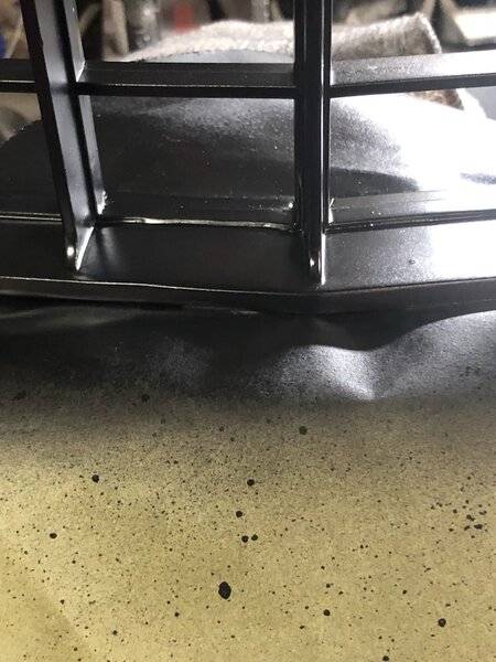

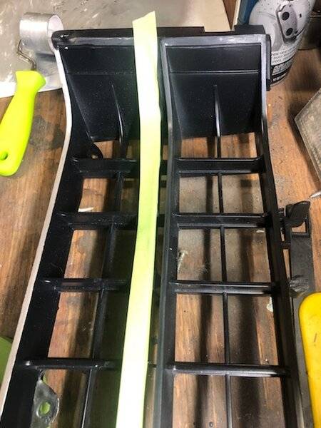

My plan for the grille highlights was pretty simple. Use a small hard roller (wallpaper seam roller) to transfer the paint evenly. This way I would not have to mask off the entire grille. The only area I would have to tape was the section where two of the sections were really close, and then I only had to mask to prevent rubbing the other surface. Worked pretty well and saved a lot of time.
Close up photos really show the dust :(
I only had to do a few inches with a small brush. It is not perfect, but the grille was not perfect from the factory.
I sprayed the metal trim piece and that turned out great, but the pics might not show it so well. I will put it all together tomorrow unless work calls. Just hope I can find all the screws and spacers.
