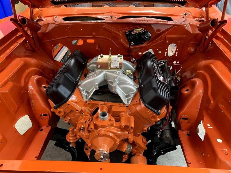

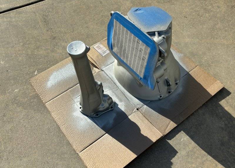

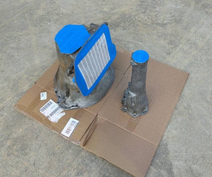

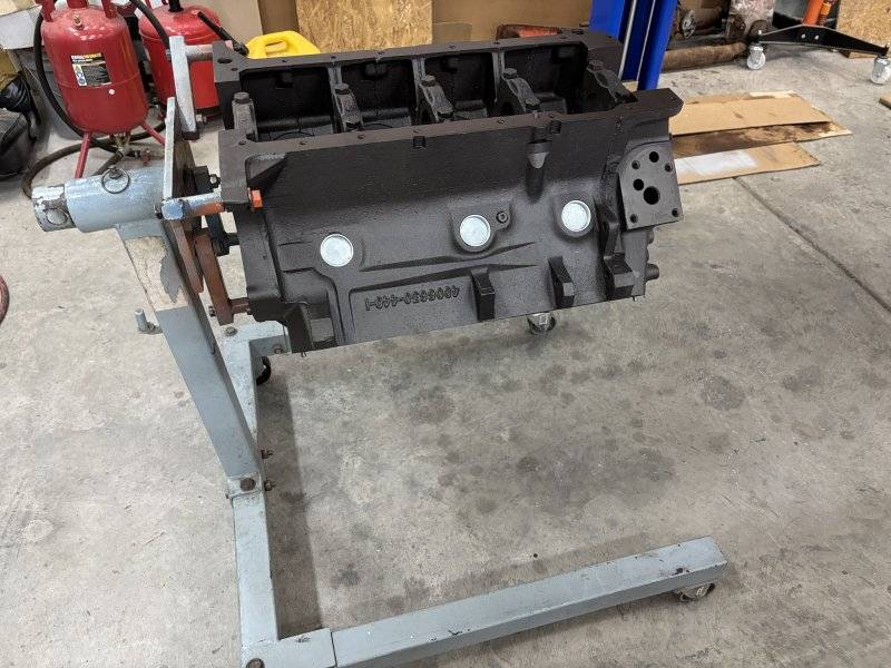

Thanks man. I have the one for my hemi 66 and I want it to look really nice outside. Just seeing what everyone else is doing.

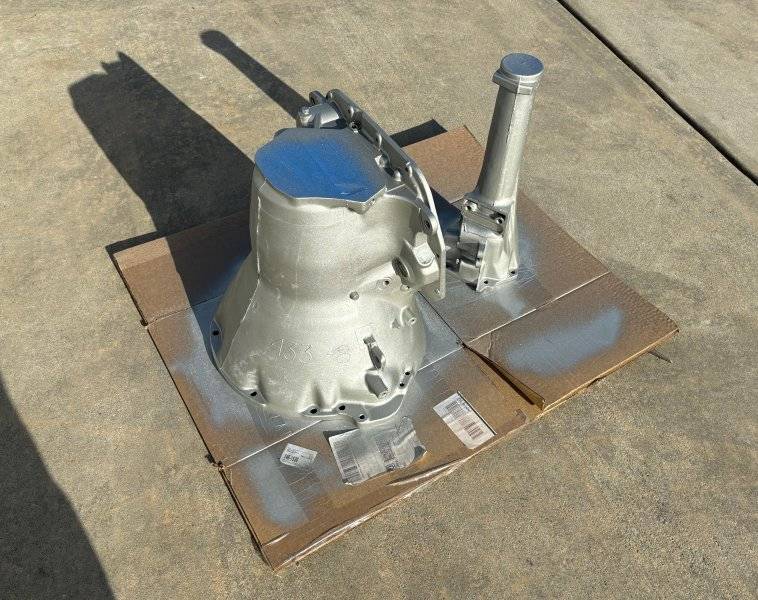

When its thoroughly dry I will mask it and spray it with Eastwood Aluma Blast. Stuff works great. This intake is done with it.

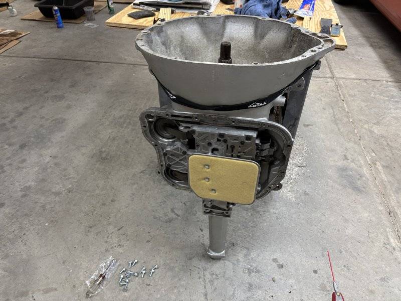

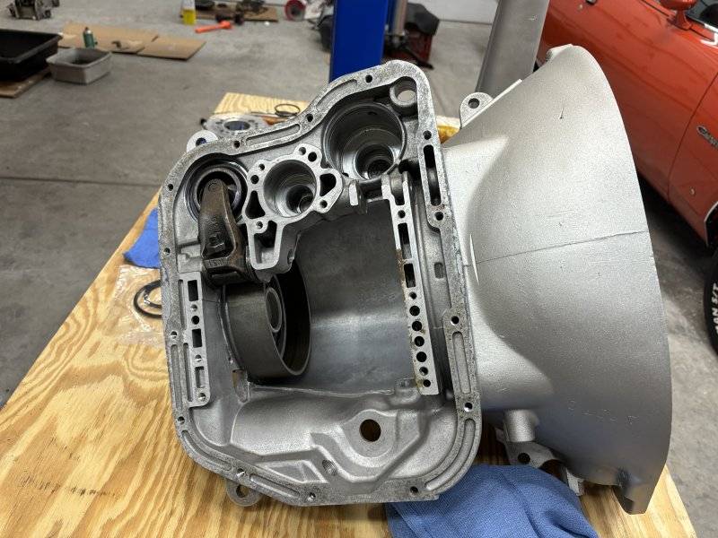

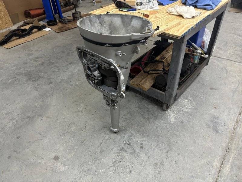

Got the case masked off and painted after work today.

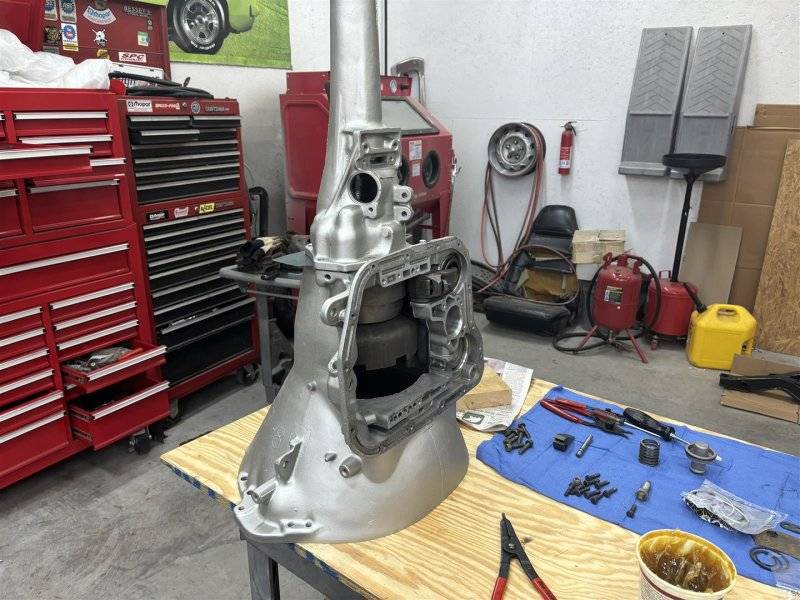

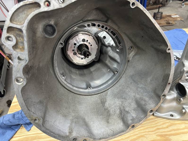

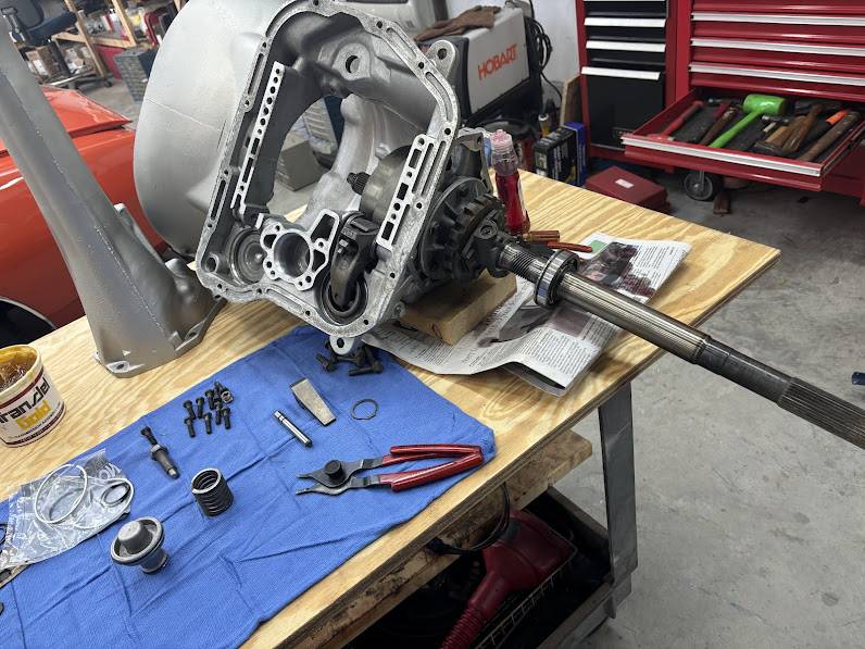

After what seemed like hours cleaning parts assembly has begun.
Much like an engine, parts need to be super clean, even the rags are lint free Emergency room rags thanks to my ER nurse neighbor lady.

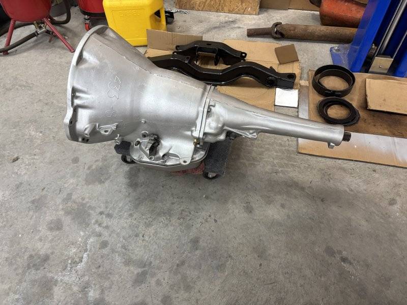

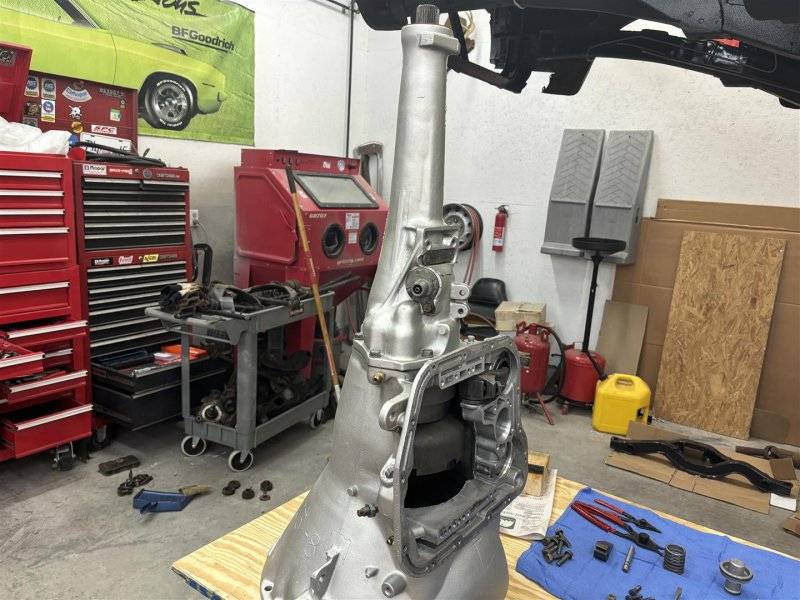

More progress today on the transmission. I will button it up tomorrow.

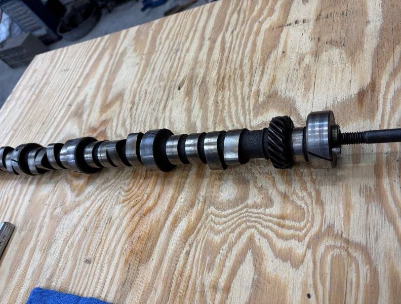

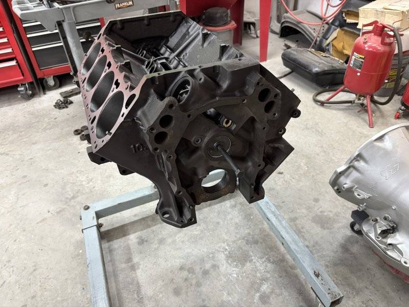

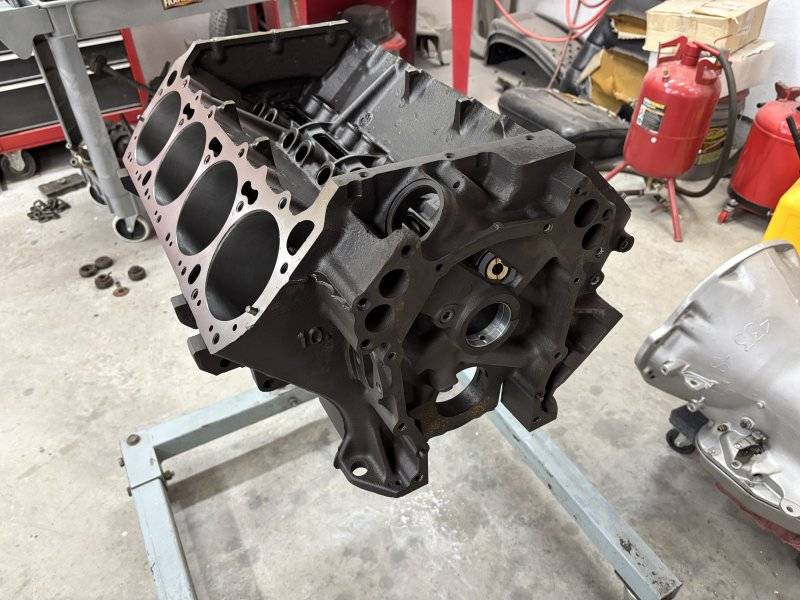

After having a hectic weekend last week I was able to get the transmission finished up and adjusted. Next up is the engine. Looking pretty after being bagged for some time. I fitted the cam before cleaning to ensure it was not tight. I have run into this before and have a old cam with groves in the journals, pack them with grease, spin a couple times and it will clean up any imperfections.
