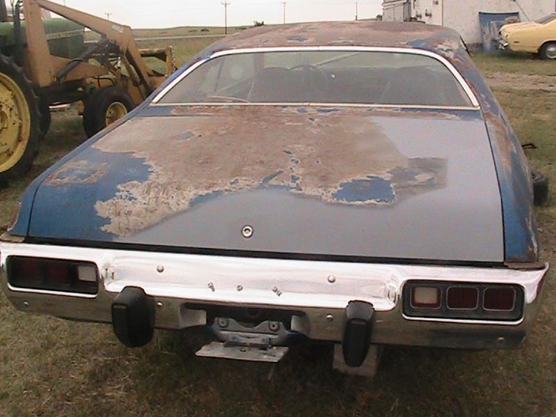

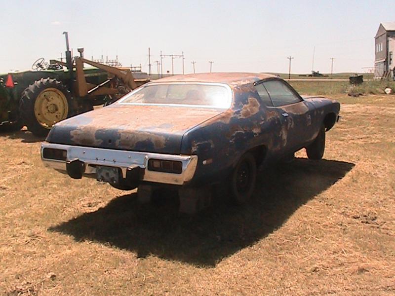

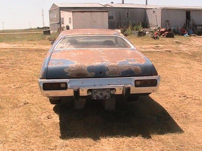

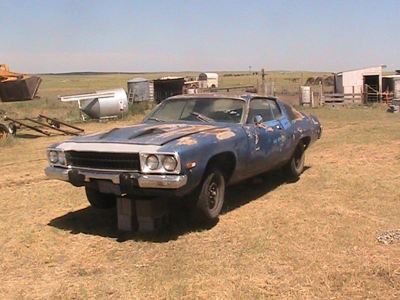

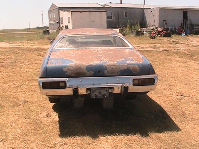

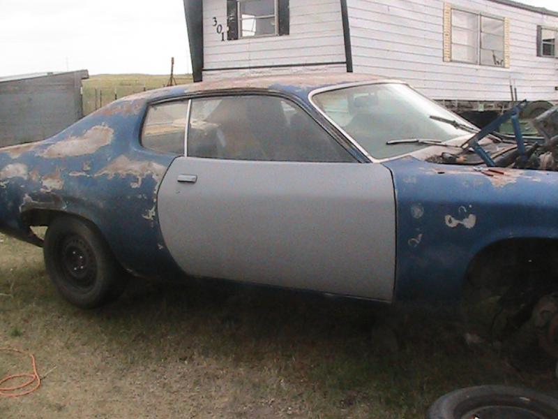

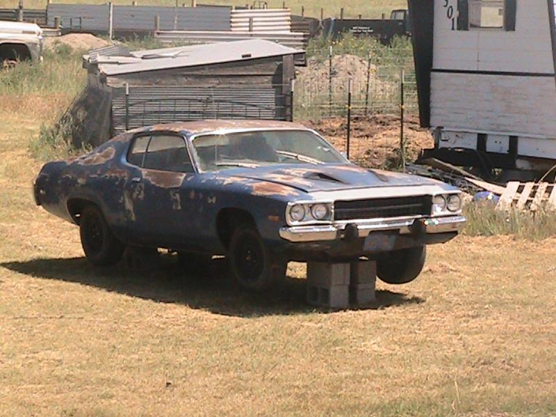

Greetings everyone.
I got my 74 Road Runner last weekend (Thought it was a satellite when I found it sitting on a guys Lot, in front of his house, Got a hold of him and asked him about it, Some guys bought a Van from him about 3 yrs ago and came back a couple weeks later and dropped off this car, no explanation or anything, just dropped it off at his place, so I asked if he was willing to sell it. He said yes and we agreed on a 500 dollar price, with one catch, It had NO title. So we figured out what was needed to get a title on it, paid another 410 bucks for that paperwork to be done, through a Tow Truck Company, and then waited the 3 Months required to get an abandoned vehicle title on it, found out later after I paid him, that it's a Road Runner and not a Satellite).
I want to do a Partial Restore on it I guess. Fender Tag says Dark Silver with Red Stripes, 318 Car, with Light Duty Auto Transmission and I am more fond of the Lime Green Paint with Black Stripes. I'll have lots of Questions on this considering I am a newbie at "Restoring" a car but not at Working on them or Body Work.
My First couple of questions are--- Numbers Matching?? What exactly does that mean? The Care is Pretty much all there. The Engine and Tranny are there, everything really, some of it in the back seat of course LOL. The Engine I want to Replace with a 318 out of my 88 Ramcharger that I have (It's Throttle Body though, and RR has 2 Barrel in it), does this affect the Number's Matching thing?? What Numbers have to match?? and do you think this would be possible, the engine Swap that is, to get it running and driving (Later on I plan to rebuild the motor that's currently In it)
In relation to the Above Question, I have a 89 Dodge D350 with the 727 In it that I was planning on using as a Donor Transmission (again I plan to the have the Original rebuilt later on too), will that work??
Next Question, Build Sheet?? How can I get one on this Car? Is it true that some cars had the Build SHeets under the carpet or something?? Fender Tag says Vinyl Luxury Bucket Seats, Black and White. The ones in there are Blue Vinyl with a faded Blue Cloth on them.
A cheap source for replacement Decals and Nameplates would be helpful too. The only Road Runner Nameplate still on the car is the one on the Passenger side Dash Board.

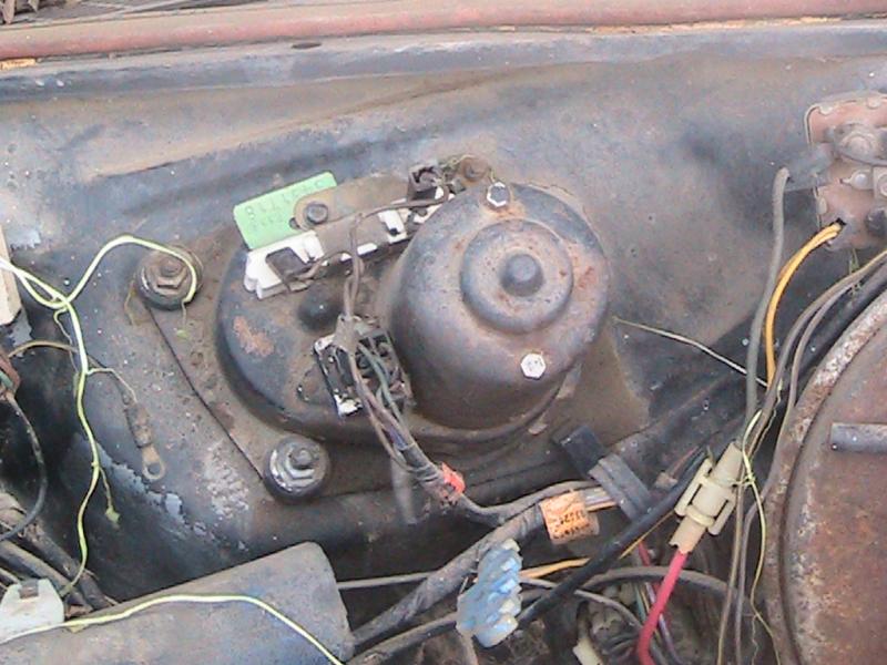

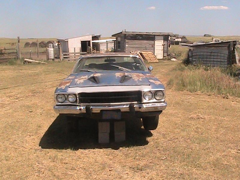

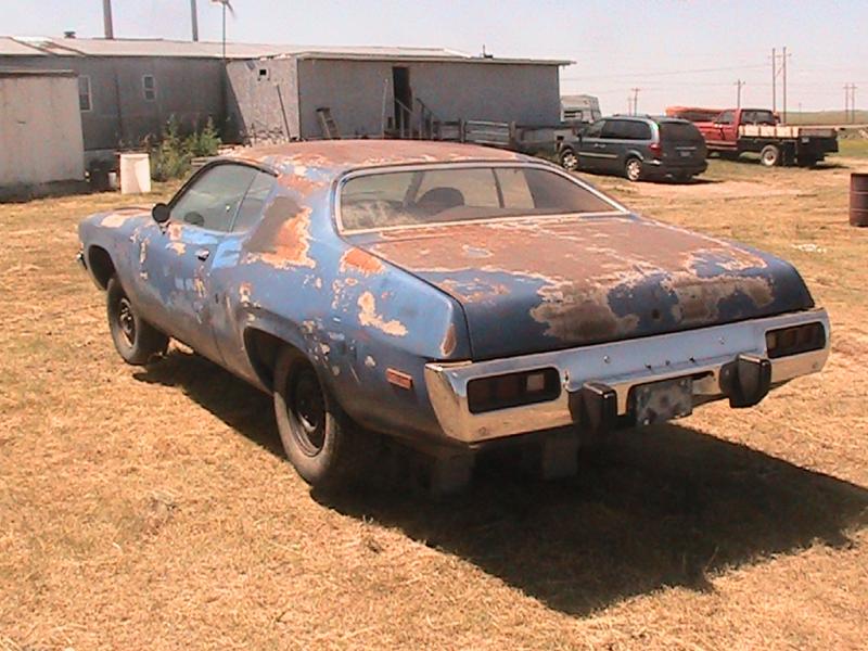

Thanks in advance to all of you B Body Veterans that can help me out on this. Here are some pics to tide you over.

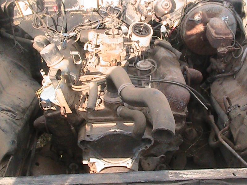

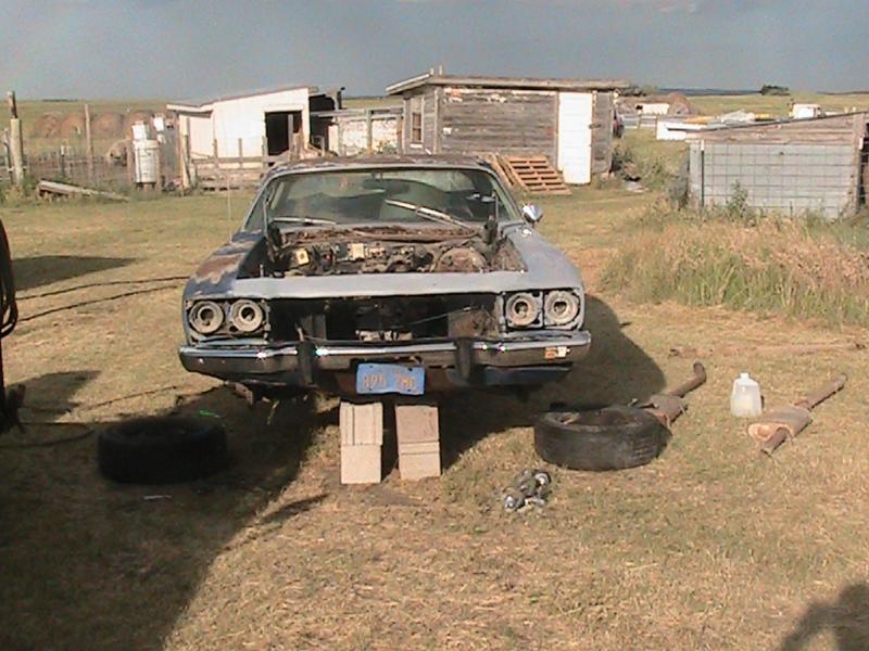

Gonna Try and get all the Transmission Linkages Disconnected today and the Motor Mount bolts out, everything else is disconnected, and will hopefully get the old motor and tranny pulled out today with the Tractor. Will be slow going on this at first because I am still recovering from a Disk Fusion Surgery on my back from about a month and a half ago. Doc says 6 months total on recovery time and bending is still a bit difficult.
Yes, that's a California Plate on it. LOL.

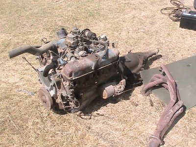

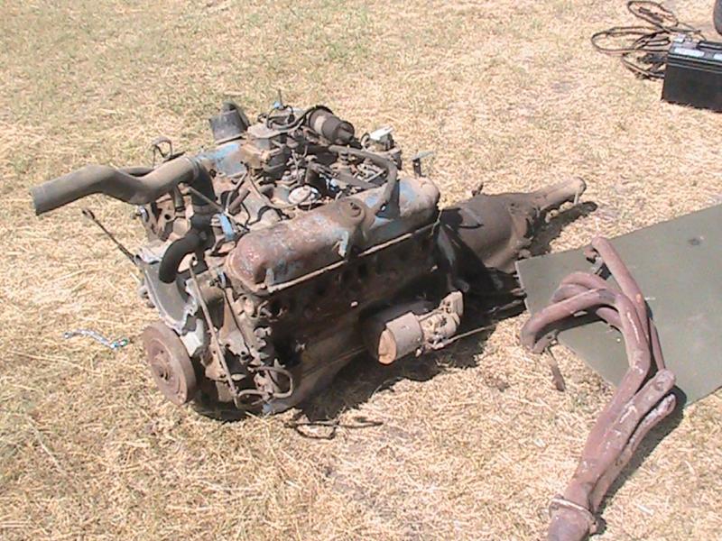

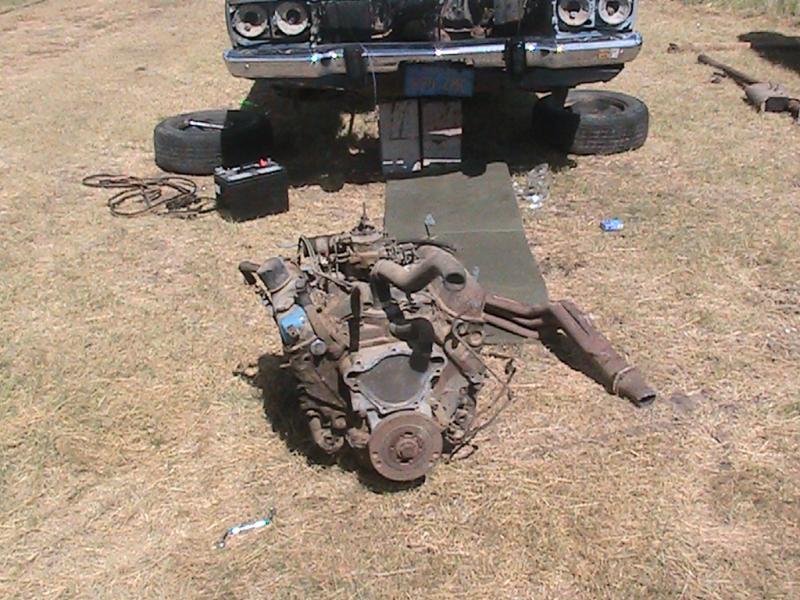

Got the Motor and Tranny Pulled today, thank Gawd for Tractors LOL.

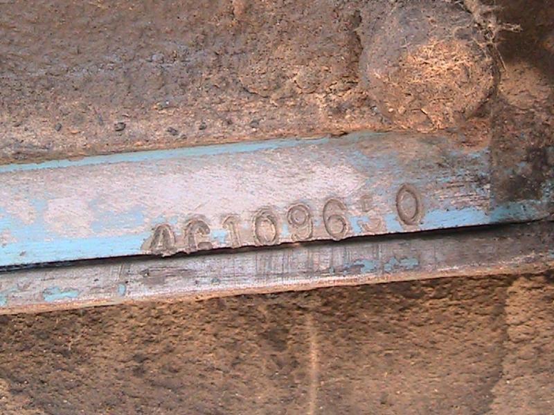

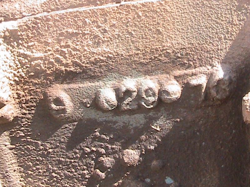

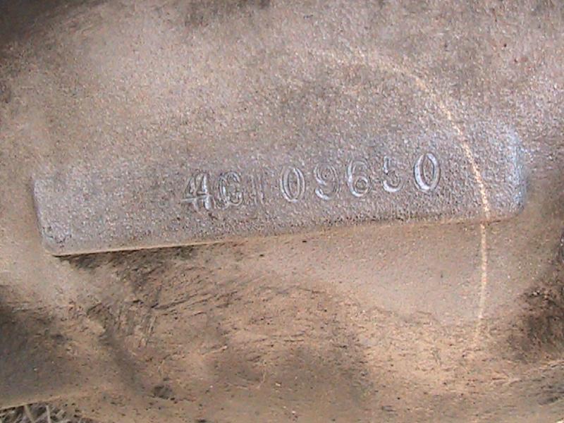

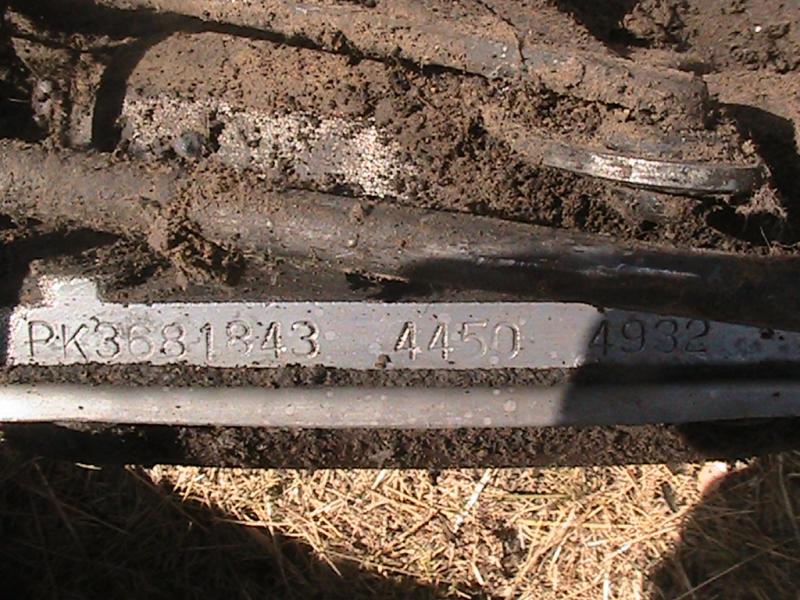

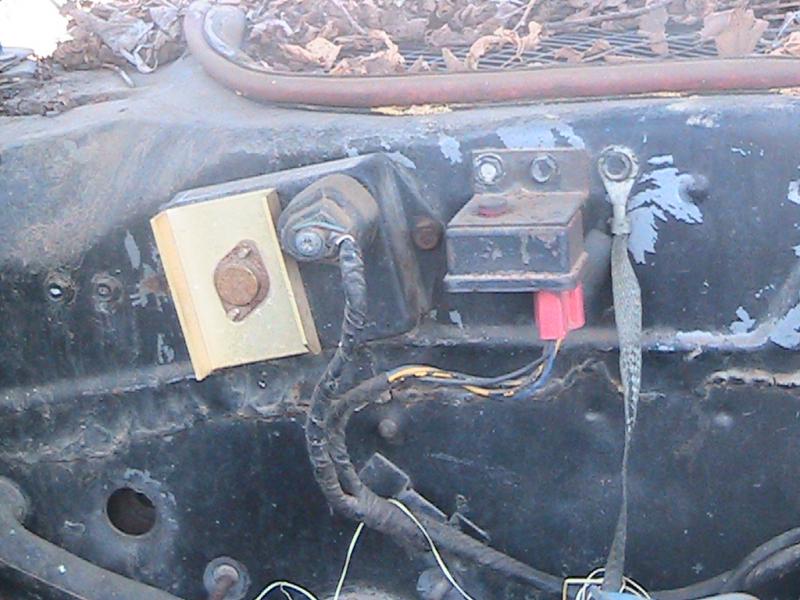

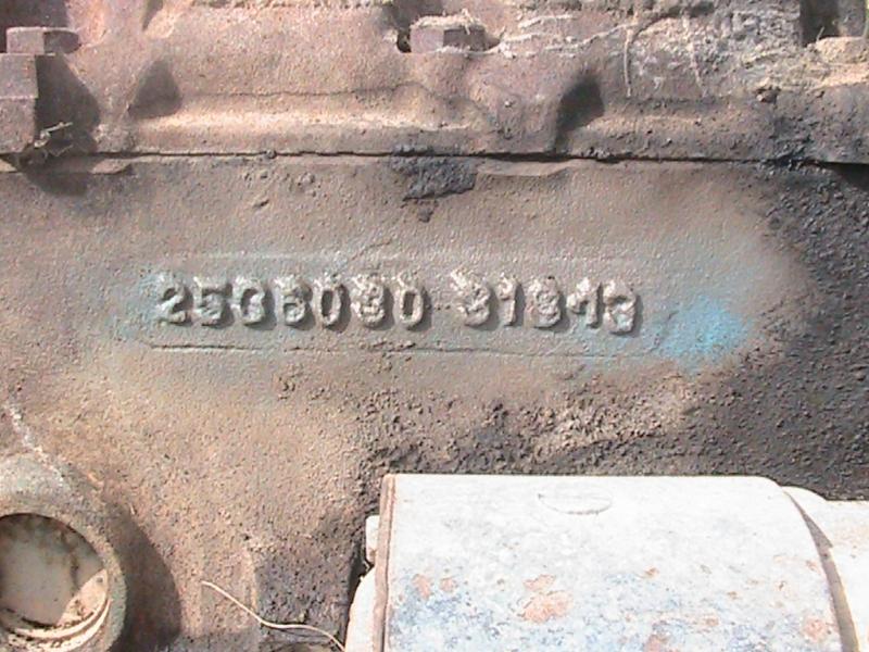

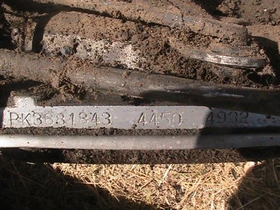

Found This Number on the Drivers Side of the Engine Block but can't make out some of the Numbers, the passenger side of the block says 9-29-73 on it. Found these Numbers on the Drivers side of the transmission just above where the pan attach's - PK3681843 4450 4932 I can't find anything on the net about the Drivers Side Numbers on the Tranny. IMG_1741.jpgIMG_1742.jpgIMG_1745.jpg
Drivers Side of Transmission.
Number on the Passenger side of the Transmission, the 109650 Matches my Vin Number
Number on the Passenger Side of the Block also Matches my Vin Number
I am assuming this is a Date Code of 9-29-73

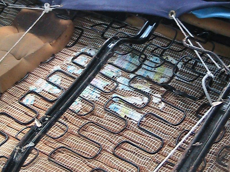

anyway, found what was left of the build sheet under the back seat. Highly Doubt I can piece it back together, it's in about 200 small pieces. UGHIMG_1751.jpg
To answer your first question at the very top: Yes, you have a numbers matching car. This is a very desirable quality. I would personally keep it silver with the red stripes. it's okay to put another engine in, but don't sell or scrap the original, (even if its unbuildable).
Before you try and extract the build sheet, see if you can get any high quality photos of it as is. (that's one of the nicest undersides of a seat i've ever seen, btw)

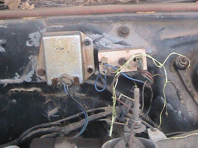

I ordered New Ignition Key lock, Door Key Lock and Trunk Key lock for it today. also ordered new Ballast Resistor, Starter Relay, Voltage Regulator, Carb rebuild Kit (gonna take the carb off the Original and put it on the TBI engine from the Ramcharger), Fuel Pump, Ignition Control Module, Ignition Coil, Distributor Pickup Coil (gonna swap that out on the TBI Engine too), and distributor rotor. I have a Cap for it and plugs and wires already. Just gotta figure out what all needs to be done to drop a TBI engine in there and go back to Carb on it. LOL.

As to your numbers matching question, the good news is your car is numbers matching, the bad news it doesn't mean anything. Having the original engine and trans is a big deal with high-end valuable cars, but not so much with 318 cars that were a dime a dozen. Even worse, the 73-74 cars are my favorite but that's a sentiment that isn't widely shared in the collector community, so keeping a 318 74 car original is pretty pointless. My suggestion is to do your car the way you like and don't worry about what anyone else thinks.

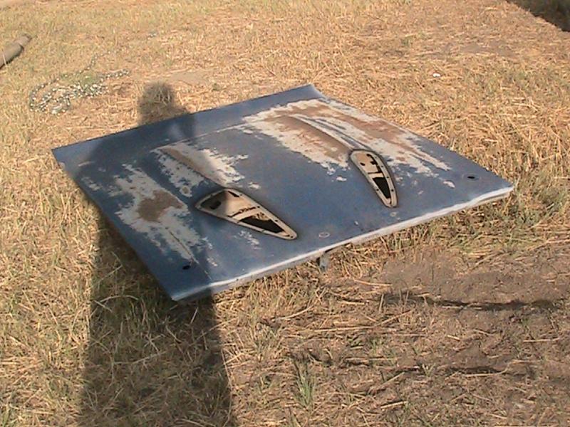

Been slow Going on this, too much other stuff to work on right now. Got the passenger door down to Bare Metal and Primered, and started working on the trunk lid too.
