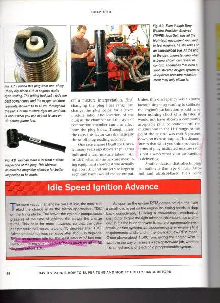

Post #19, Black Sheep.
With the utmost respect to you, this is where ignorance sets in. My car, when it was idling on the showroom floor, idled with 26* of idle timing.
It had a cam that had 25* less duration than the XE 268cam....
See below about idle timing. It changes with cam duration.
Just to add.....
I just finalised carb tuning today on a 440. Sol roller cam, 10.5:1 Trick Flow heads, headers, M1 Single plane intake. 850 TQ carb. Best idle was with 44* BTDC.
