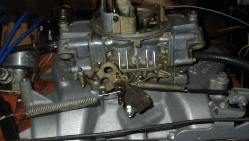

750 street demon on mopar big block not getting full throttle......

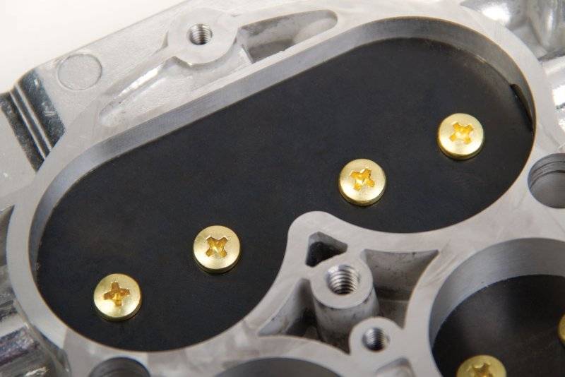

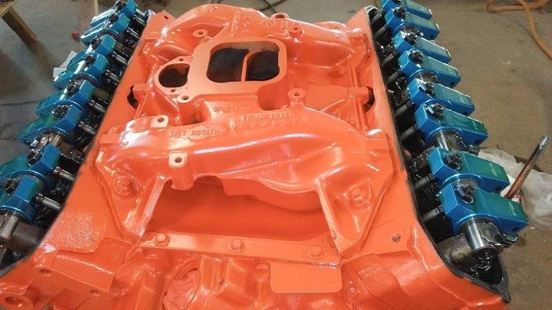

It's possible even with a spacer the toggle valve (third barrel) may catch on that intake which I guess you have a "69 301 383 with four holes. On my 440 I machined the intake to clear the google valve. I did not use a spacer on the 440 on my 70 Charger because I use the stock air cleaner. As it is the hood insulation just touches the pie tin.
Thank you. I do have an edelbrock rpm intake that has cleared in the past and I will eventually swap for, but so far the spacer has given it enough clearance.

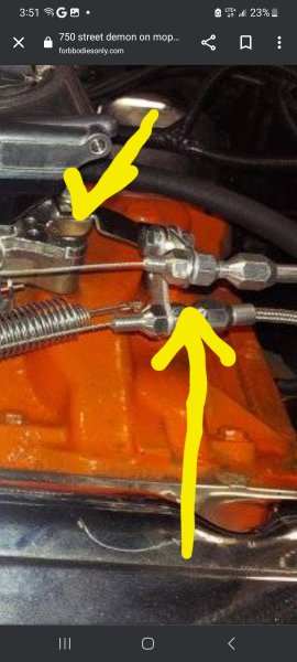

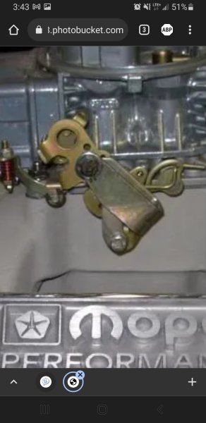

You should try to get the throttle cable mount lower.
Yep, ya' need to pull downward.
Sorry, late to the show!
Well, you were right. I got the throttle down and it worked. Wow, the average person wouldn't think that would matter. Thank you so much for taking the time to help!
You bet, it's a common problem with aftermarket cable brackets
