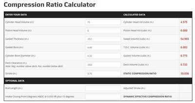

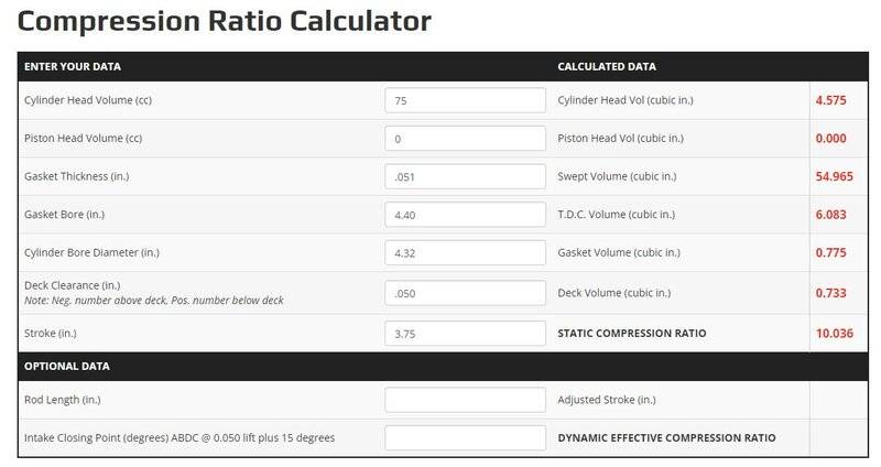

This calc was with a 440 source head gasket at .051.

There seem to be two different pistons that got into the 350hp 440 in 68. All three of the 350hp engine I have taken apart were .080-.090 down. But guys have also taken them apart to with the hp piston which are .045-.055 down. One economical option to lower the compression is 440 source .051 gasket. Since your piston are down the deck a ways...w no quench there is NO worries using a thicker gasket. Choosing the right cam can also help tremendously.
